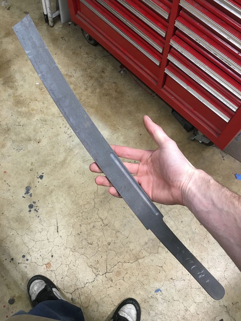

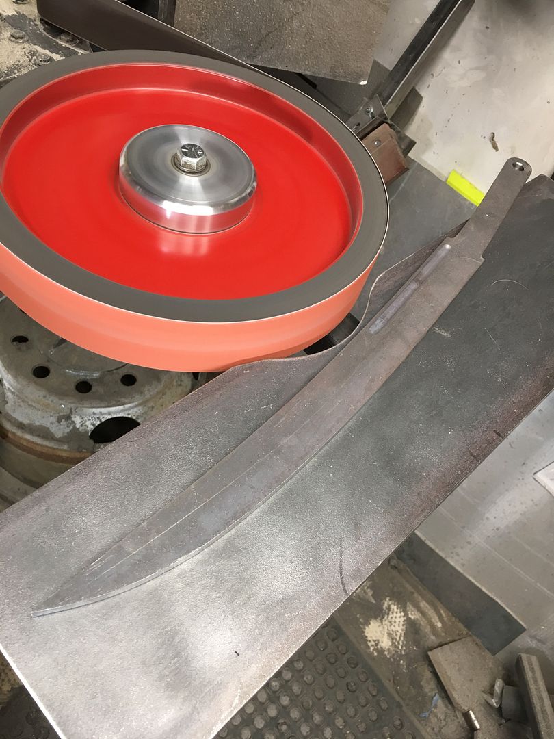

Hey guys, I am working on a cool wakizashi for a show in a few weeks (this one might even be coming to Blade with me) and I thought I would share a few pics.

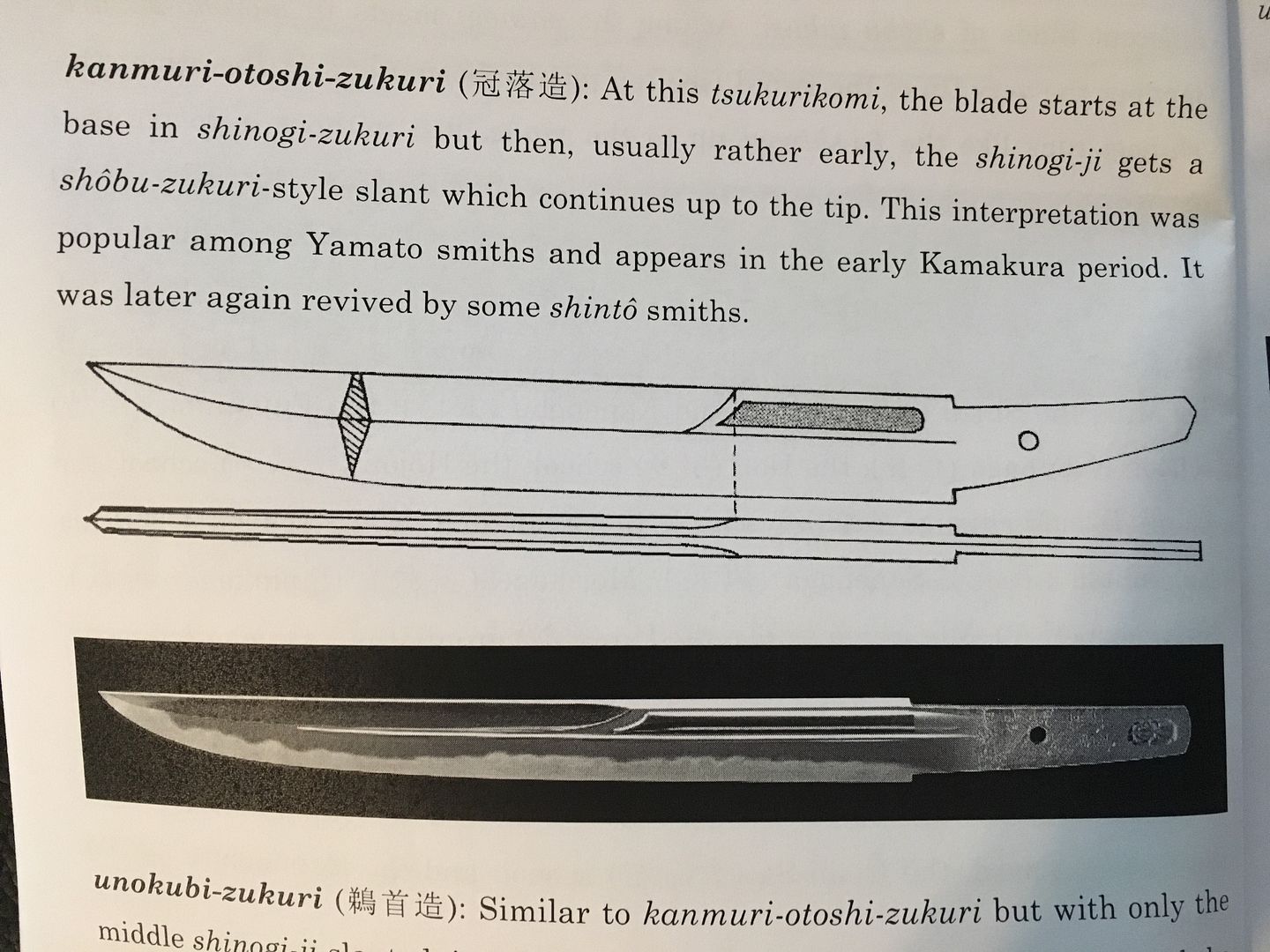

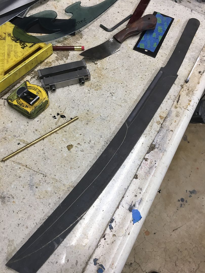

This one is in a Kanmuri-Otashi style grind. This was seen mostly, to my knowledge on shortened/converted Naginata.

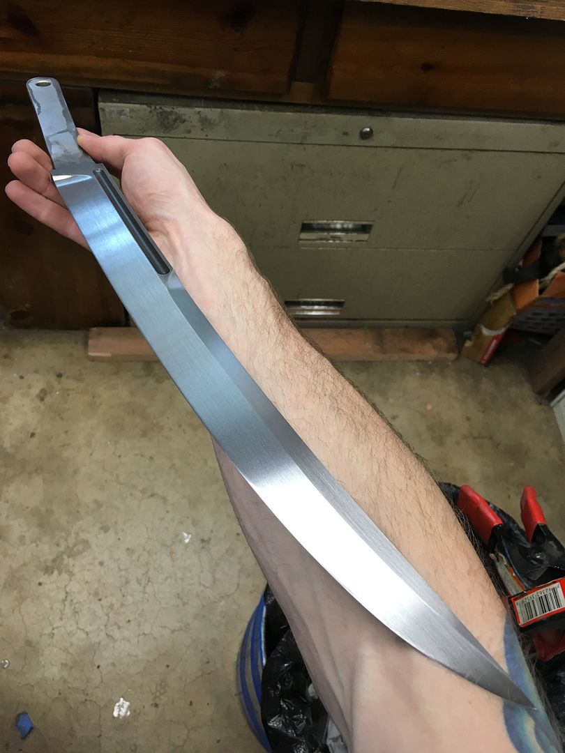

I gave this one a ton of sori. Blade length is around 16" and will be just over 23" oal.

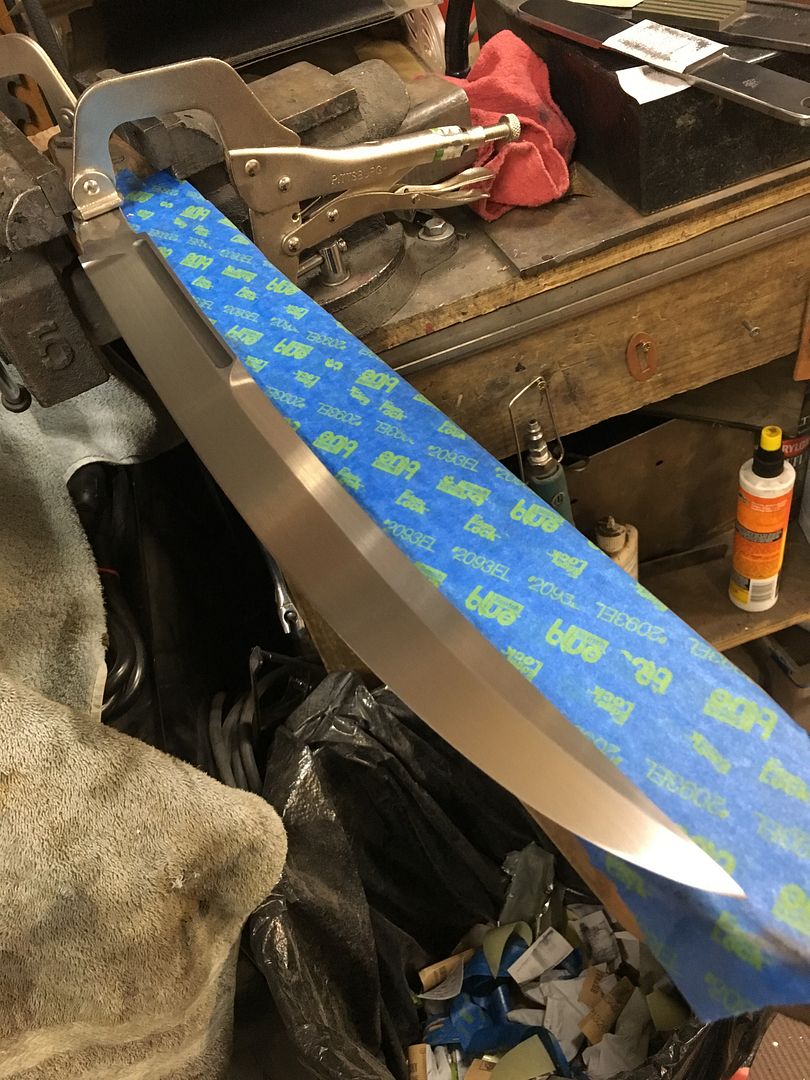

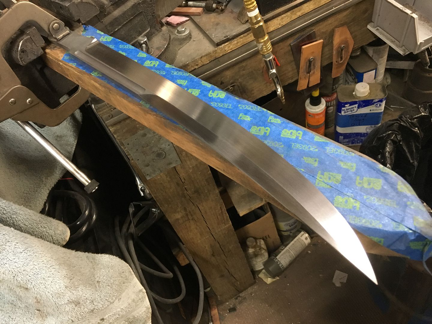

Pre HT hand sanding.

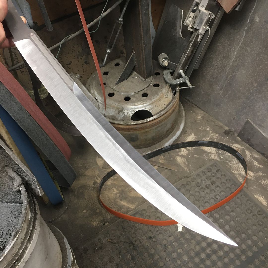

Here I am hand sanding, there was a lot of that on a blade this size in 3V.

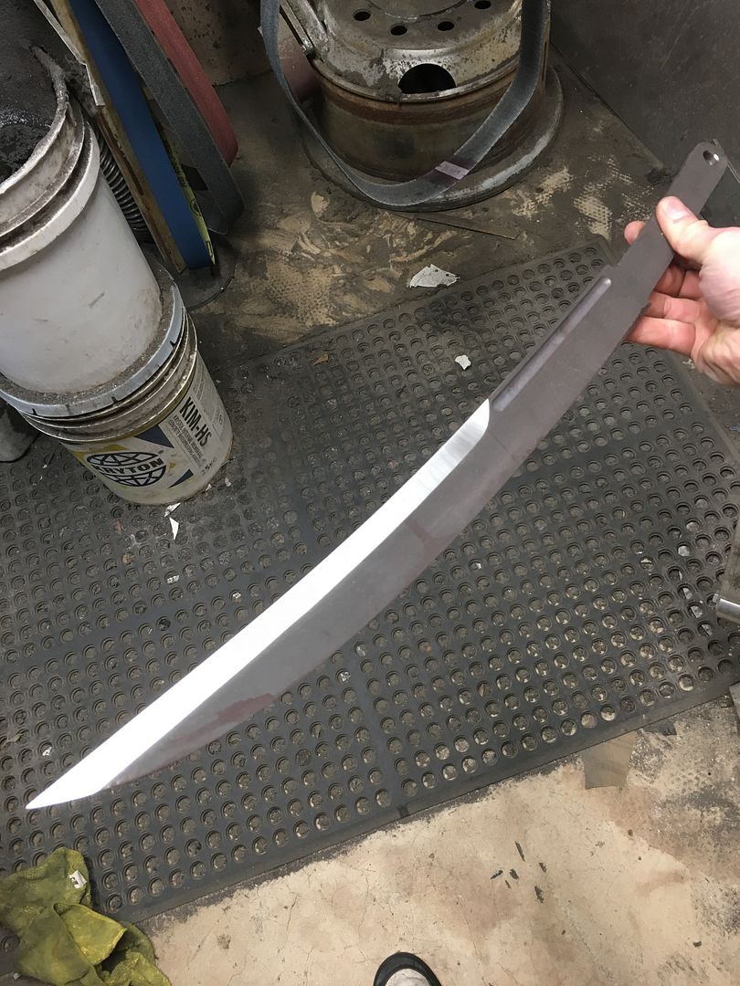

Finished blade.

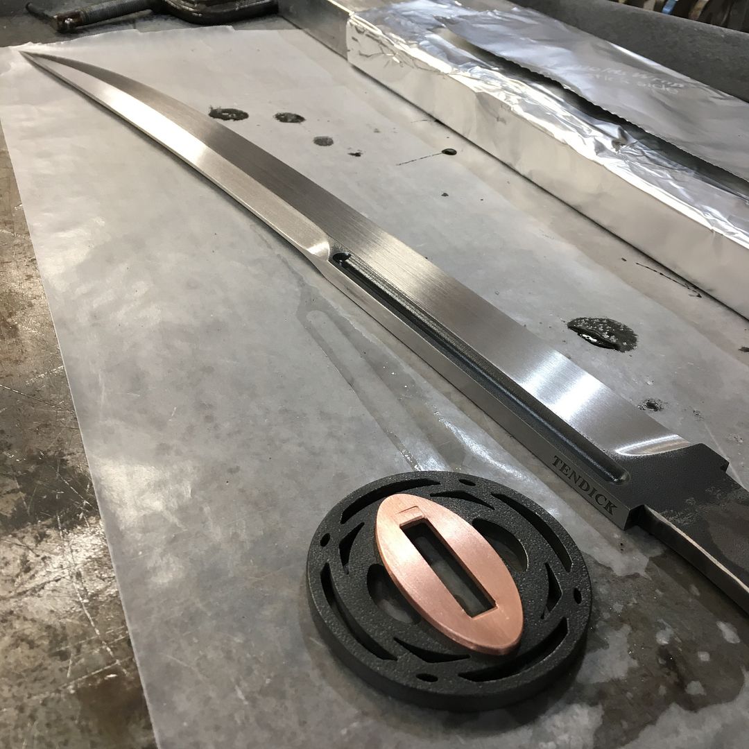

Parts ready to mount. I went with a zirc tsuba on this one.

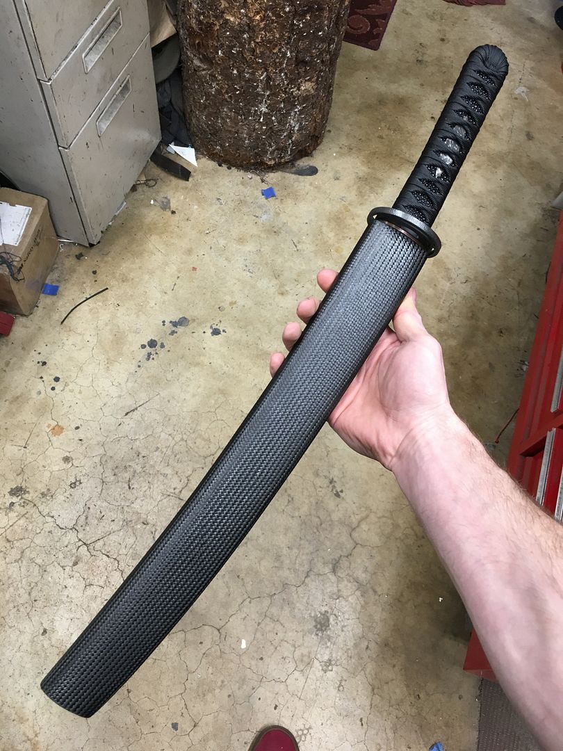

Before I finished mounting and wrapping the blade, I built the saya. This one is a tero tuf core that will be wrapped in carbon fiber.

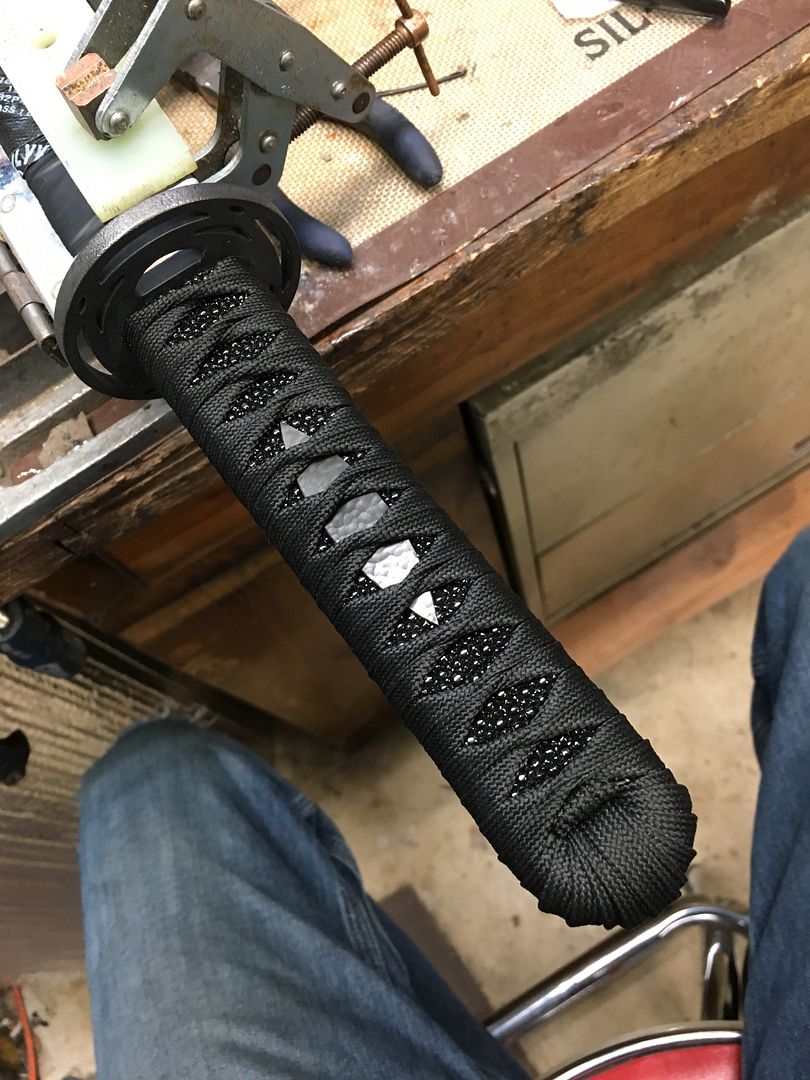

Back to handle. Finished wrap ready for epoxy. I used black stingray and Zirc menuki.
Here is the sheath all finished up. I like leaving a bit of the texture of the carbon fiber, which is reminiscent of an urushi finish for me.
