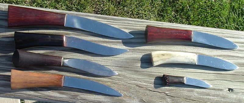

I posted this picture some time ago compairing different chakmas that come with the kukris, maybe it will help a little since they are about the same size as the kardas that came with the same kukris . The smallest came with a 15" kukri, the largest came with a 23". The largest had a 3 3/8" handle with a 4" blade, the smallest came with 2 1/4" handle and 2 3/8" blade. The the rest of the chakmas came from 16" - 18" kukris.
OK, since I have an 18" and 20" on the way, I guess I can expect one of the larger chakmaks.
Thanks for the pics.
