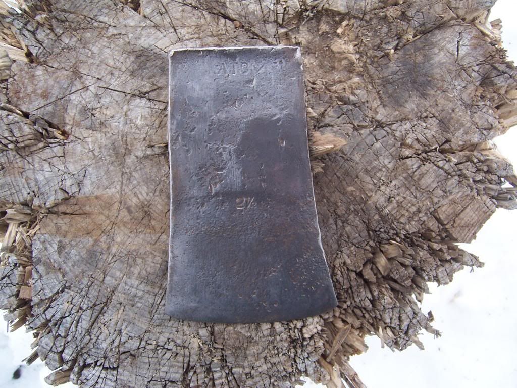

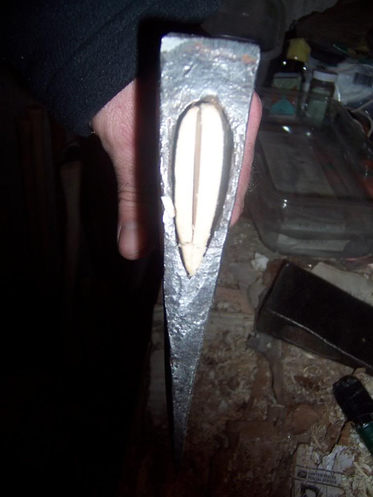

My local antique / tool store finally gave up the ghost this winter. The bonus was the owner did some more digging and found this little gem. I bought it from him for $2. It's marked KATCO and 2 1/2 on the face of the axe.

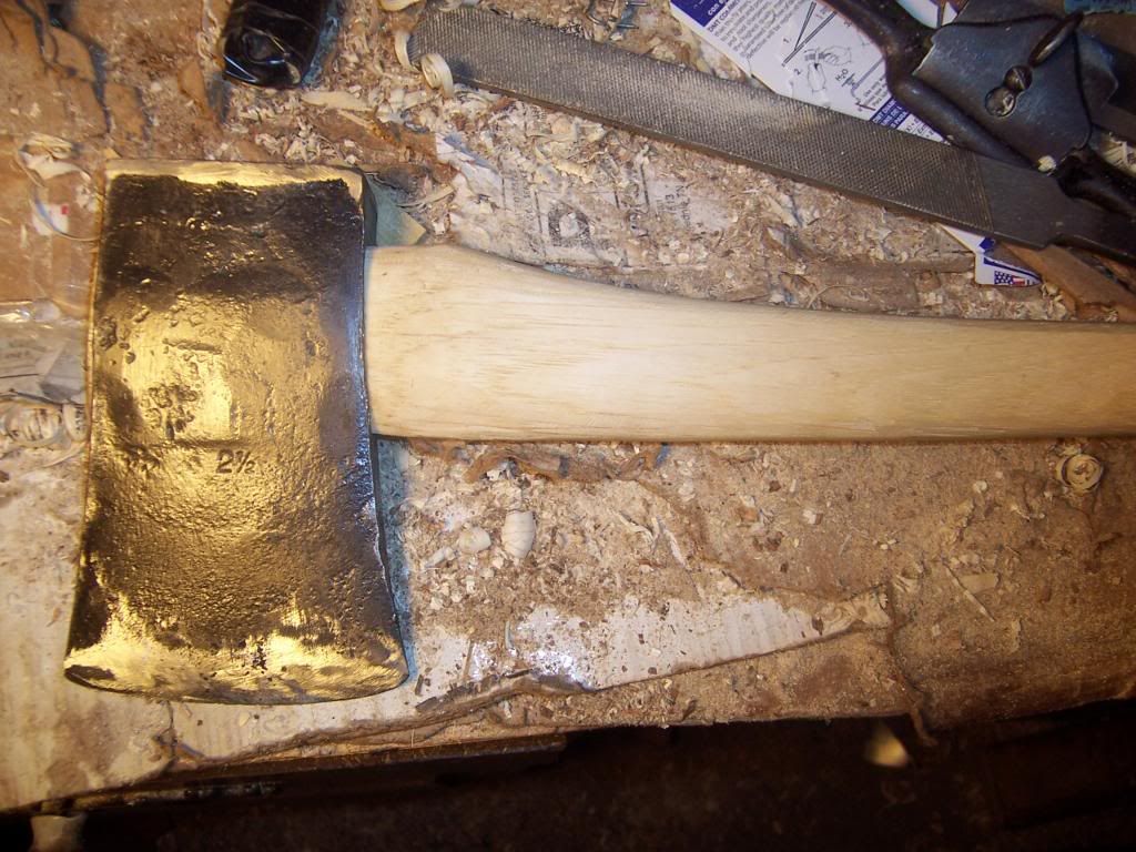

wire wheel cleaning.

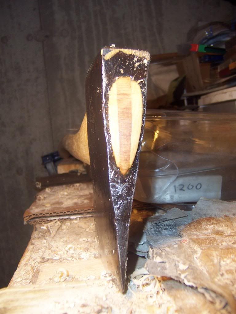

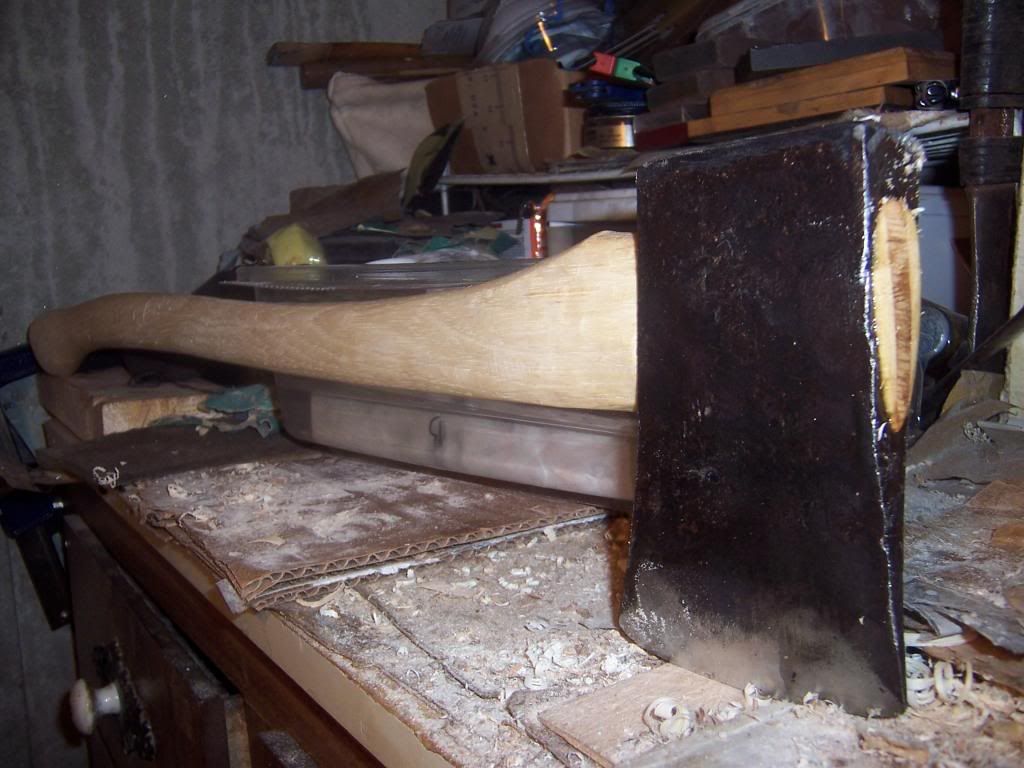

I used an O.P. Link boy's axe handle. I used my new (old) stanley spokeshave (51) on this to trim the eye part of the handle and the shoulder down. Worked really well. Lots of room for wedge and the bottom of the eye is tight to the handle. It has a really nice wedge profile :
wedged:
thanks for looking.

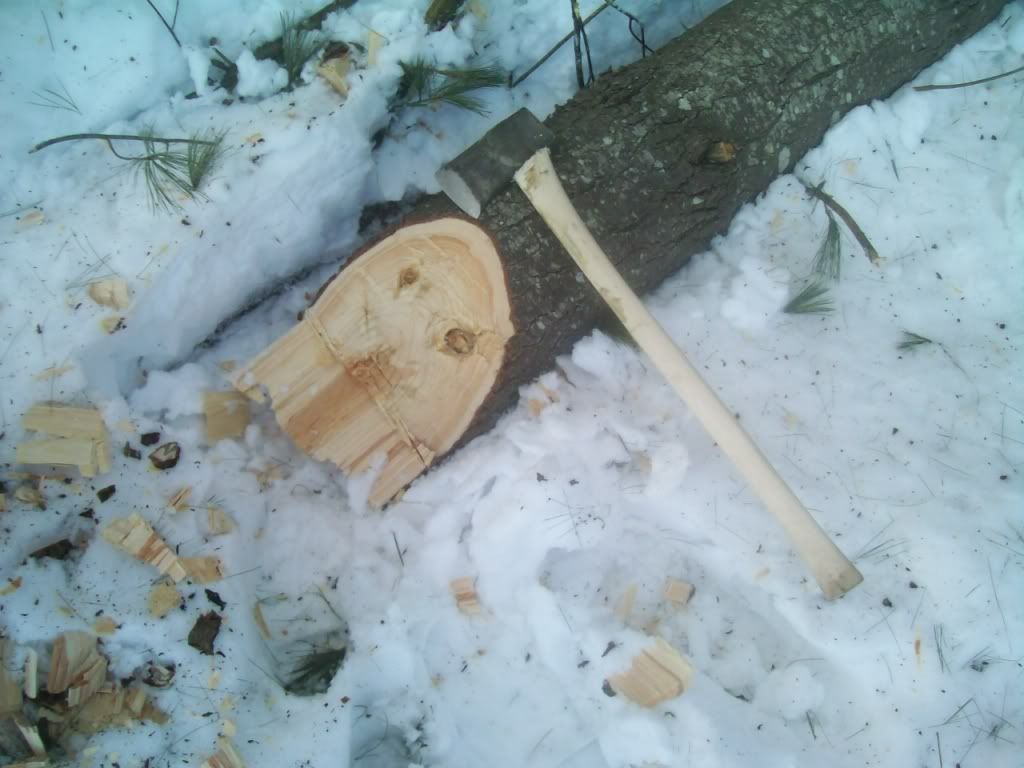

Thats a 2 1/2 pound Snow & Nealley with tree it dropped. thats a really capable weight, not a boys axe as much as an axe for a skilled man who isn't fool enough to swing more than necessary.
