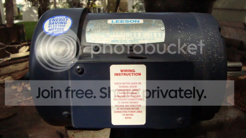

Got my motor today, I think/hope I got a good one.
Doesn't look bad for $50 to my eye, but I wont know if it works till I get my VFD and run power to it. Its kind of funny but there seems to be no way to identify the leads, every wire is the same color:confused:
It's been a while since I wired mine, but I believe you just follow the diagram for the 208 voltage. The wires have numbers like T1 and T2. I can't read the whole diagram in the pic so for example tie the T1 and T7 wires together and that goes to the #1 hot wire (L1). do the same for the the other two hots and then tie the other three wires together it looks like it's T4 and two others. Good luck.
I will have to pop off the cover and look into that when I get back home
So I popped off the cover and was trying as hard as I could to read the little writing even broke out the loupe to see if that would work. Then while trying to get better light I realized that all the litle dots were spelling out T1 T2 T3 and so on to T9:o
