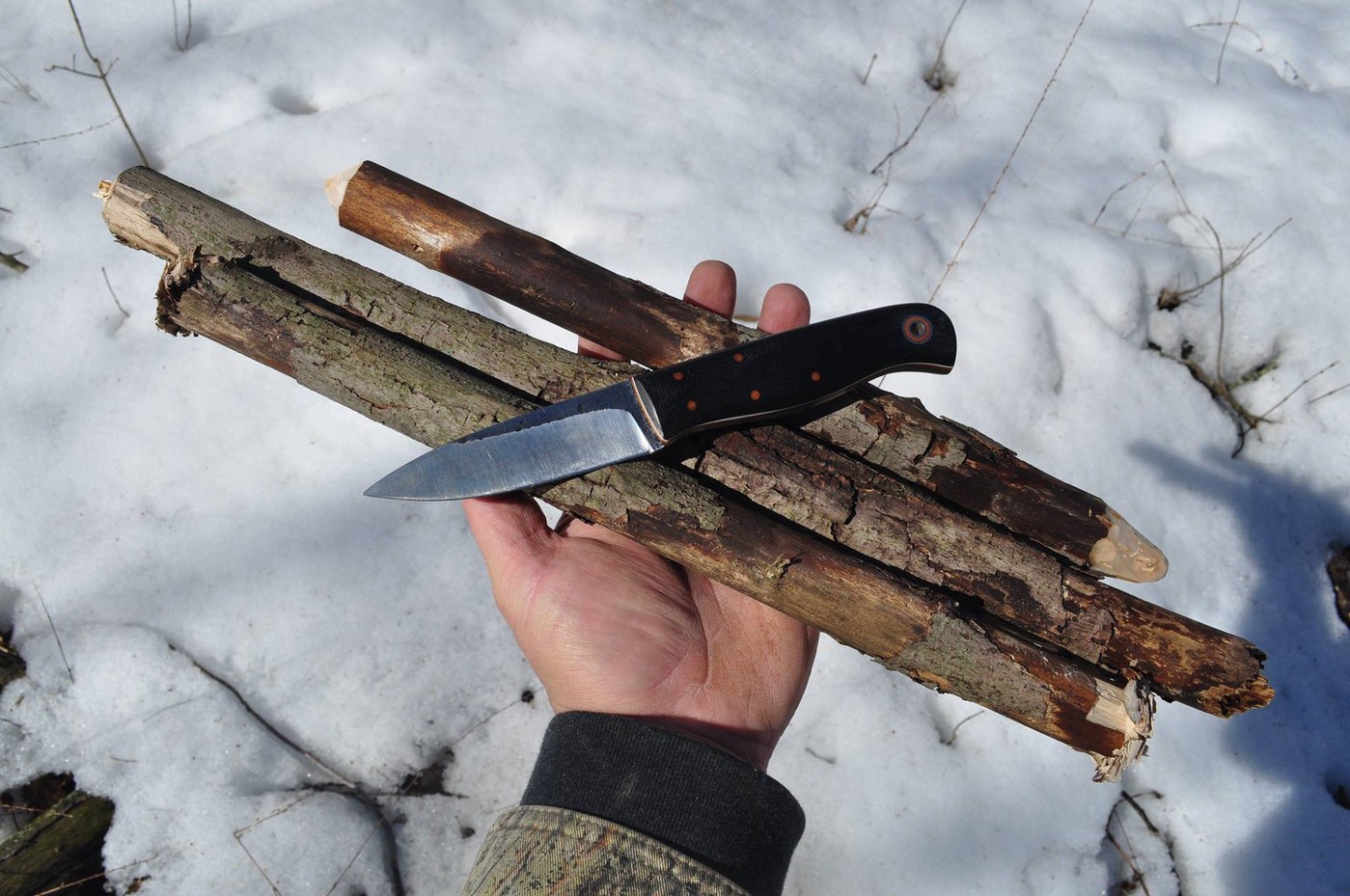

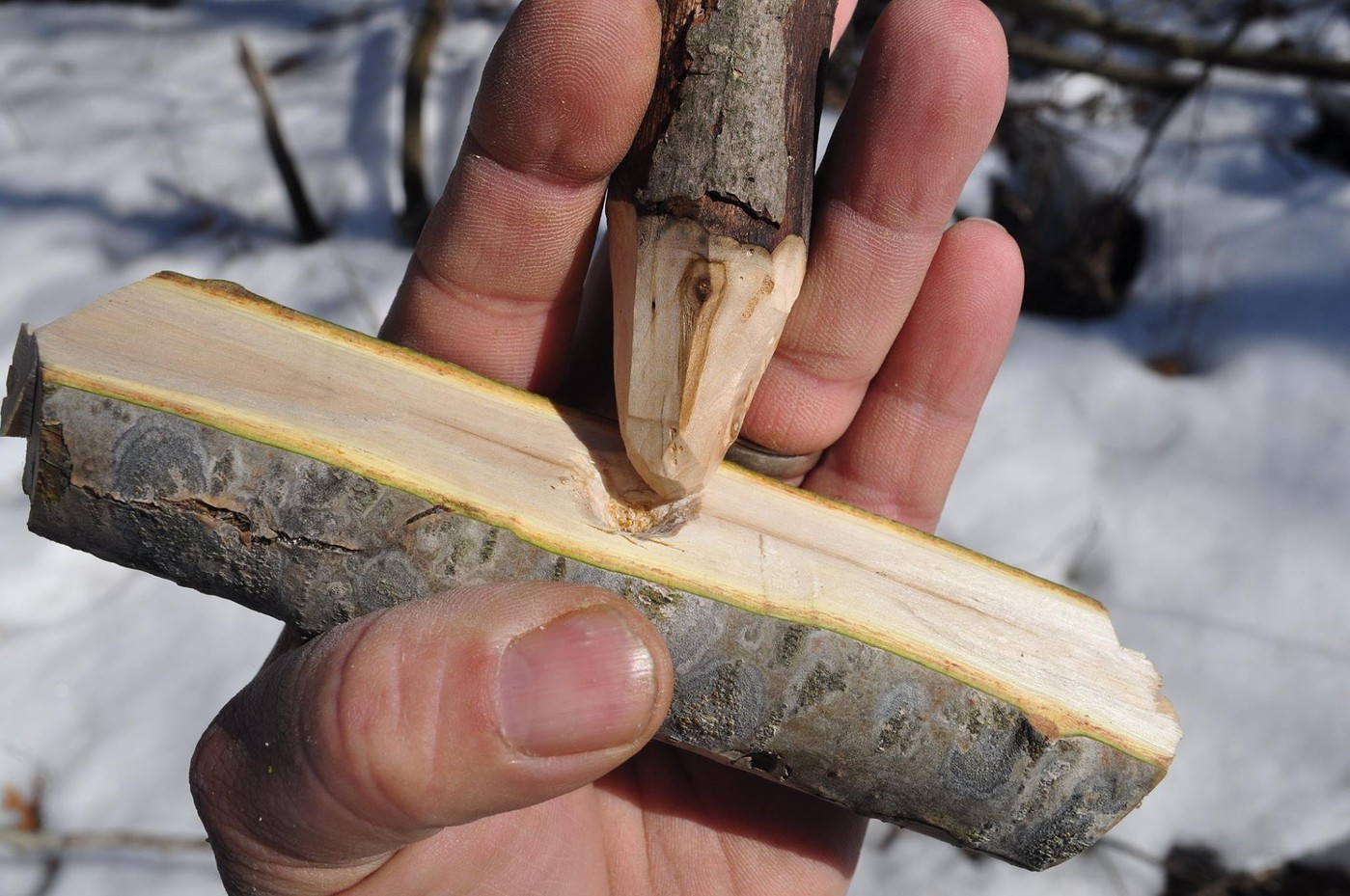

That's enough of that, just wanted to explain the anger I was feeling as I put this KE Bushie in 1/8 / 3mm A2 to the test of making a two-stick hearth board (a friction fire technique I had learned from my friend Rick Marchand Rick Marchand years before) , spindle, bearing block and bow using only this knife, my paracord bracelet, and what I could scrounge in a frozen forest with several inches of snow on the ground.

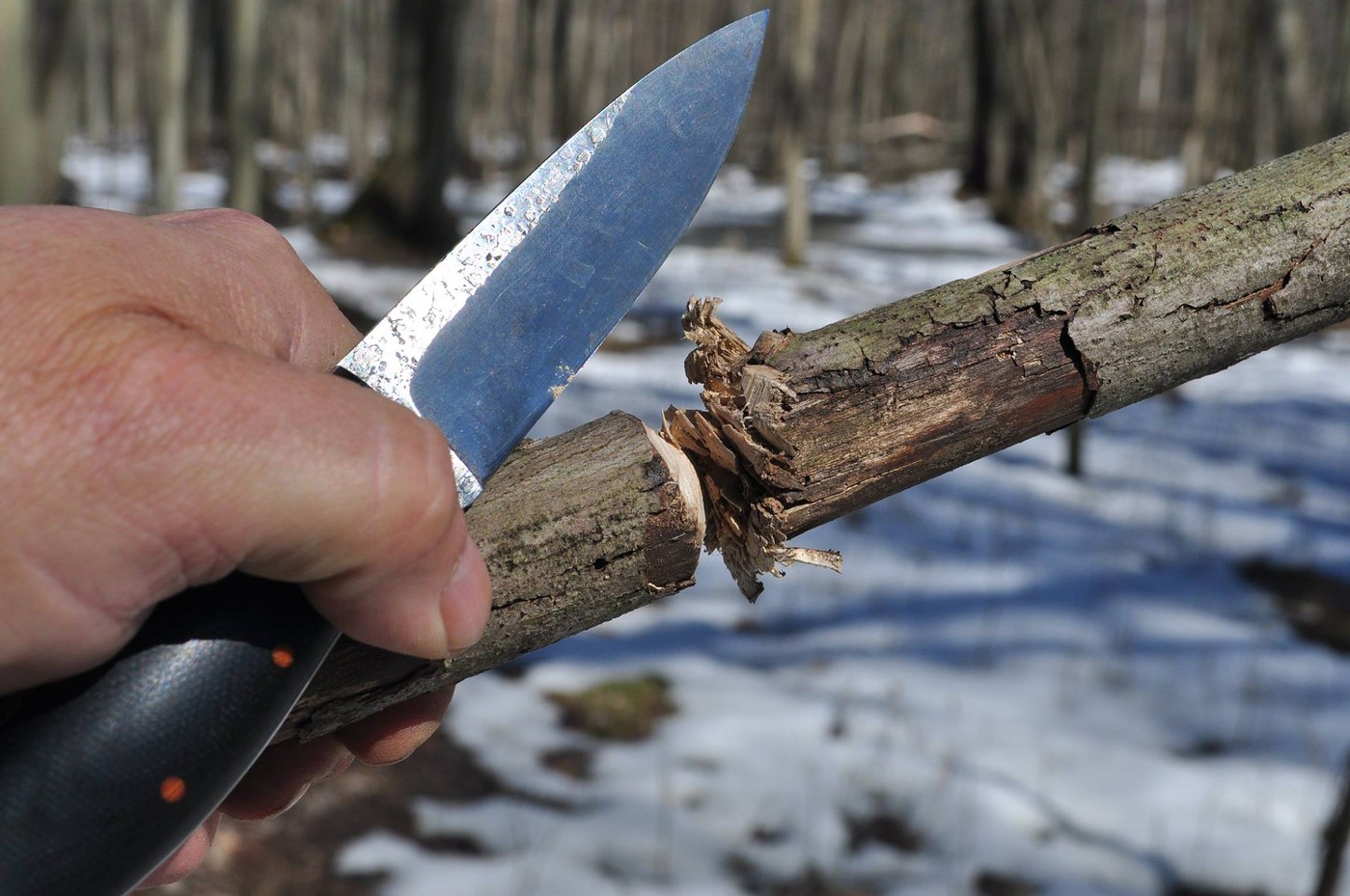

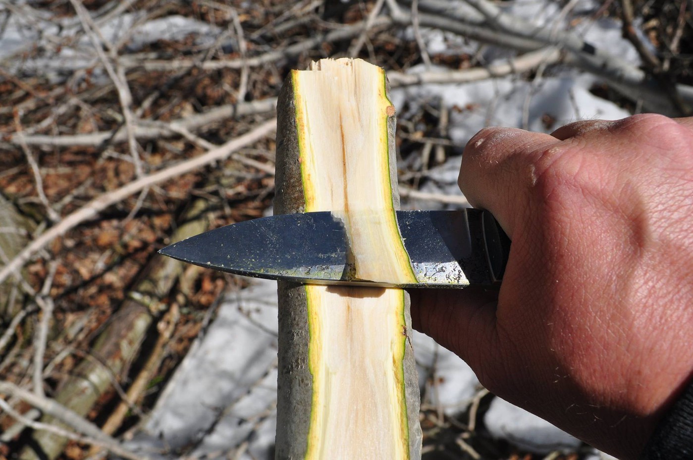

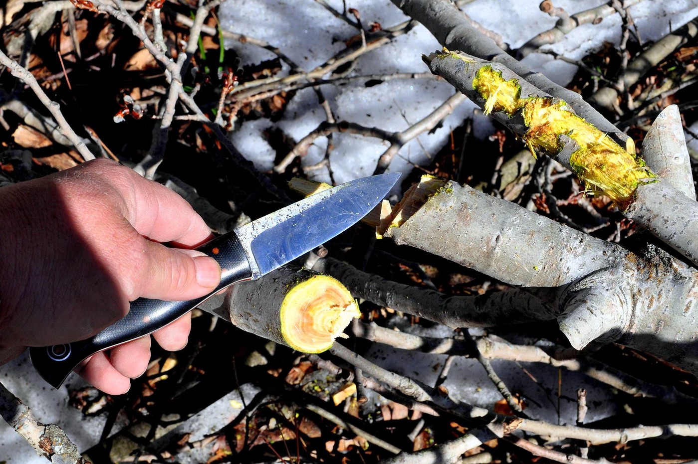

It started that morning with me finding a dead limb a little over 1 inch in diameter. I cut it into three pieces using a technique I call ring-and-break which abrades the edge quite a bit but produces clean ends easier than cleaning up fractured broken ends. I did a piece on that technique for the blog years ago. Two of the pieces were for the hearth board, and the other was for the spindle.

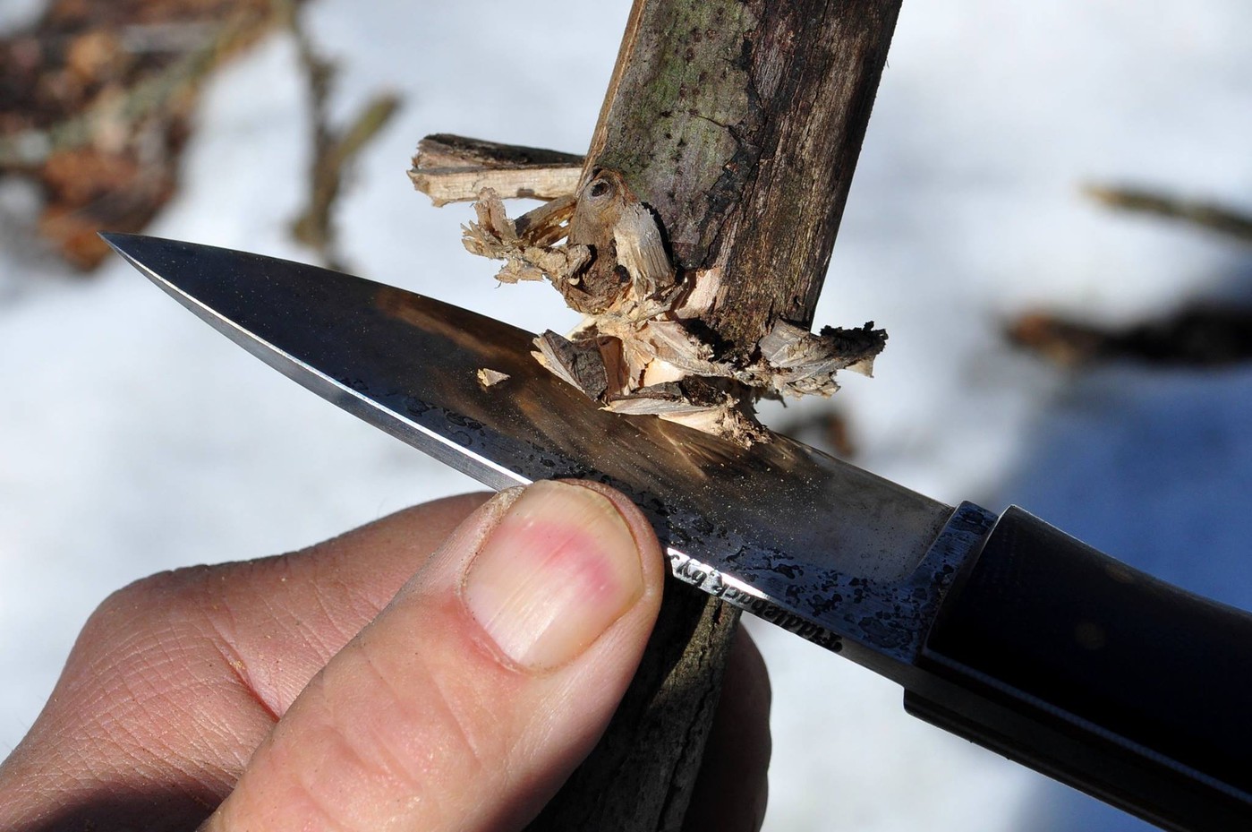

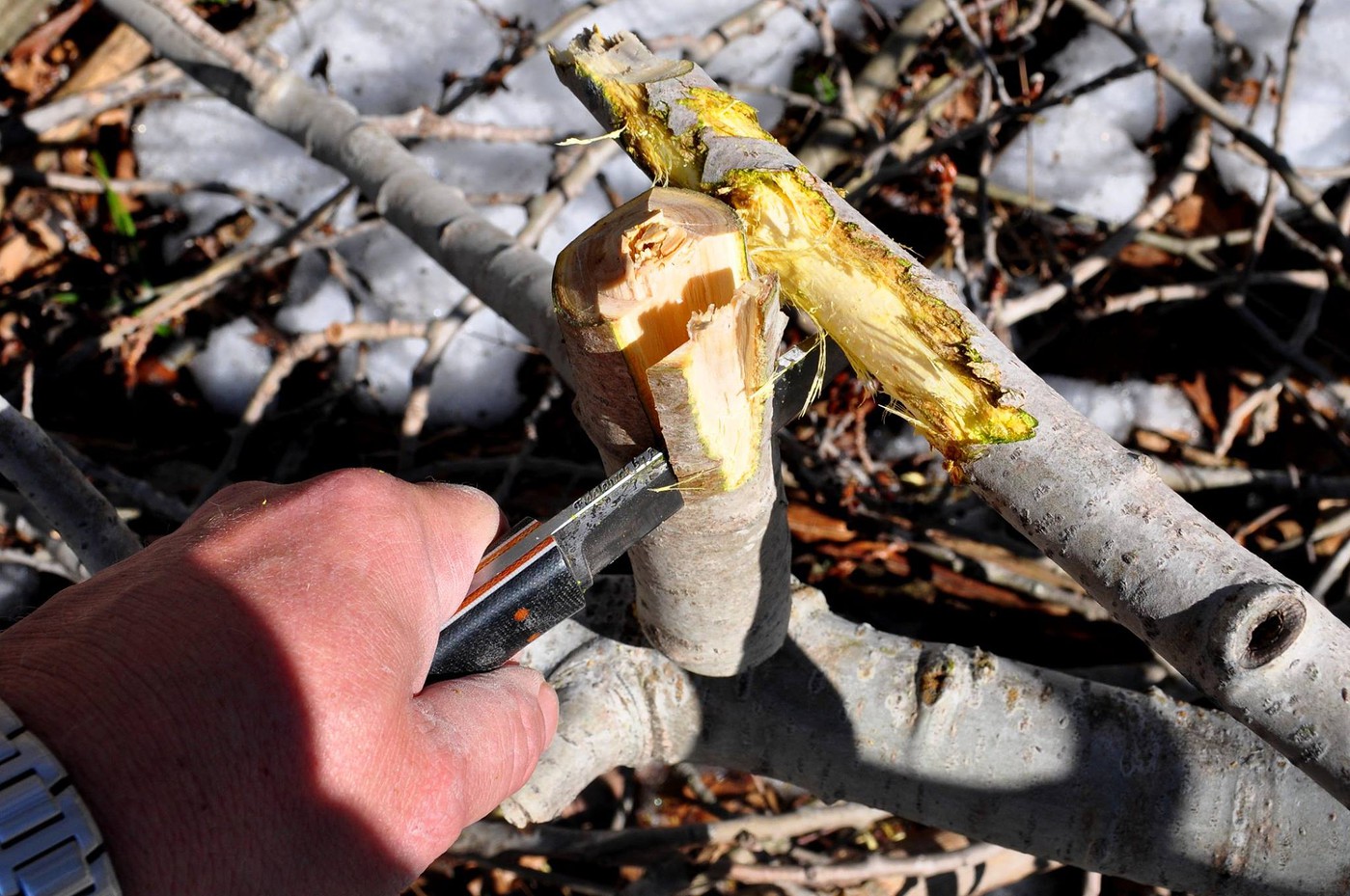

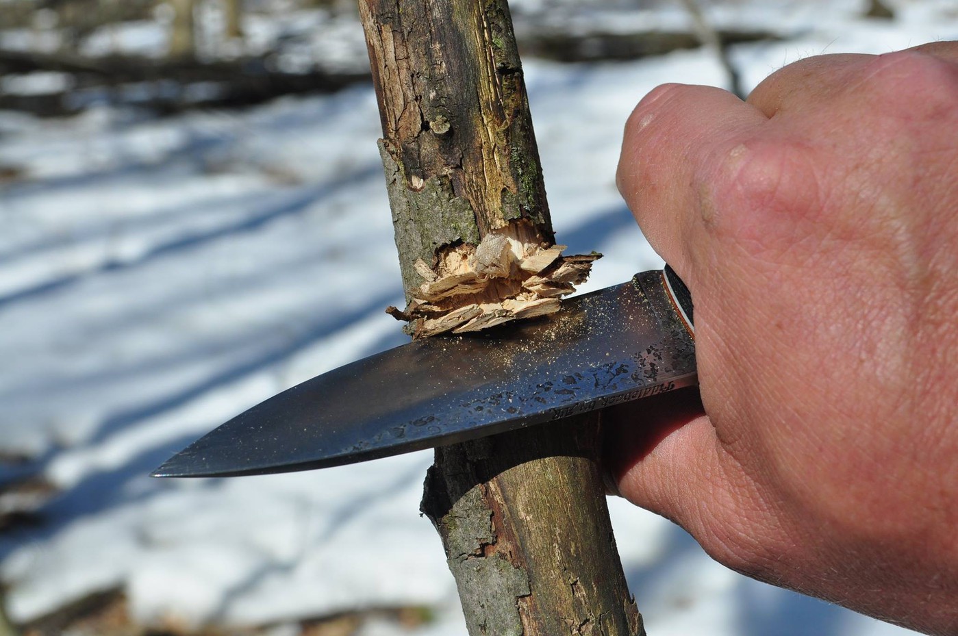

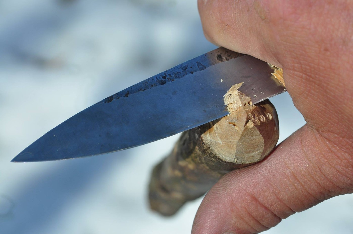

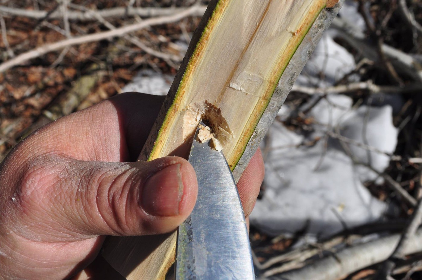

Then next came the bearing block which took a combination of batonning, whittling, and boring to make

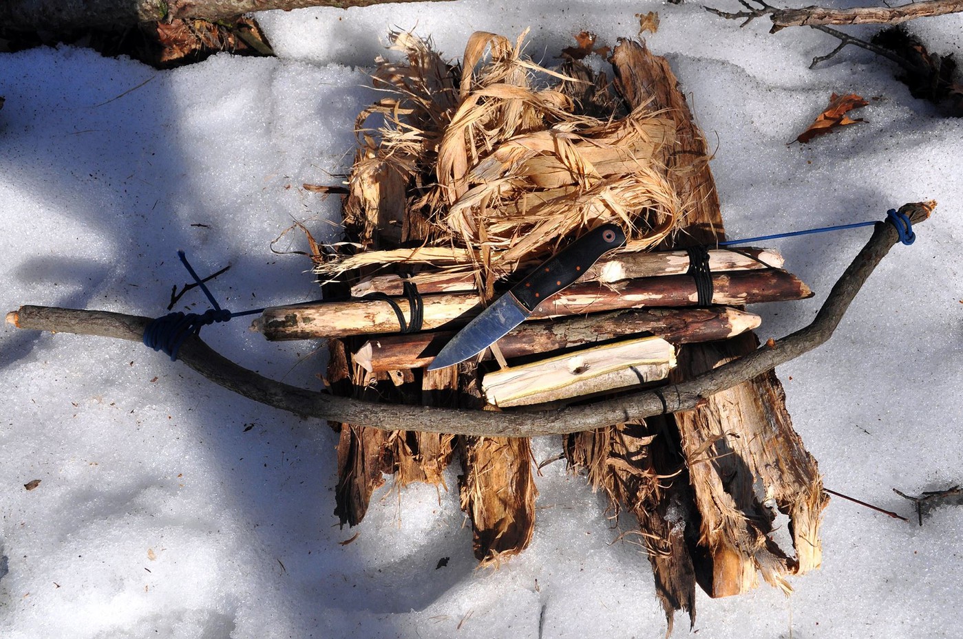

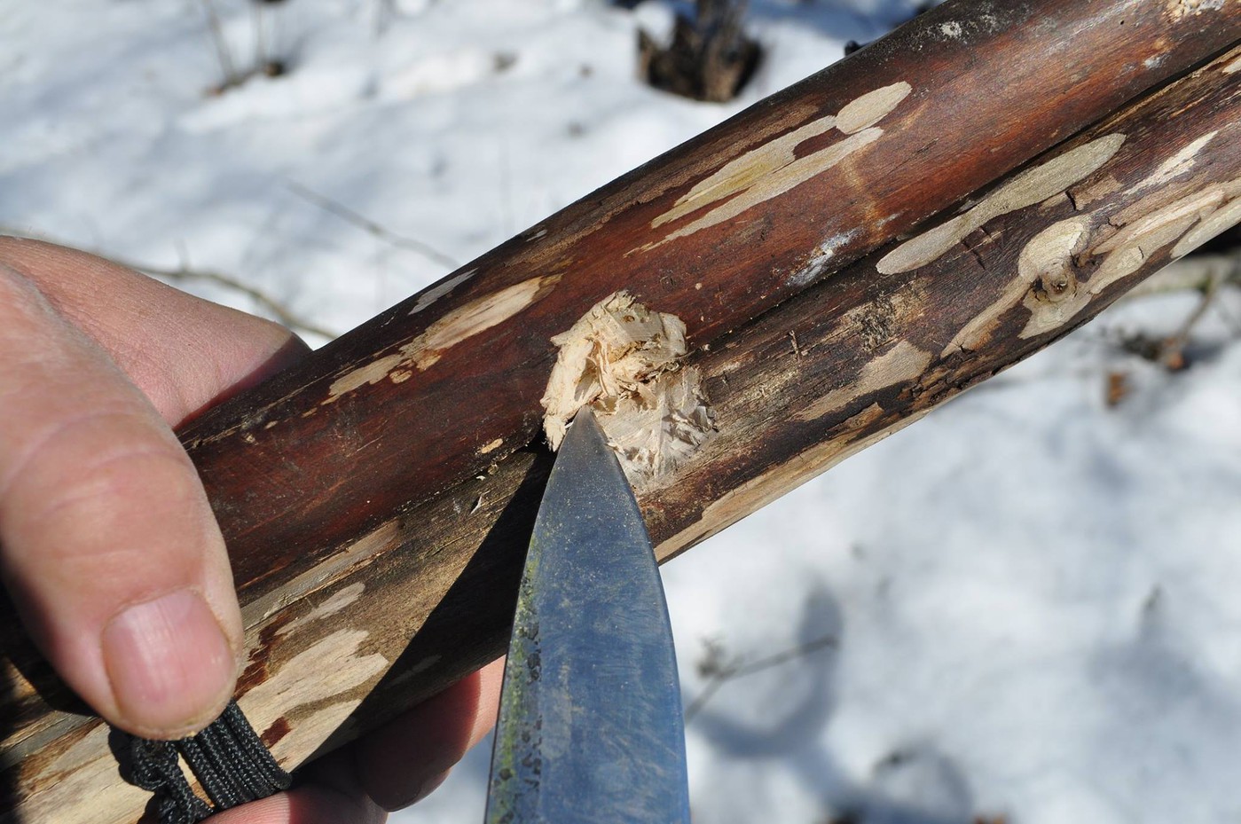

And then the bow was just a matter of finding a limb with a little natural curve to it
And now you know the story behind this picture in the "Just A Picture" thread
I didn't start a fire with it because it was late March and finally actually above freezing, in the mid 40s, that afternoon for the first time in over 3 months and the humidity was way to high for friction fire. Rick probably could have done it with his idling technique, but I had vented all my anger as was just ready to go home. However the time was still well spent because I learned several things. Among them are that thinner blades encounter less resistance when truncating than thicker ones and will bite deeper with the same amount of force or less (I never used any less force this day, if anything I used more at times). That a lighter weight knife could still be a very capable tool. That the quality of the knife largely comes down to the quality of the person making it, especially in regards to the heat treatment and handle attachment.
The tests that were done that day are the reason most of the knives I carry today are a lot thinner and lighter than they were previously, as I learned that being choosier about the people who make the knives I carry is much more important than being choosy about the blade thickness.
I love the KE Bushie and 1/8-inch is just about perfect for most “real” tasks you would expect it to perform.

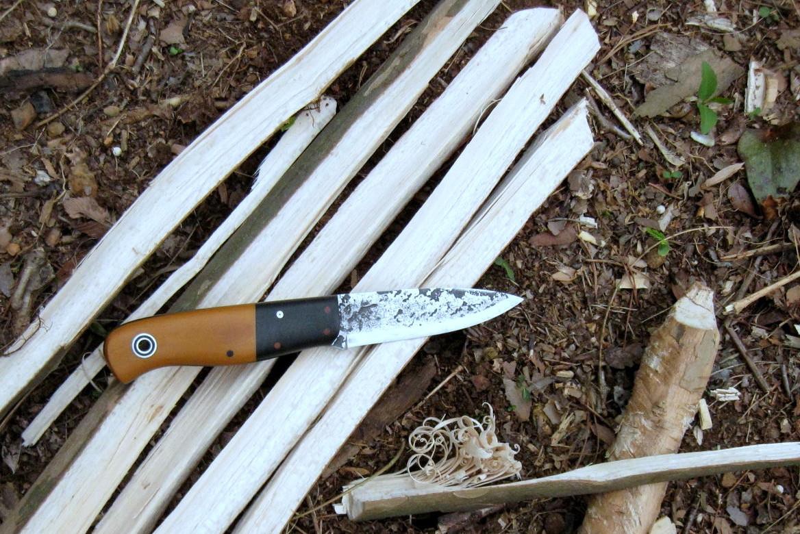

I like the KEB a lot as well, I've have a few of them. This one was my favorite functionally. I had a dessert ironwood one but it was so pretty I didn't like using it. At the time of these tests my favorite Fiddlleback was a Recluse in the same handle configuration but tapered 5/32 and the Fiddlebacks were trending toward 3/32 so before testing the 3/32 I wanted the see what the 1/8 could do as a reference. I grew up in Florida, I'm more of a big knife guy than an axe guy. I never take an axe camping here in the south, just a large knife and a smaller knife. Sometime a snall machete instead of a large knife. I was thinking of staying in Michigan permanently so I wanted to see what I would pair with a small axe for winter outings the next year. After all this my ideal KEB would be this handle configuration and not-too-thinly tapered 1/8 with this same grind height with a minimalist sheath I could carry as a neck knife

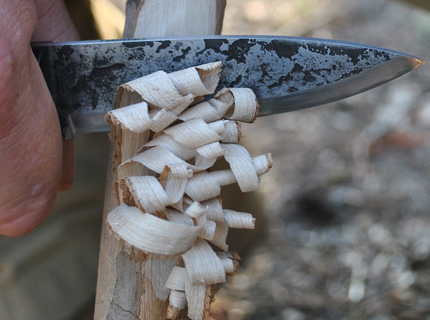

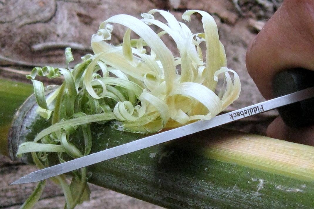

Looking at your KEB reminds me that I would love to repeat the same tests with two 3/32 KEBs, one in scandi and one with a higher grind. So far I prefer the scandi in the thinner stock for better cutting and less resistance, and I think I prefer the thinner stock in a scandi grind for more steel left in the blade and spine for more lateral strength. But that latter thought is just theory, I have yet to put it to the test.
My first KEB back in 2010 was a scandi in 1/8.
It did excellent in whittling wood and making feather sticks, even in bamboo with it's hard fibrousness and silica content.
And it did well in batonning with the grain to split wood as well.
The thing I learned with the black KEB in Michigan was that the 1/8 / 3mm stock with the higher grind sank deeper into the wood without binding when truncating (batonning cross grain) much more easily that the same thickness of stock with a scandi grind had in similar hard woods.
