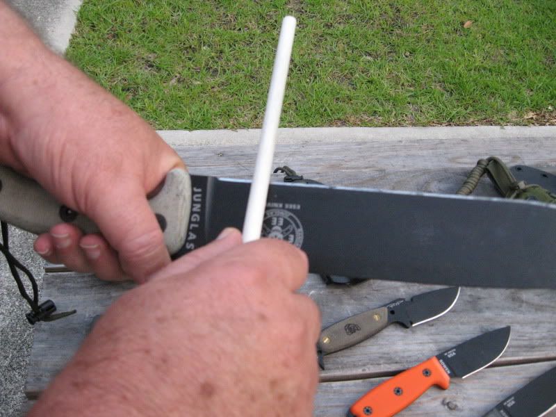

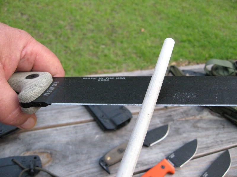

One of the things I really like about the Rowen made ESEE knives is that they come with a good edge right from the factory. It is easier to keep a knife sharp than it is to sharpen a dull one. For "touch ups" to the edge, I like to use a cheap ceramic rod. There are two mistakes people tend to make using these rods: First, they use too much pressure. Second, they don't make sure they are touching the final edge.

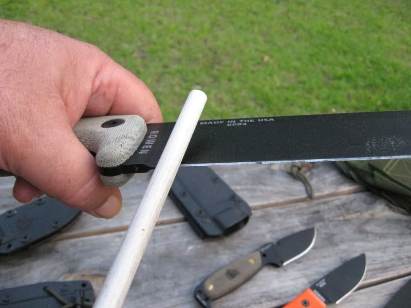

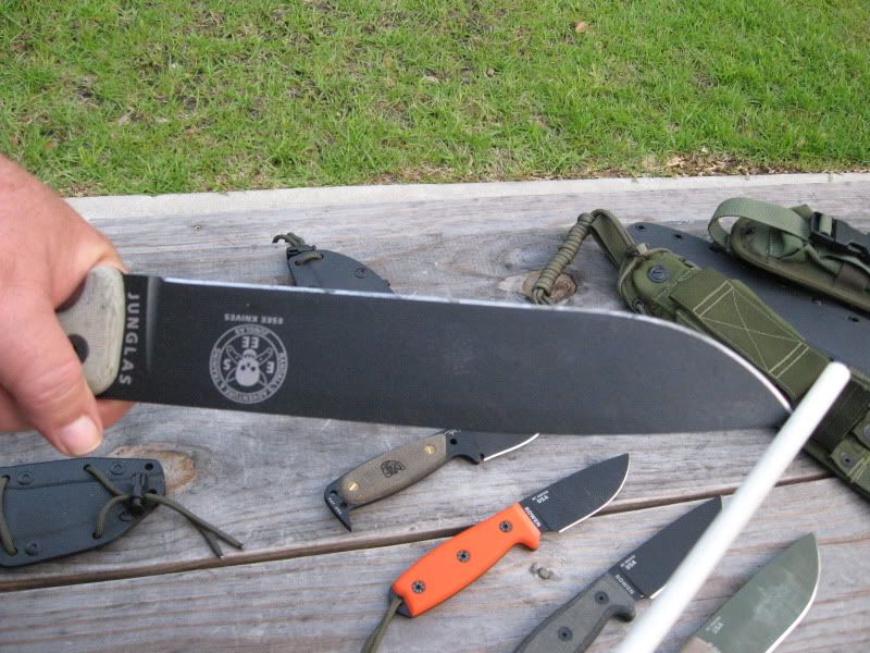

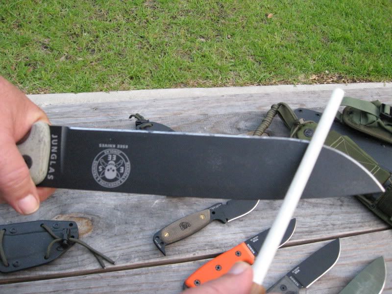

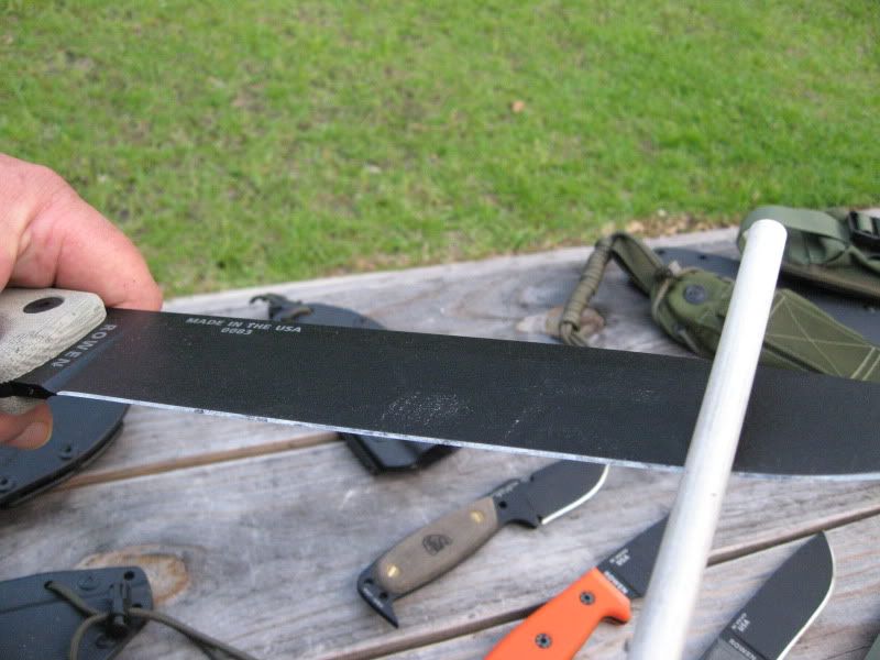

Having used the Junglas slashing and chopping the other day, I just gave it a little touch up this afternoon. Some folks like to hold the rod stationary and slice into it. This method works fine for shorter blades. Others like to strop the edge, moving the rod down the blade away from the edge. I get my best by very lightly stropping into the edge simultaneously moving the rod down the edge. Try to appoximate the original grind angle. Like this:

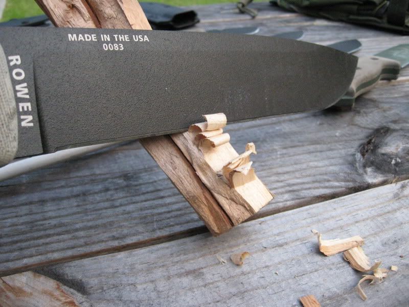

After doing each side, feel the edge by gently moving your finger away from the edge. NEVER move your finger along the edge or into the edge, or it WILL CUT YOU. If you feel a burr on one side, gently strop the side with the burr and then draw your edge across some wood. All done, and ready for the next chore. You can put a little oil on the edge. The easiest way is to just spray it with some WD-40. Then return them to their sheaths.

Heck no. I use a leather strop with compound, various stones, steels, diamond sharpeners, files, and a Kalamazoo belt sander. But for touch ups, keeping an edge, I like the ceramic rods.
You use the same sharpening technique with that rod that I do with rods or diafolds, etc. I even do that on smaller knives. I find I have an easier time controlling the angle of approach along curves (like at the tip) if I bring the stone to the edge, rather than the other way 'round. :cool:
Same here. It takes a light touch and practice, but once you get it down, it's easy and fast. Of course, on a seriously dull edge, it would take forever with a ceramic rod. Something more aggressive is required then.
Like a good file--which can be used much the same way! :D:thumbup:

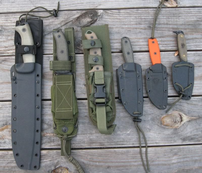

Right on. Thanks for the write-up. What sheath is that in the first pic (OD one holding your 6), and where could I find myself one? Looks sweet.
That is a Spec-Ops Navigator I found on sale at EM Gear. It's the short version and if fits perfectly. They were discontinued.
Smoky Mountain used to sell them for 99 cents. I think they are $1.99 now. I keep them in the kitchen, my tractor tool box, and lying around. When they get loaded up, I just scrub them with Comet and a Scotchbrite pad and they work like new again.
you can just google crock stick (like crockery).
Thats how found mine.
