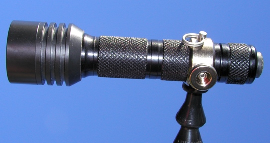

I saw a really neat idea for a swivel and attachment in a flashlight forum. The guy machined a brass button that fits into the clips you buy for cell phone. Of course his button attached to a flashlight, but it would work for a knife too. just make a little button that attaches to the sheath.
As long as the knife is not too heavy, it would work good. When the clip wears out, you just chuck it and buy another for $4. The clips are pretty tough (at least Nokia branded ones). I always break the plastic buttons before I break the clips. They tend to last me about 6 months and your talking in and out at least 20 times a day.

Found a picture of the homemade swivel the guy made for his flashlight. Thought it would be a cool idea for a knife sheath.
