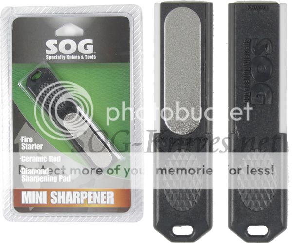

For field touch ups, I've been carrying this:
Small (only about 4" long), diamond pad and ceramic rod (plus a fire starter). Can touch up plain or serrated edges. Nice little device. Around $13.
