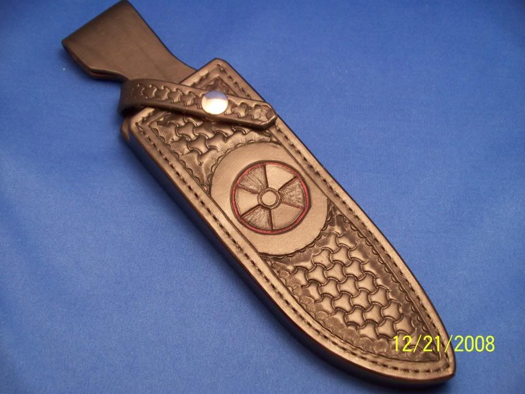

Hello, folks!
I'm looking for ideas on how to keep a fixed-blade sheath retention strap "sprung" open until snapped down, or other ideas to lessen the chance of it being cut as the knife is inserted. Most of the sheathes I make are for knives with some type of guard, and I prefer a retention strap around the guard and then snapped down on the front of the sheath.
I thought of inserting a small piece of music wire, etc. in the strap to keep it open and away from the blade, or lining it with a plastic "flat spring", but haven't come up with a suitable material that will make that tight bend and then "spring" back to it's original straight configuration.
Any leads on suitable material, or any other design ideas, would be most appreciated.

Hi, Woodtroll!
I've got a sheath made by Chuddy Bear that has the retention strap attached to the back with a Chicago screw, which is held together with one of the stronger LocTite products. The Chicago screw turns easily in the leather, so when I unsnap the front, I (usually) swivel the strap down behind the sheath out of the way. It's not automatic, but once you get used to doing it that way, it works like a charm. :thumbup:

Here are a couple pics for a visual. It also makes replacing the strap much easier just in case something bad happens to it. Make sure to use at least blue loctite on the threads of the chicago screw and let it set up or that little bugger will work its way out.
Thanks, Greg, for pointing this out!
Thanks even more, Chuddy, for being willing to generously share your idea! I like that plan, and sure appreciate the pictures and details. It seems pretty foolproof, and I will try it out on my next project!

I use snaps front and back so the strap can swing out of the way, and this one's really easy to replace if cut or lost.
Some people like their straps to wrap around the handle and as far as I can tell there's not as much you can do to make that as safe as an across-the-choil type of retention.
