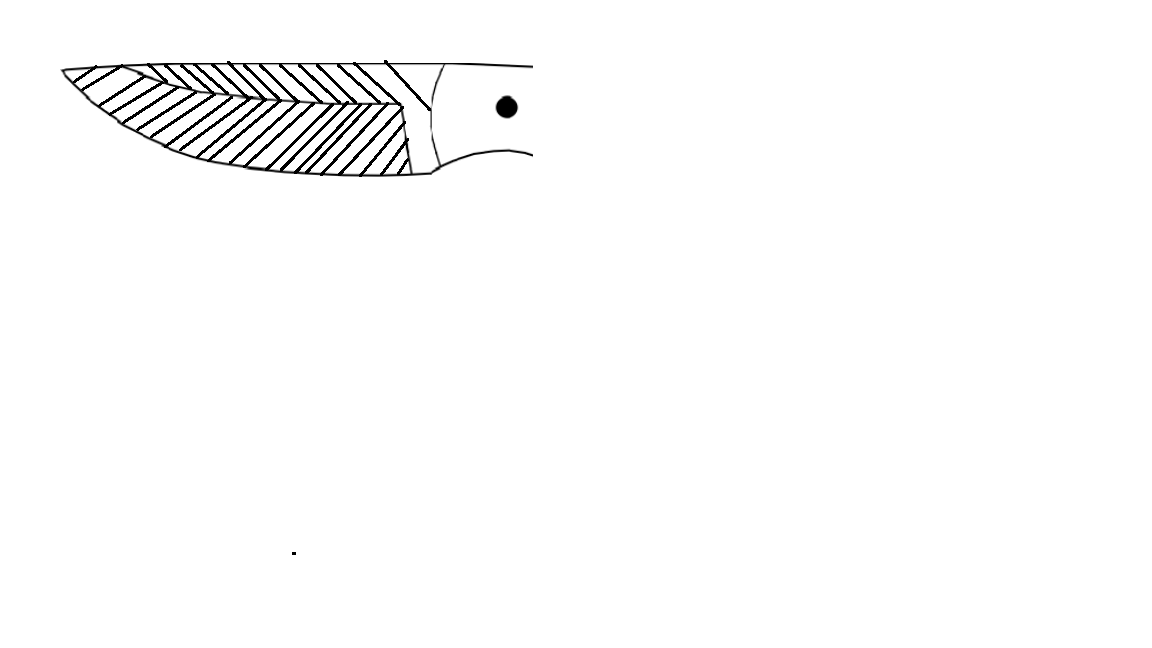

The was I was taught to keep crisp lines on clips and swedges was to when you are grinding at an angle on the main bevel so all of the scratches are going one way. Then when you move to the clip or the flat make it so the scratches meet at the transition like below.
the lines on the knife idicate the scratches from hand sanding.

How does that keep the transitions straight? Not sure if you're understanding me. What I mean is, when hand sanding a bevel sometimes the sandpaper touches the flats, causing little scratches and washing out the transition. I'm try to get things so I can sand just one area and keep the transition line real crisp

Ah I get what you are saying now. Tightening the sand paper should help with this. I have been using using psa sand paper from car body shops you can buy it by the roll. Its sticky on the back side. Just cut it and stick it on your sanding stick.
