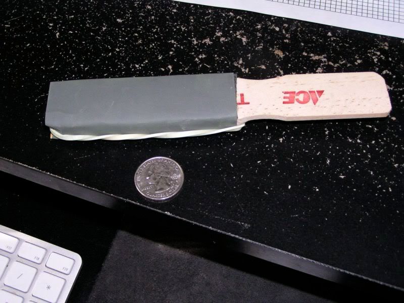

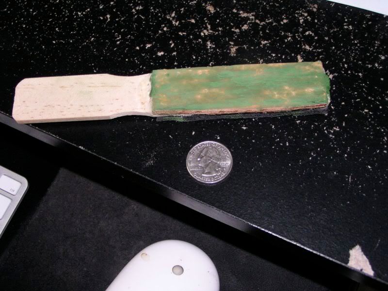

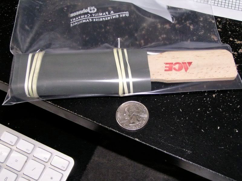

I put together this small kit, took a pieces of strop leather and glued it to one side of a small paint stirrer, the other a small section of mouse pad- the strop is loaded w/ compound, the other side I use w/ the sandpaper - I carry 200-1000- the entire kit (including ziplock) weighs 1.1 oz
I also carry a small Fallkniven D3 diamond whetstone (in case I've really messed a edge up :)) it's about the size a stick of gum and weighs about .5 oz

I have a DC4, but I like your set up for the strop, and sandpaper. I may forgo the DC4 on ultralight trips and go with something like this. Every ounce counts yes? ;) As mentioned I always have a loaded piece of leather, but the sandpaper idea is a good one.
Thanks, :cool:
