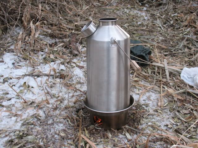

I've had mine for about 2 years now. Works great for what I use it for.
Here is a pic of it out and about last winter, boiling water for a cup of tea.
Edit: If you order it, make sure that you get the pot attachment with it. Fits over the top part of the chimney and can be used for
putting a camp pan or pot on top.
Pros:
a) The Kelly Kettle and others like it work well, boil water fast, can be used for things other than just boiling water.
b) Can use just about any fuel that you find laying around.
c) Takes a surprisingly small amount of fuel to get the water boiling. I was very surprised at how little it took to get a boil,
the first time I used it.
d) It's quite light (even the stainless steel version)
e) No need to carry extra fuel.
Cons:
a) Most companies only offer an aluminum version. Kelly Kettle are the only ones that I know of that make stainless steel
b) You have to keep water in the kettle when in use. Can't be used dry if you only want to use the pot attachment on the top of the
chimney.
c) The first time you use it, it will leak from the bottom seam, until the metal heats up and seals properly.
d) It is a bit bulky, but I strap it on the side of my pack, with a bungy cord and it seems to work well.
