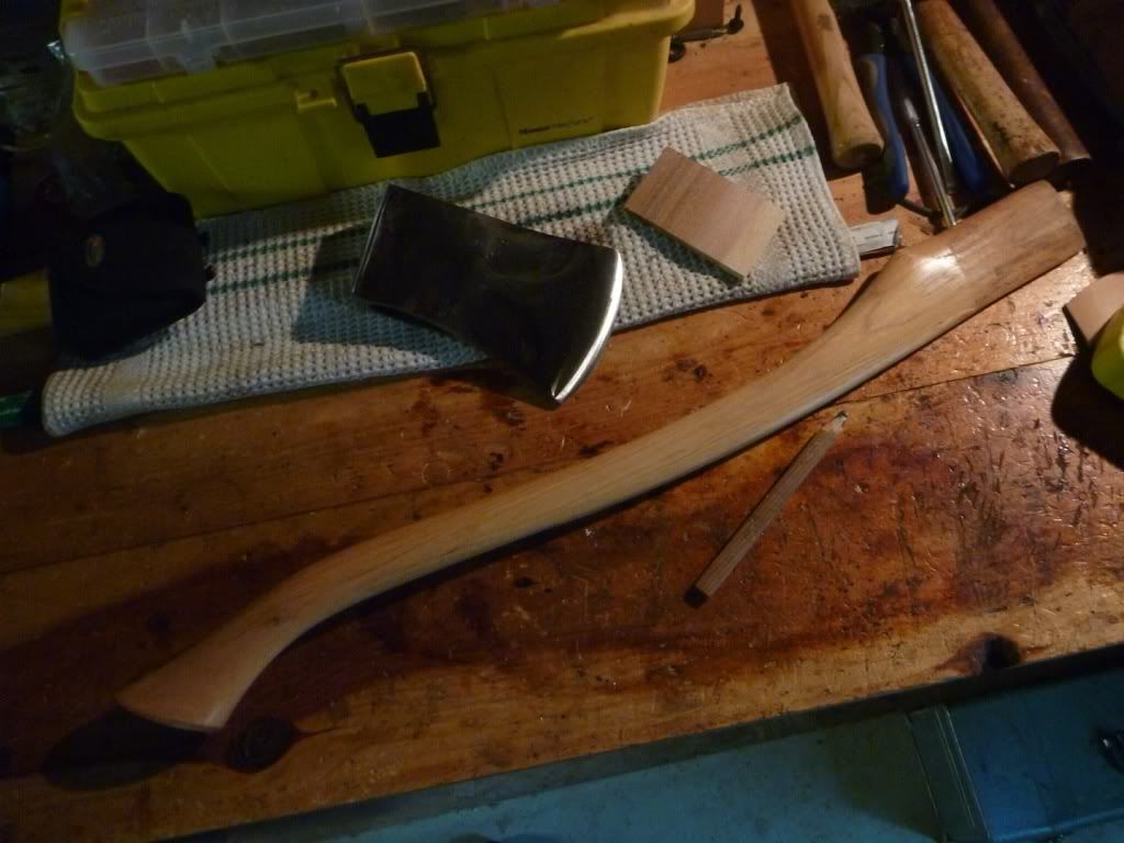

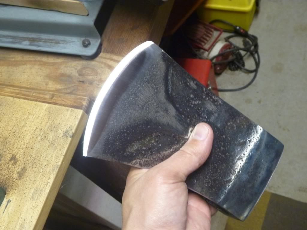

I just picked one up at a flea market last week. Kelly Perfect, Charleston W. VA.
I have a few pics to post. The first few show the reground cheeks and edge. This is a slooow process with fresh belts, very little pressure and a water trough to keep everything very cool to the touch.
I make my own wedges from Cedar shingle and chose an old 28 inch, scroll knob Collins for the handle (perfect grain).

Nice work. for clarification is that a scroll knob or a fawn's foot handle? I thought a scroll knob was like this:
I believe you are correct.
It does look more like a fawns foot. I ran across a guy who used to work at Collins and I bought the 3 he had.
2 were 28 inch. one was 16. All had excellent grain pattern. I gave them each a light sanding, coated with danish oil until the pores were full and then finished them off with a beeswax rub.
I really love how the thinner handles felt back then. Much better IMHO, than the hardware stuff nowadays.
In fact one of the handles actually has some movement in the grain when the light hits it. I usually only see that in fancy wood.
