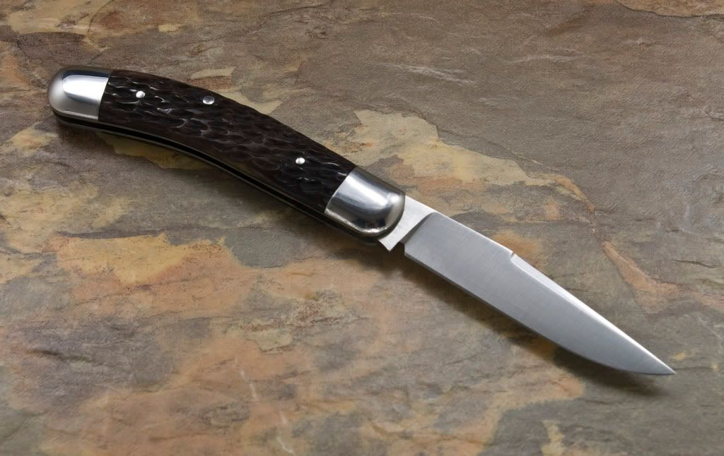

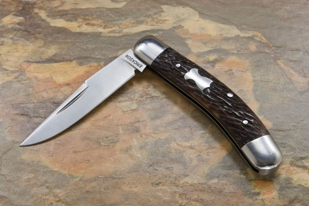

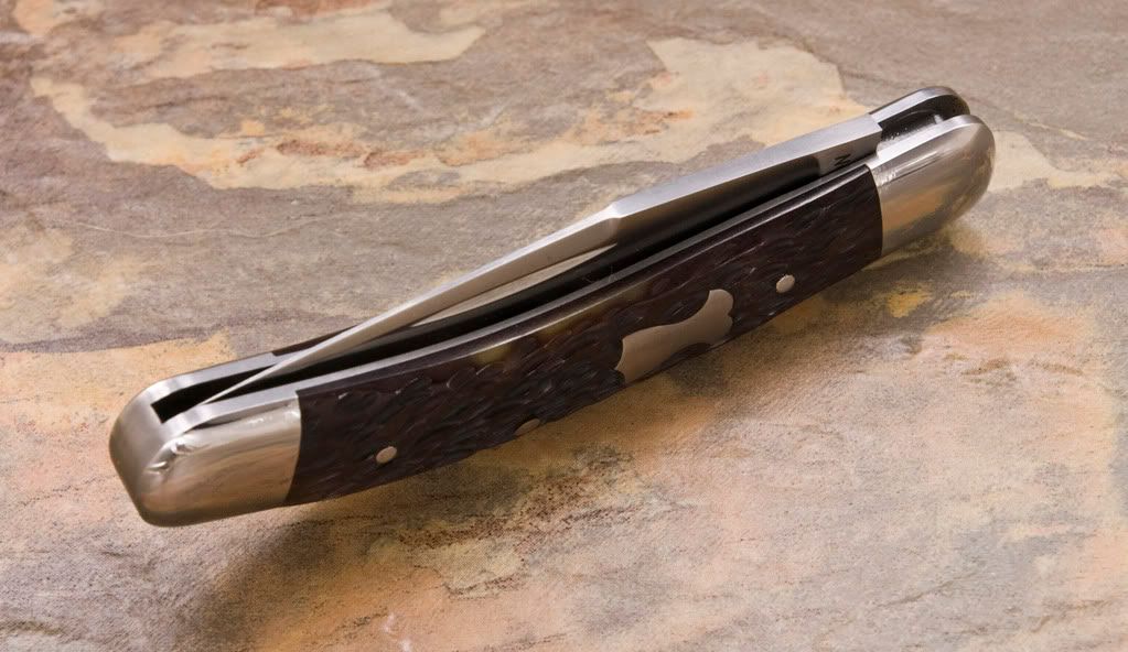

I thought I would share pictures of 3 1/8 Sowbelly made up for a Forum member.
This one has my jigged bone dyed a dark brown.
Any comments good or bad more than welcome!
3 1/8 closed
410 bolsters/frame mill relieved.
ATS-34 blade and back spring
stainless shield pinned
stainless pins
cut swedges
standard nail pull.
half-stop
Ken
Ken,That turned out quite beautiful.What a neat little knife! I bet I can guess who it is for.
-Vince
I have always like a single sow....and you did a great job...thanks for showing it
great pics btw
An absolutely gorgeous looking serpentine traditional pocket knife - slippy from top to bottom, Ken!! . .
But, I am puzzled because I was always led to believe that a Sowbelly was a pattern loosley born out of the Stockman mold if you will, as was the Cattleman pattern. And understood that it had at least 3 blades inside its frame. Please enlighten me if you will as I am always learning here and would be happy to be set straight!.
Thanks in advance to any and all information folks can bring to the table here.
Anthony

I added this pattern to my inventory of patterns after having discussions with my customer whom likes small knives. He wanted to scale down a traditional pattern and after throwing a few ideas around decided it would be neat to scale down a sowbelly pattern to a 3 1/8 single blade. I have never seen a vintage sowbelly with a single blade or one in this size range. If any members know of any I would be thrilled to see it.
Ken
sunnyd, while I agree that most of us tend to think of a sowbelly as having 3 blades, the designation as a "sowbelly" comes from the shape of the frame rather than the blade configuration.
In the old days they made a sowbelly jack with a clip and a pen. I have made but never seen a 1 blade old sowbelly. Several cos. made a scaled down version at about 3 3/8 maybe but they are rare. I made a 1 blade lock back sowbelly one time. The 3 blade is my least favorite. They also make a nice trapper.

Why is the 3 blade your least favorite, Tony? I ask because it is MY most favorite.
That Erickson is a handsome knife, regardless of what you call it.

Ken, I really admire the clean lines and simplicity of all your knives, especially the single-bladed knives you've been showing here. It's a shame you're not taking orders now. You make incredible designs. :thumbup:
A nice one Ken. Thanks for posting.
To all concerned is the Sowbelly Pattern a English or a American pattern. Stan Shaw a English or Sheffield Maker has made a lot of knives of this pattern. The 3 blade is also my favorite configuration of this pattern.
In 3 blades I like a regular stockman better. I think the back blade comes out of the knife at a more useable angle. The sowbelly stock is hard to beat for looks but for me a regular stock uses better. By the was Ken, nicely done. I like 1 blade sowbellies.
That's a great smaller knife Ken. It boggles me how you can make those smaller pieces and come up with a graceful and cohesive design. A nicely scaled down rendition of that pattern. And I agree with Tony on the back blade of a three blade, or a one-spring 2 blade; it opens at an odd angle.
The "Erickson Jigged" bone makes this knife particularly special. From here (I'd sure like to be a lot closer) I can't find anything I don't like.
