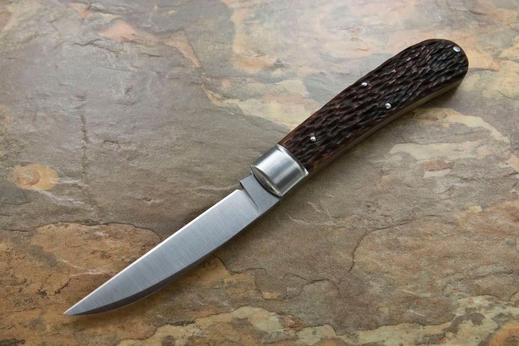

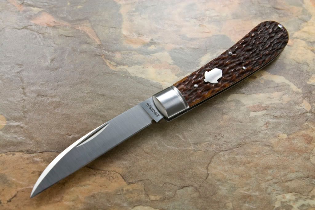

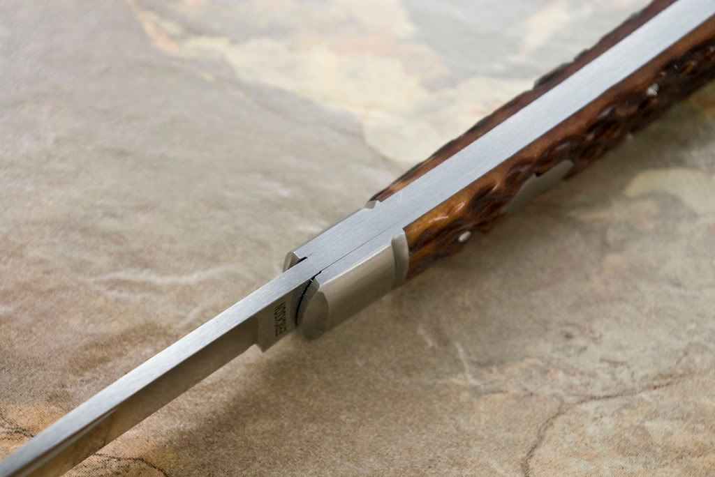

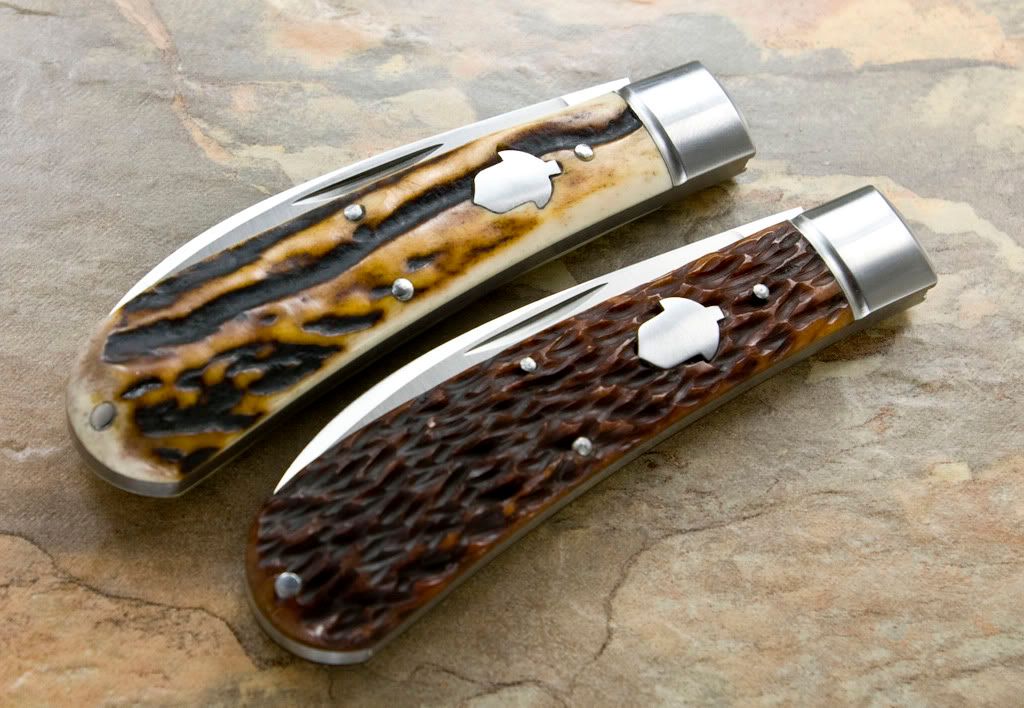

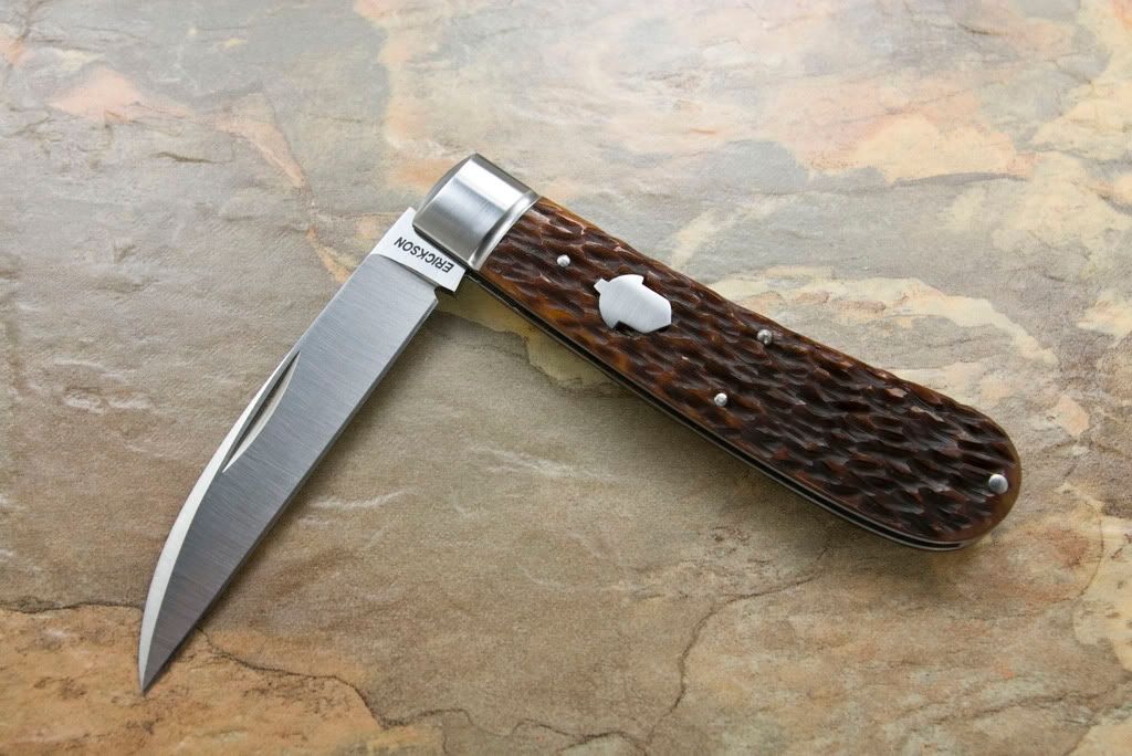

I am making a few swaybacks up for a forum member and with his permission thought I would post a few pictures.
In my quest to make a better knife I have added a fit and finish feature that may or may not be noticed . I have added a small rotary table that allows me to relieve the inside frames/liners in a much improved fashion. Thanks Tony and Reese for the tutorial on your website!
These knives are 3 5/8
ATS-34
410 milled one piece bolsters/liners
flat ground
standard nail pull
Ken Erickson picked and dyed bone
pinned shields
cut swedges
rattail bolsters (in respect to Charlie):D
pinched bolsters
The knife with the stag may or may not be rescaled. I have also started using a parser plate and two legged parser to install my shields and the stag version is the first attempt. I have to work out the fine points of using a parser. The shield went in nicely on the bone knife using the parser.
Thanks for looking and any comments are more than welcome!
Ken

KEN, Your work is excellent. You are in a class all by your self in Jigging and dyeing your Bone Scales. If there is any thing IMO you could improve upon the knives is not to grind off the bottom pins. The Stag Scaled knife doesn't need to be re-scaled because of the shield. Thanks for showing your work :thumbup::thumbup::thumbup:
Beautiful knives, Ken! I understand your conundrum; to rescale, or not to rescale??
I wouldn't. I'd make a new knife, and discount this one a small amount, and put a small mark inside the liner. I for one would be pleased to carry that knife, with a small flaw, and save a few bucks on an EDC with bragging rights. I mean picture it:

I was ,just this week, talking with a respected forum member about my pin treatment. Finishing the pins ie spinning is something I have been trying to improve and thus try and take my knives to the next level.
Thanks for all the kind comments and suggestions!
Ken
