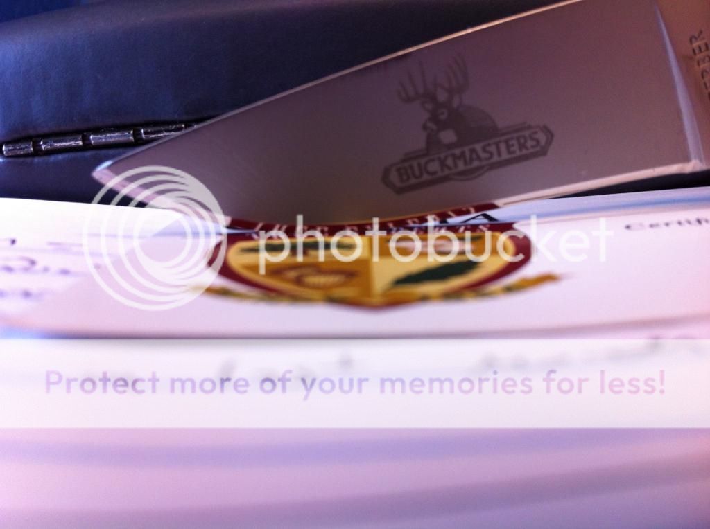

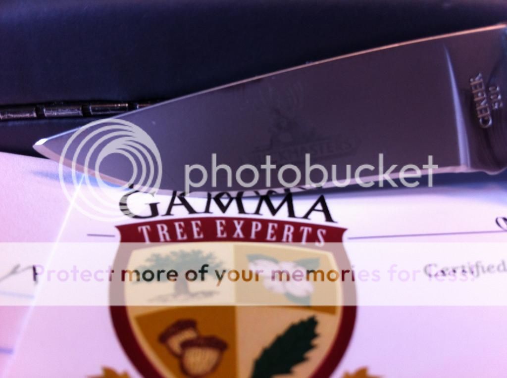

So far, so good. As an example, this is a little Gerber carried daily by a friend of mine. I have no idea what steel the blade is made of. He carries it because it was “free” through a Buckmaster’s membership. It was so dull you could saw it across your arm and not leave a scratch. The tip was broken off, likely from being used as a screwdriver. But, he’s not a “knife guy”, other than he carries one for the same day-to-day tasks the rest of us do. Like most knife owners, I doubt he even owns a sharpening stone, and would doubt this knife had ever so much as been touched-up in the years he’s carried it.
I wish I had a “before” picture of the blade, but didn't think to take one. The reason I’m using it as an example is because it went from the described condition to a nice, polished edge that will easily shave arm hair in just a few minutes. I even managed to repair the broken tip with the machine, as a nice bonus. On the other knives I've run through, I've been able to keep the bevels even from heel-to-tip. On this little Gerber, that wasn't much of a priority, nor would it be noticed or appreciated, so it's lacking a little there.

Hello MOCraig, I saw that knife and started laughing. I have that very same knife in my desk drawer. Nice job on that knife. I am sure your friend will be very happy with it. Stay sharp
That knife actually isn't terrible as a knife. It's a USA-made Gerber, lock functions, relatively smooth, nice carrying size. I wouldn't buy it, but I've seen worse. Now the steel? I have no idea what it is.
