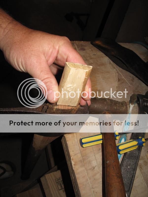

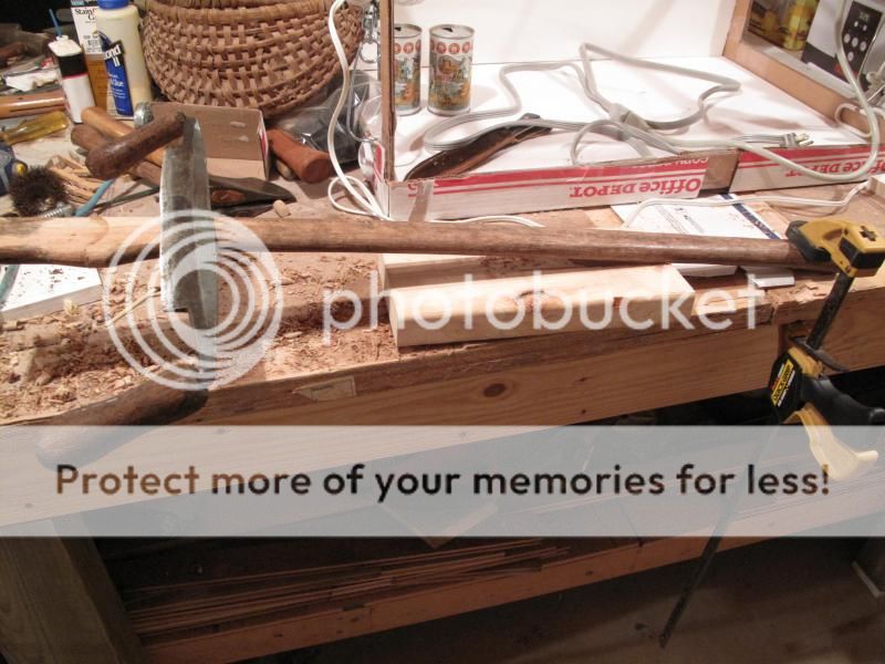

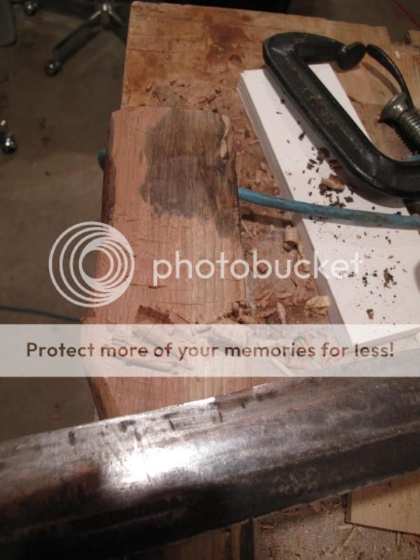

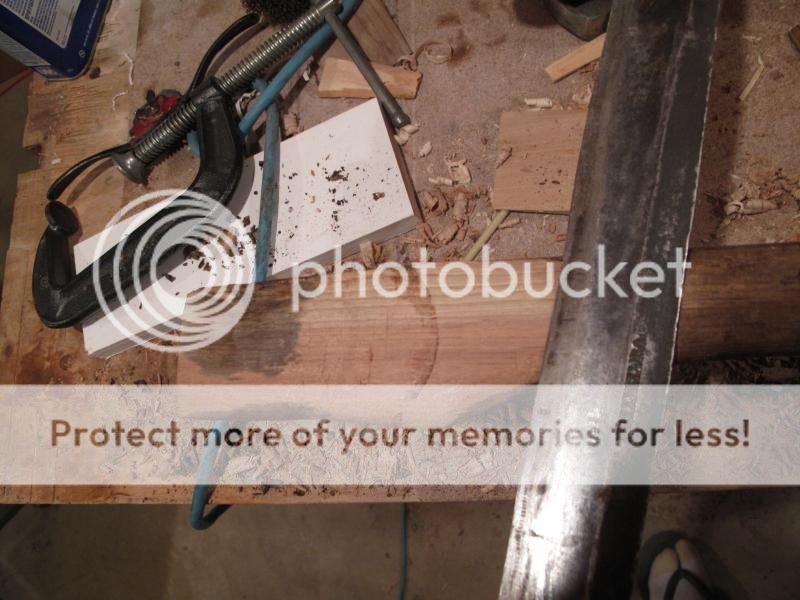

My favorite pickup- an old Plumb Kentucky- maybe original handle...maybe not but a good one anyway. Knowing that, like me, not everyone has optimum tools( ;) ) I thought I would snap pics of how I do things. Heavy rubber hubcap hammer is used to drive handle into eye for fitting, bowed drawknife for slimming/shaping, copper hammer with hickory drift to drive handle out- notch in workbench helps to prevent slippage.
Bill
Before:
During:
Just about ready for sanding/blending, cutting kerf, wedge and trim :)

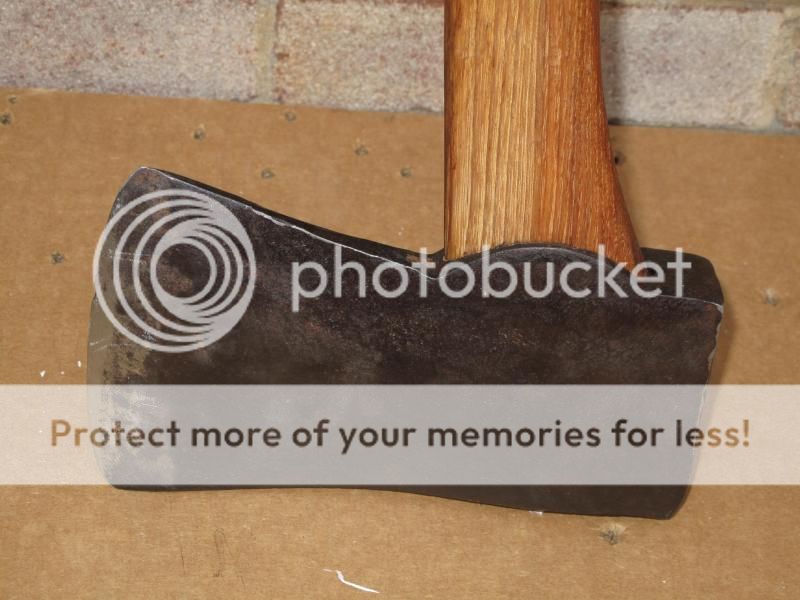

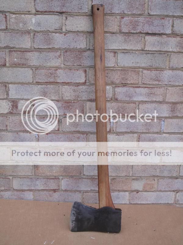

Finished it up...of course the last blow seated the head just a skosh past the shoulder...@#$#@! But it is tight and solid so I dripped oil in it and will seal gap with plumbers wax to keep moisture out. I sanded the handle just enough to blend the fresh wood from slimming. I may polish the edge just for pretty but she is ready to work as is. My first Kentucky and I really like it.
Head just got light hand sanding with 600 grit and scrubbing with steel wool. Touched the edge a bit with a file and stone.
Bill

Thank you, it was love at first sight. You just never know when pics in an ad are bad just what will come out of the box. I hate that I missed the first but JUST A TOUCH and seated it just past the shoulder- but it is tight and I will seal the tiny gap with wax to keep moisture out. I was sadning to blend out where I used drawknife and spokeshave and took a hair too much.
The hang looks closed in pics but when I rest bit and butt on bench, nearly dead center of the bit. This one hangs on the wall of keepers.
