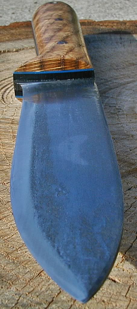

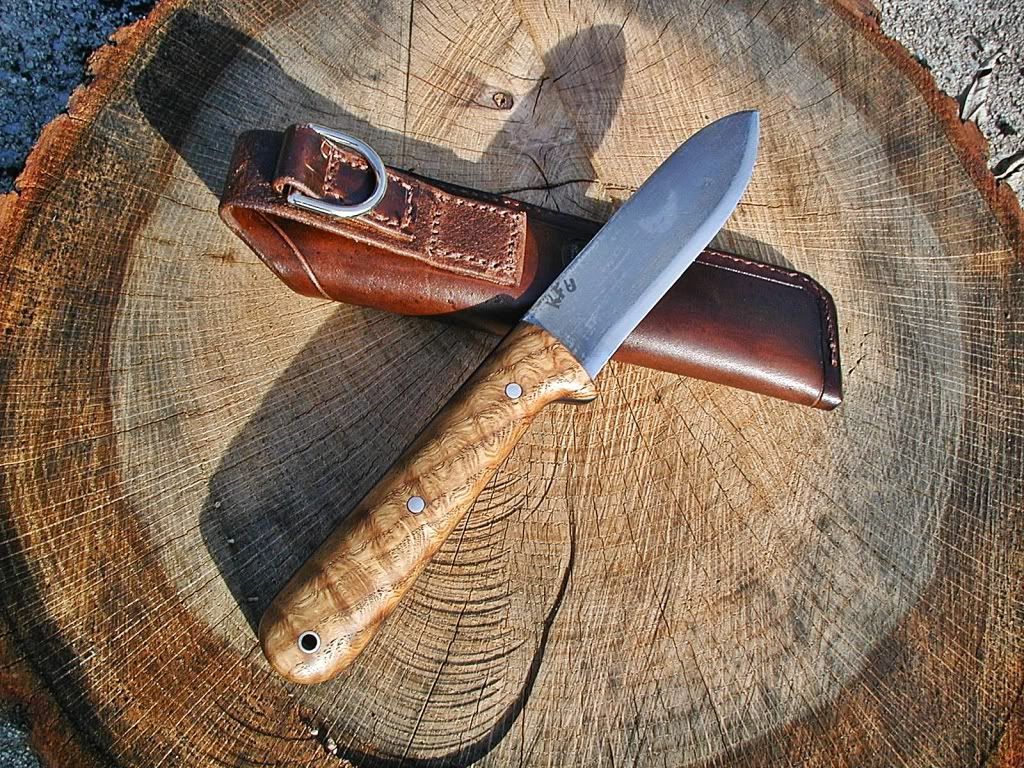

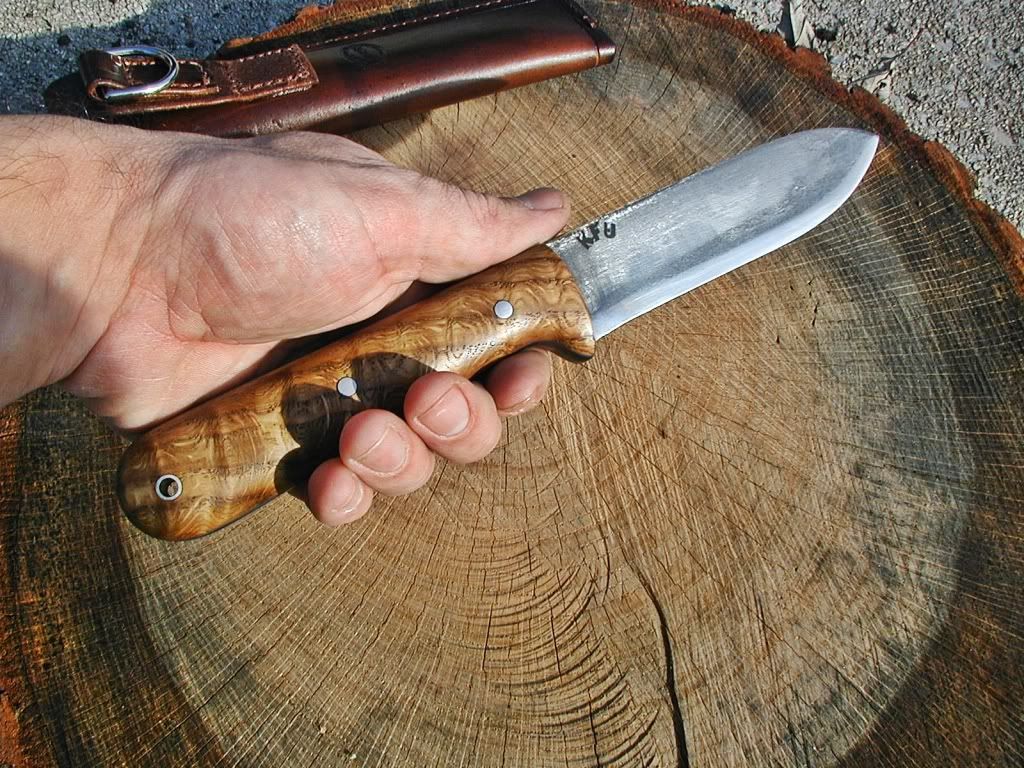

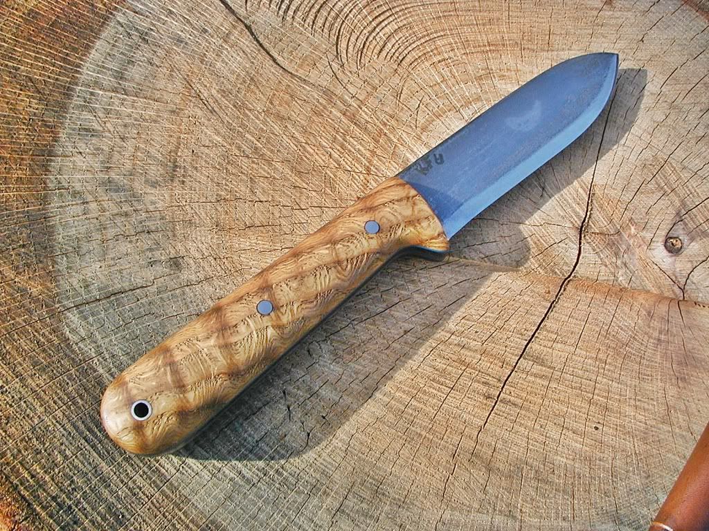

So here it is finally. I had to wait on the sheath because I didn't have anything big enough for it. Hope you like it Mtn Wildman! Thanks.
Aldos 1095 Full convex grind. Zero edge
4 3/4" blade
5 1/8" handle
Curly White oak Crotch scales with black g10 liner and blue g10 pinstripe
Stainless pins and tube
Antique finish
Custom belt sheath with removable dangler strap.
