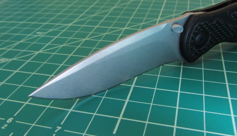

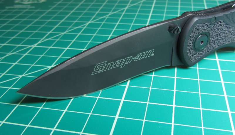

One other difference of note is the grind on the S30V blade vs. the standard Sandvik 14C28N. The S30V blade features a high flat grind, and the 14C28N blades have a hollow grind. Some of the older Sandvik Blur blades had the high flat grind, but I believe all the more recent ones feature the hollow grind. The flat grind is thicker, so it can probably withstand harder use. The hollow grind keeps the blade thin behind the edge, offering great slicing performance. For all practical purposes, both should hold up admirably

A couple of pics of the difference in grinds. The first pic is a S30V blade with the high flat grind, and the second is the 14C28N blade with hollow grind.
