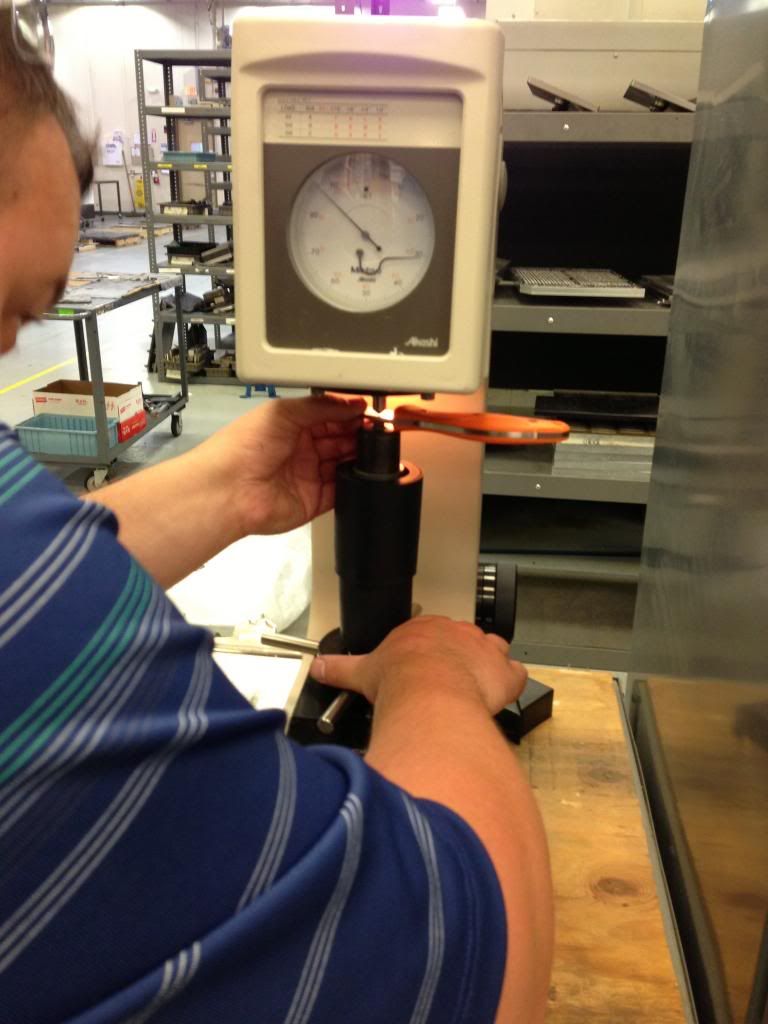

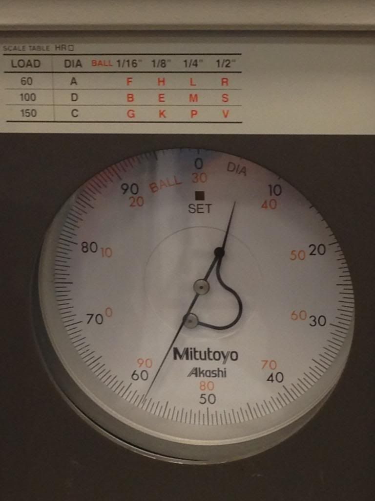

As to the HT on 8CR, I'm unsure where the 54 Rc reported figure came from, but itis incorrect. As it is 57-59 Rc would be the norm.
Took out an old orange handled Echo to show the point.

^ THIS is a post beyond what I'd expect from most manufacturers! Not only a statement of reassurance regarding the hardness but also pictures to confirm! Wow.
Am I too easily impressed? From this response, I am going out to find/purchase a Kershaw Echo TODAY, despite the sheath and non-US manufacture, confident at least that the reported hardness truly was low (perhaps the result of a user over-heating the edge during machine-sharpening). I am sorry to hear that there isn't any plan to re-release the model as US-made, but I am continually glad that US-manufacture of Kershaw knives continues! I am a former resident of Portland and have driven past the Tualatin site on more than one occasion as my wife used to work at a "birth center" in Tualatin.
