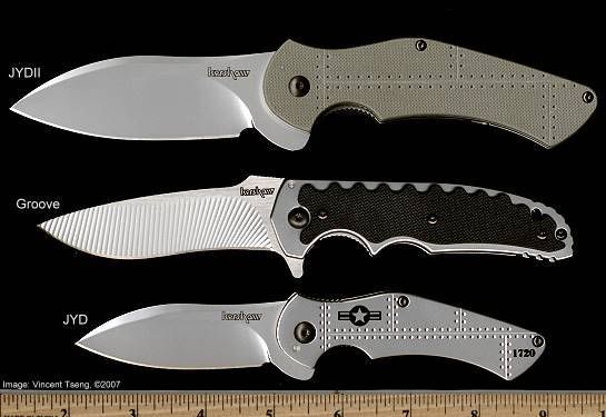

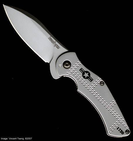

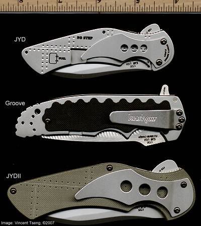

Size comparison - Open -
Closed -
The JunkYard Dog is a frame-lock -
The Tim Galyean designed JunkYard Dog like the bigger Kershaw JunkYard Dog II (link) I reviewed earlier has the nice round flipper - which seems less likely to catch on clothing etc.

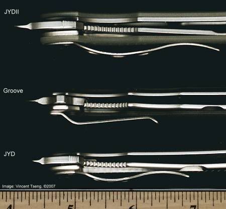

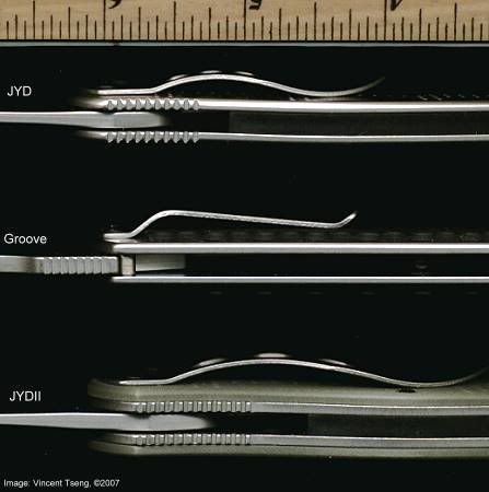

Back/spine
hidden stop-pin like the JYD2. But looking at the photos of the front handle side - one can see the stop-pin position near the pivot.

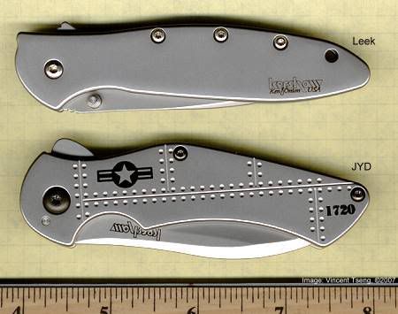

Size comparison with the Kershaw/Ken Onion LEEK and a typical Victorinox 91mm SAK

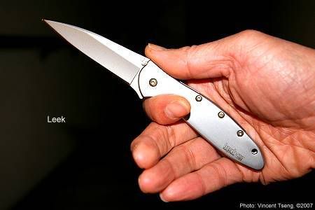

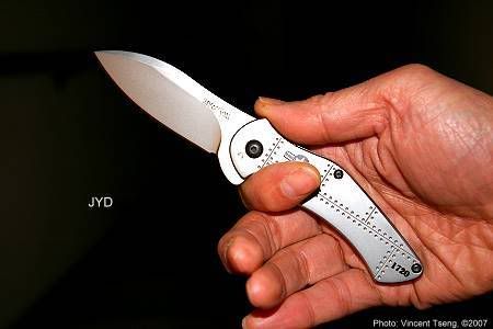

Yes, I also wondered abut the smallness of the JYD when in fact it is within a small fraction of an inch of being the same handle length as the Leek - which I have always felt was just the right length.
It is due I think to the way one's index finger falling naturally in the cut-out for the lock -
JYD -
Compare with virtually the same handle length of the Leek -
Note where the butt end of the knife is placed in my hand -
the Leek seems longer - simply because the index finger is further up toward the blade in a natural hold.

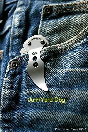

I thought the clip was a bit garish, I ground that when I reshaped the blade and handle. It's crazy tight, I might need to bend it out a bit as it is pretty hard to clip to jeans.
Overall, pretty good, though I wish it had studs. Or that they'd upgrade the Vapors just a bit.
My sample also had a very tight clip - I simply pulled the clip up (gradually) a bit at a time until I got it to be just barely touching the handle - and the tension is just about right - however the frame-lock Leeks I have all seem to have exactly the right clip tension - for me.
