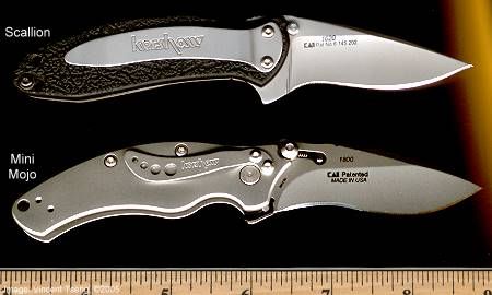

One of the knives I took notice of at the Blade Show 2005 was the new Kershaw Mini Mojo - another new design from Ken Onion.
New are the Stud-Lock (patented),
and a very innovative safety for the Speed-Safe assisted opening.
The Safety is so good that one might actually be operating the Mini-Mojo without realizing that there is an automatic safety deployed.

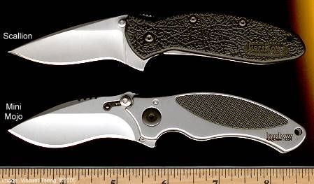

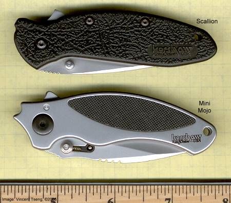

The Mini Mojo is about the size of the existing Scallion
Like the later Onion Speed-Safe folders the Mini Mojo has an Index-Open, or flipper.

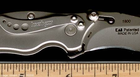

There are thumbstuds which are double sided -
BUT you can't open the knife with them.
They are actually spring loaded and are used to lock the knife open - the "Stud-Lock".
The stud slides in the open groove cut into the blade and when the blade is opened the stud fits into the curved notch on the handle.
To unlock the blade simply pull the studs slightly up and out toward the blade tip and the Stud-Lock unlatches from the locked position.. Since the stud acts as the lock - and no longer the stop-pin - the Mini Mojo has a conventional stop pin.

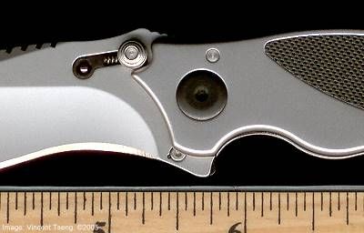

The big PLUS for me is the very innovative automatic safety - I was operating the Mini Mojo without realizing there was a safety employed - until it was brought to my attention.
Look very carefully at the photo - there is a very slight protrusion on the flipper -
the other side reveals this fully -
- it is a black colored steel plate that needs to be lifted to unlatch the safety otherwis ethe blade cannot be opened.
The clever bit is the safety's profile - the way it's shaped - when using the Index-Open or flipper in the conventional way one's finger automatically lifts this safety and the operation of the flipper is almost as if there was no safety mechanism.
Yet pushing or knocking the flipper without lifting the safety the blade just will not budge.
I am very, very impressed with this added safety feature - that does not seem to hinder or detract from the instant accessibility of the Onion Speed-Safe knives.
It's pretty obvious that the Mini-Mojo's 2 3/8" 440A blade has a much more pronounced recurve shape, which is supposed to give more power to cutting slicing - but some may consider this harder to maintain/sharpen.

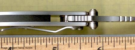

One of the major and important points that make the Speed-Safe assisted opeing knife legal and NOT a "switch-blade" or "automatic" is that it requires physically/manually moving the blade out of the handle before any (spring) assistance takes place.
On my Leeks (and I have 3) they require more than about 15degs of movement/extraction before the torsion spring even kicks in -
that's quite a lot of movement.
Here's a photo showing the amount of stand-off of all 3 of my Leeks, to show how much the blade actually has to be moved before the torsion spring kicks in.
Having said that - safety with knives is paramount and I agree one should always err on the side of safety.
I am not advocating any unsafe practices -
just wanted to show that in my (limited) experience the Speed-Safe mechanism using the index-open (flipper) is not really that "twitchy", and it actually takes quite deliberate effort to open the knife.
The fact that Speed-Safe knives still can be opened easily when one wants to - only goes to show how good this design is.
