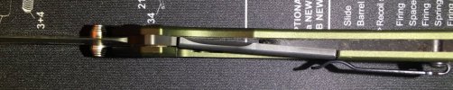

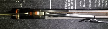

I enjoy the Kershaw Knockout quite a bit. It’s a great edc, and popular for good reason.
I have 3 of these, and have noticed that when using the knife, the lock moves all the way over. All three of mine do this (Only took pics of two).
See below:
Lock engagement after deployment:
Lock engagement after using the knife to cut; the lock bar moves all the way to the opposite scale.
B4E6A454-D6B6-4D6A-83A8-9B4373065D99.jpeg 3331CD6A-6D31-4F9A-B406-7FB6E7017ACB.jpeg
This kinda makes me wonder if this a design flaw. If the lock bar is already this far over, how much longer will the lock last without play?
Or is this just inherent to the design? Has anyone else noticed this?
At any rate, I’m going to keep using them. I suppose eventually I’m going to find out how long these will last.

That's how CHRIS REEVES likes his knives,Cannot be all bad.
Alot of my zt's do this too. Its because zt has poor lock geometry. Same with some Kershaws. It sucks for enthusiasts but most normals don't care.
Some ZT's will be pushed with thumb pressure all the way over, I've seen others of the same model I can't push over. Many of my framelocks of other brands seem to not move at all, or not very much. It depends on how the locking surfaces are fitted. Here is a ZT 0452cf, I had that was one of the worst, I replaced it with a G-10 0452 that will not move over when pushed.
doesn't seem normal to me moving all the way over. sure harder cutting will deeper seat many frame locks and liner locks. ones that bottom out arent right imho
not sure theyll fail since they are moving the proper direction into lock not unlock but not sure I'd trust them completely. that's too much movement to me while cutting. I'd send them in and see what Kershaw has to say. maybe it is normal? sure doesnt seem like it though.
This seems to be a common issue with ZT knives, particularly with their sub frame lock knives. Probably poor lock geometry, which seems to be a common KAI problem. If you try to force the blade closed with static pressure while it's locked open, does the lockbar shift in any way?
Part of me also wonders if this is due in some way to the relatively low handle stiffness and low stiffness of the joint between the lock bar and scales on sub frame locks.
I tend to agree. This seems pretty excessive. For now...even when lockup moves all the way to 100 percent, all three knives do not exhibit any rock. I guess time will tell if they fail...
The face of the lock is also coated... I'm wondering if this compounded the issue with the interface between the blade stop and lock face?
