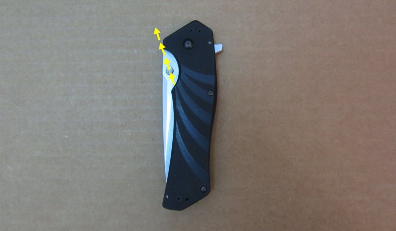

Push in the direction of the steps not across them. They are angled to guide you in the right direction not to wreck your thumbs.

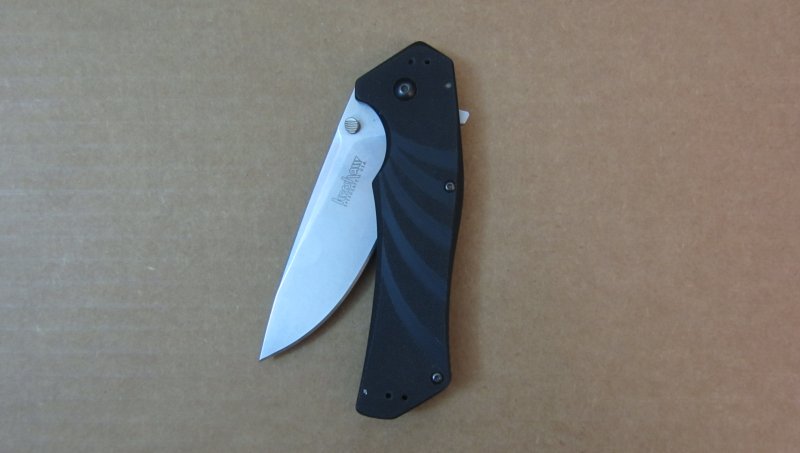

^^^^ This. Push in this direction like so:
And when it gets to about this point, the Speedsafe torsion bar should kick the blade open the rest of the way:

Sounds good, I will give this a whirl. Its possible I did the most damage to my thumbs trying to open it by pushing 45 degrees to other side of how they are angled (based on the orientation in the pictures, straight up and straight left).
