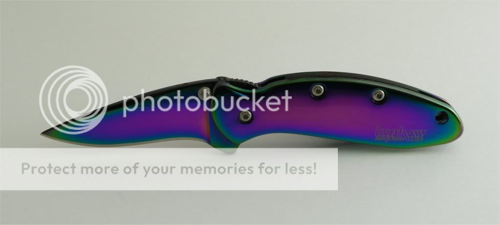

These are the best photos I've been able to make to show what it looks like without "seeing" it for yourself in person.
