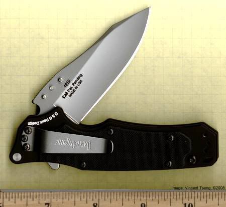

size open -
size closed -

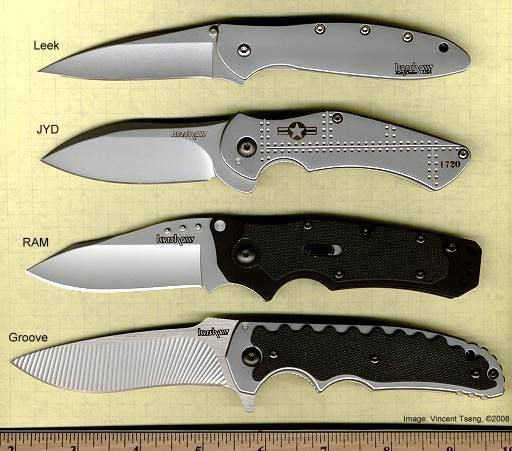

The RAM is between the JYD and Groove, and feels much bigger than the very slim Leek.

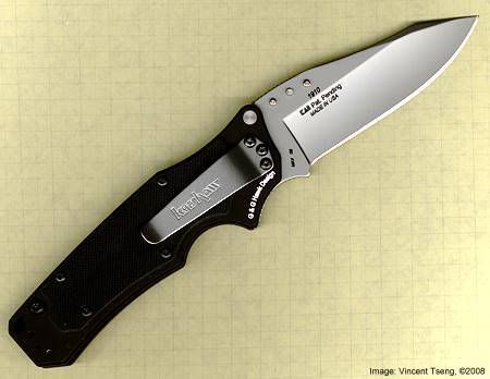

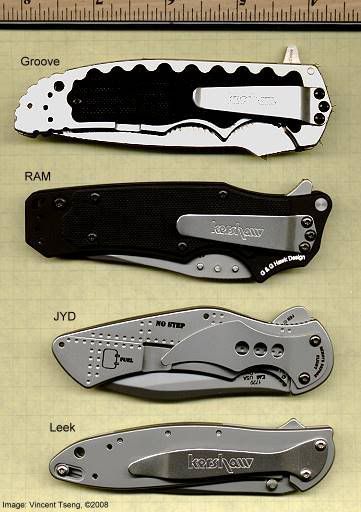

The clip looks the same/similar to the one on the Groove - mine came attached for tip up carry - I move it for tip down carry like my other Kershaw flippers.
The flipper is closer to the Groove style - but it is set so that it is mechanically more efficient.
However a note about the flipper action - if one is used to the previous Kershaw flippers and use the finger tip opening technique - occassionally I found I could not even budge the flipper - almost like it was locked closed.
This obviously was NOT the case - it was my technique - using a more obique angle approach - almost half way between straight on finger tip, and at right angles like pulling a trigger (so the orientation is closer to 45degs) then the flipper works astonishingly well.

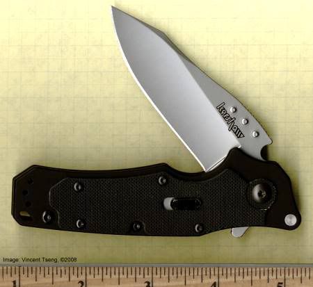

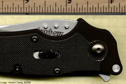

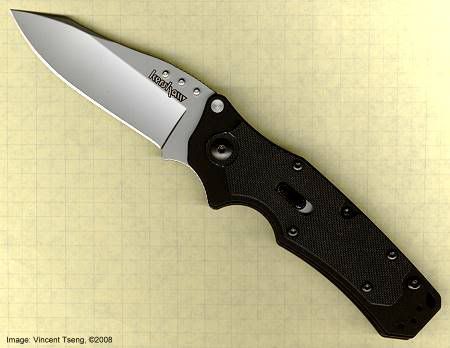

lock lever -
my thumb sometimes rests on the lock lever when opening the flipper
this is not a good thing as one might prevent the lever from moving freely and may foul the opening - I had to re-train myself to keep the thumb clear of the lever.
Sliding back the lever unlocks the blade. Some like the fact one's digits are away from the handle opening so the closing is safer.
There are stylish studs that are actually very effective for manual one-handed opening of the blade- and there is a very substantial stop pin - more like a post.
My sample is still made with Sandvik 13C26 - Kershaw are migrating to Sandvik 14C28N - an exclusive based on 13C26.
The blade also is very well profiled like I observed on a recent 13C26 Leek blade - the hollow grind is much thinner by feel and does not widen too much toward the edge - this is a very good thing - and makes the cut through better than the original Leeks.
I liked this knife a lot - for both the lock and the very positive and effective flipper - the opening is even more astonishing than the previous Kershaw flippers and this is saying a lot - a very impressive knife.
