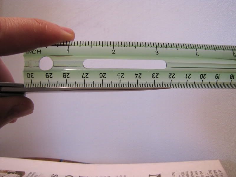

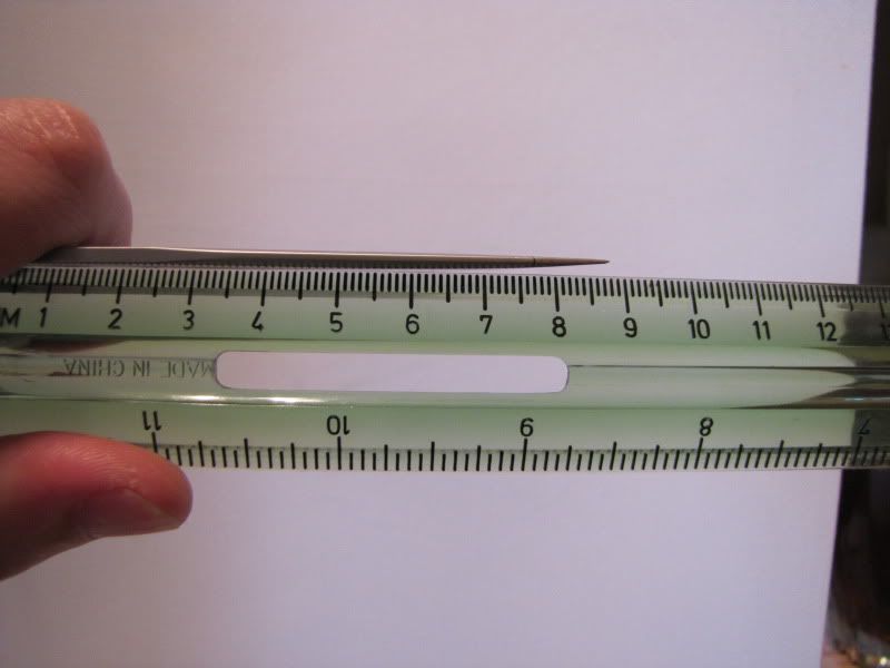

I bought my CB Shallot 5-6 weeks ago on the secondary market, but NIB. I use my knives and I love to use my Kershaws, so I used my Shallot to test the ZDP-189 steel. Pretty soon I started to notice that the blade touched the left, non-locking liner when I closed it. The A/O worked just fine so I didn't expect it to be any great issue.
Two days I played around with my Shallot, when I saw that the whole knife itself seemed to be bent as I looked down on it. I took a closer look, put it on a flat surface and my eyes proved to be right. My Shallot is bent and I was shocked.
To give you an impression how it is bend.
Imagine you take the knife in your hands, pivot part in your left hand, the lanyard part in your right and try to bend/break the using your thumbs pushing the knife away from you: That's how my Shallot is bent.
After some years as a knifeknut I was surprised as I've never seen anything like this before. I don't mind if a production blade has minor flaws that I can fix myself but this is impossible here. So how could both liners be bent in the first place? I'd so glad if somebody here could give me an explanation, maybe somebody else has experienced anything like this.
And most importantly: Can it be fixed??
I hope you can understand how I feel, the Shallot feels like a car damaged in an accident every time I close it and it's one of my favorite "cars". :(

Will it show in pictures?
Oh yes it does. I hope it also does in my pics...

This the spot where the blade touches the liner. The other pics just show how far the liners are bent. I hope it helps...
Looks to have a bit of a swag in it.... I still say, send it in to CS. Thay'll get you fixed up. :thumbup:
Looks like someone tried to center the blade gangsta style. There's no way those two liners came out of a random batch of liners at the factory and put together like that. I've seen people in the past post rotten techniques for centering a blade. In this case, lay a towel on the edge of a counter top and push with all ya got. :thumbdn:
