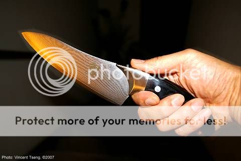

Change of background to show the handle shape.
This knife looks stunning to me.
The Damascus steel is very well defined - VG-10 core surrounded each side by 16-layers of SUS410 stainless steel.
Handle is black Pakkawood - 3/4 exposed tang on the spine side with two rivets.
It is very well shaped and fits my hand well - with the blade edge dropping below my knuckles.
Overall feel is very good with the balance just a fraction forward of where my index finger fits - so it's just a tiny bit blade heavy - which is the way I like it.

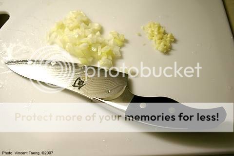

The blade doesn't just look good it is very sharp - push cuts newspaper easily - right out of the box - better than my oft used Chicago Cutlery Walnut 62S 5" utility knife. Matches the very sharp 3" Victorinox paring knife and my $300+ custom David Boye BDS 6" Chef's knife.
So the edge is very fine - one can hardly see the edge bevel - I would have said it had a "zero-bevel" - except for closer examination under a good magnifying glass - one can just see a "micro" edge bevel.
Just for comparison this bevel is so fine that it's less than the bevel usually found on Opinels when examined closely - and most people would say that Opinels have zero-edge bevels including the official Opinel site.
This means that the blade is ground very thin toward the edge - and it feels thin (pinching the blade and pulling toward the edge).
Although the blade is thin - it is by no means lite-weight - the knife and blade has some heft to it.
Which makes this 6" chef's knife a good combination of for reasonable heavy cutting - yet fine enough for precision cutting. One can of course look at it another way as a "compromise" between a Chef's knife and a vegetable knife. I like this combination/compromise.
mincing garlic and dicing onions -
