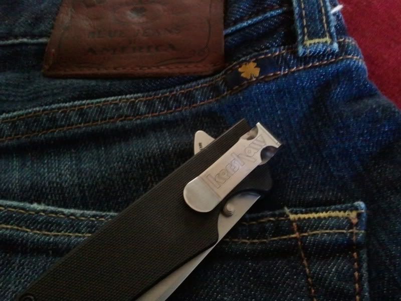

been looking to pick up a skyline. the only thing stopping me is that terrible clip. i want to carry tip up without what looks like almost a full inch out of my pocket. please help and recommend a mod or alternative clip!

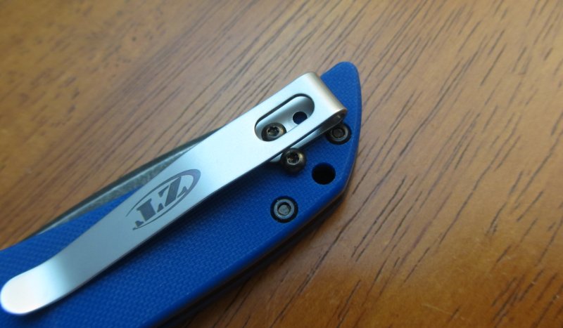

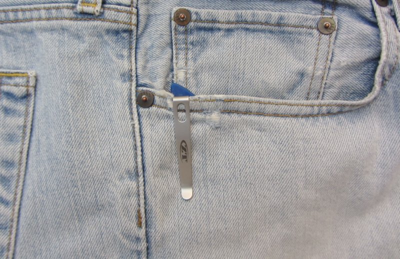

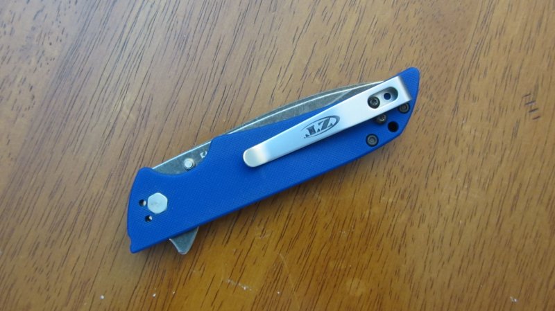

As ericzhao517 pointed out, the ZT 0560 clip (or 0550 2nd gen clip) will fit without any mods. The second screw just crimps down on the edge of the clip to keep it from rotating. It's reasonably stable, but if you can still twist the clip if you apply enough force (the second screw is just pinching the edge of the clip rather than actually being threaded through it after all).
