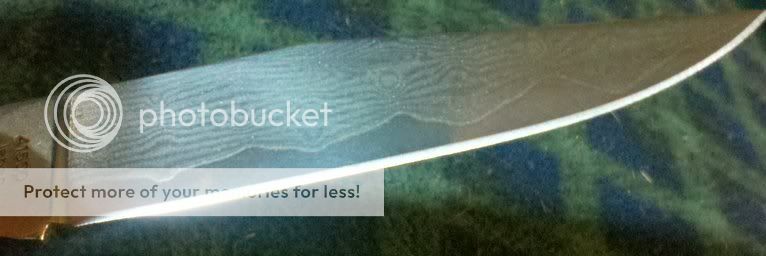

So I just ordered one of these beauites, I was just wondering what the steel was actually made of so far as the chemical composition, or like, what the different steels "layered" together are. Can't wait to get it, got a GREAT deal on it, look around if you've wanted one.
It's not Damascus technically; it's a VG-1 core that is pattern welded in alternating stainless then acid etched. Thomas corrected me recently on this, and upon close inspection it shows. Crazy sharp knife, great whittler.
Hmm, interesting. Any specs on the hardness? I think I notice a little dent in the blade from when they tested the hardness.
Also, with that being said, it showed up in the mail today. I'm very impressed and very happy.
Well for the vg-1 core, a 58-60 hardness is a reasonable expectation from kershaw. As for the damascus pattern itself, not a clue
The other metal is probably 420j steel, a flexible steel usually used in the liners of pocket knives.
I'm just guessing because the Shun series of knives made by KIA (The parent company of Kershaw and Shun and ZT) have kitchen knives which utilize a vg-10 core and 420j as the outside layers.
And just so you know, the proper term for this type of blade welding is called san mia, it is where a hard center steel has softer iron/low carbon steels welded to the outside of it to increase flexability of the blade while still keeping a high rockwell hardness on the cutting edge of the knife.

I see, I was going to say it looked kind of similar to some of their composite blades, but a little more subtle.

That's what I was thinking as well, seemed closer to the hard side. Loving this knife so far.
Here's the composition of VG-1 and 420J respectively. :)
