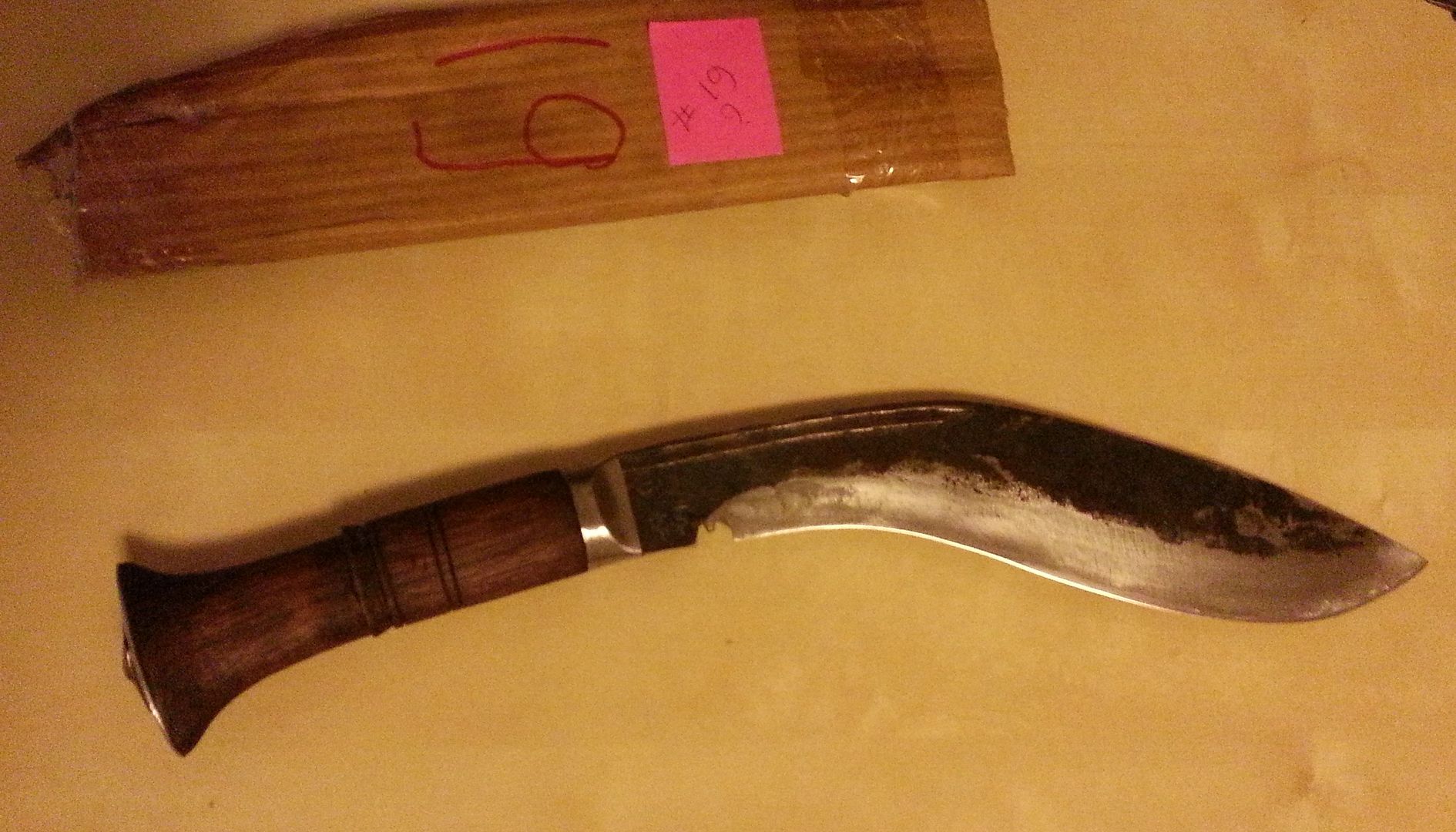

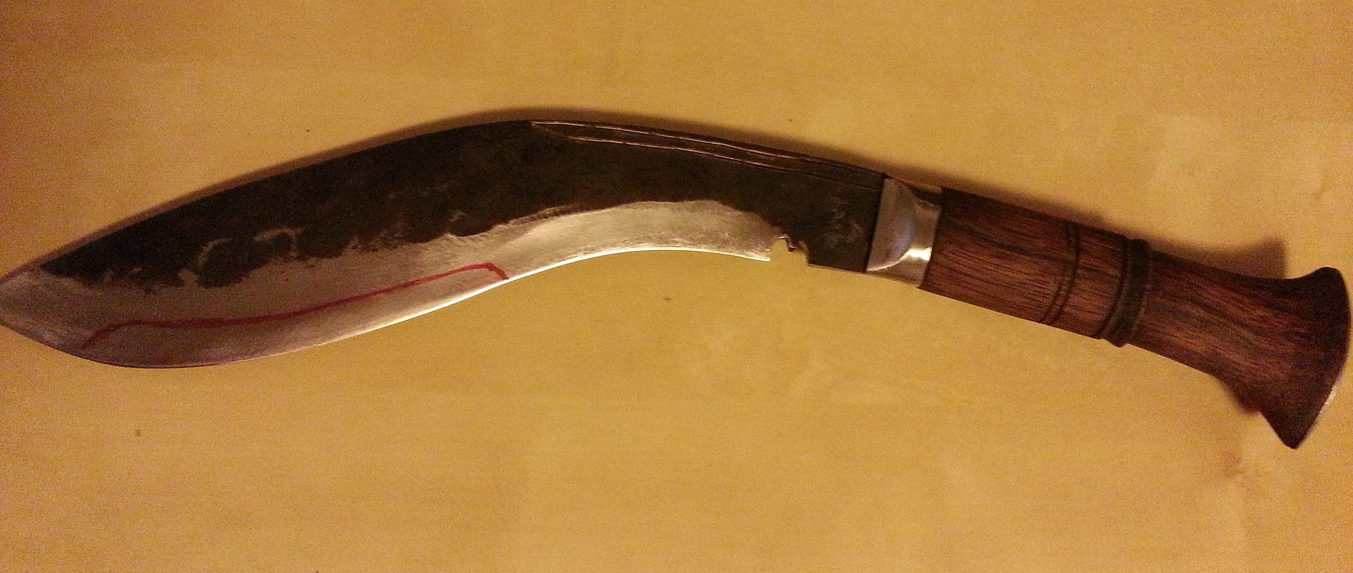

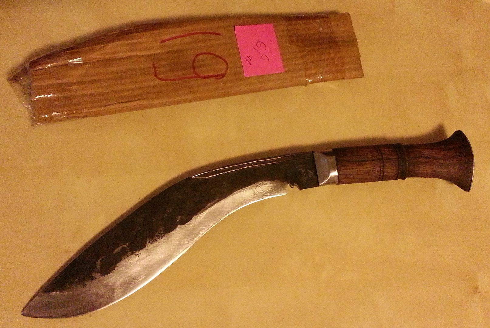

Sweet work dude. I got #19 and am in the process of fixing it up as well.
The handle had a pretty sizeable crack in it, but i sanded it down and used the sandings plus some wood glue to fill it in - almost looks just part of the grain now. Still needs more sanding and coats of BLO though. Also, I'm keeping the black forge scale on because this will definitely be a user and I like the look of it. I did go ahead and use a file to widen out the bevel, thinning the profile of the blade even more:
Lastly, the really cool thing was that while I was thinning out the bevel, I noticed that I couldn't get the fairly new Nicholson double cut file to catch very well on this whole area - just ended up skating. Had to bust out my diamond stones and ceramic rod to get the edge where I wanted it. Pretty much just means that the blade is well tempered and this whole area is probably 58+ hrc
Gotta say, these KLVUKS are very well put together and make for great projects! I'll be making a leather sheath for mine at some point - probably with an attachment loop for a ceramic rod.
