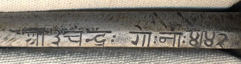

These are the markings on the spine of a Khukri I recieved in the mail today. Purchased from Atlanta Cutlery, it's one of the "WWII Vintage" models that supposedly came from the armory buyout in Nepal.
I'm hoping that these markings will be a clue as to where the Khukri was made, by who, or where it was used.
Yes, I know there's a 50/50 chance that my scan is upside down. Just say the word and I'll switch 'er round.

Hello Bob,
Well thats older than WW2! Its an old Nepali army kukri, the scan is upside down but the part currently on the right of the screen says Shree 3 Chandra, Which is an honorific greeting 3 times over to The Prime minister of Nepal up untill 1928.
The writing on the left of the moniter, will usualy give a soldiers nickname & number.

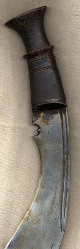

Here's a scan of the Khukri handle and kaura. There are no other marking on the Khukri itself other than what I've scanned above. The handle is wood.
As you can see in the scan, the edge is in very good condition.

I cant tell much from only seeing half a kukri about its shape! But thanks for trying.
Which ww2 style did you buy it as? either way you got it cheap as its older.
It says "Shree 3 Chandra _____________ " " 4/42"
i dont know the words i marked as " ".

That's an old kukri, I can tell you that. Shree 3 (tin) means really old. Nepal's current King gets Shree 5 (panch). So just guess yourself how old this kukri might be.

Shree 3 Chandra, is the honorific for prime minster Chandra, 1902 t0 1928.
All Nepali Prime ministers are & always have been since 1902, shree 3, all Nepali Kings have been Shree 5 for many generations.

the bit spiral didn't translate is: goH naaH
which is very odd, since these often look like they could be soldier's personal names/nicknames (spiral and I have discussed this at ikrhs.com ).
But this looks like Sanskrit, especially with the :'s (which I've transliterated as H's): in Sanskrit this bit goH naaH would translate as our cow.....
the mystery deepens...

Nepali writing on spine are shree three (tin) chandra ga na 4/42 this is an old Khukuri. I have one in my collection but mine is Samsher model.

There's a little o-maatraa (little wavy thing) above the 'ga' though, which makes me think it's goH, not gaa.
The 'nickname' on yours [=Yangdu's] seems to be vaTe - does this sound like a Nepali name??
Generally:
Revision on my previous statement, thinking about it, actually naaH can't be Sanskrit 'our', since that would be naH.
Perhaps it's an unusual abbreviation system (with the : instead of the usual 'open greek comma' i.e. little circle) and it simply stands for a name, e.g. 'Gopal Naaraayan'.
--B.
