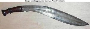

this one:
attachment.php
How about we start off with a Swiss Army Knife :D
How long is that Hanshee? It looks huge. :)
Personally I'd like to see something that is unlike anything else that's already been made. Although both of the previous pics cause salivation. :p
I like the Hanshee best. To me it looks like a forward curving Sirupati*drools*:)
