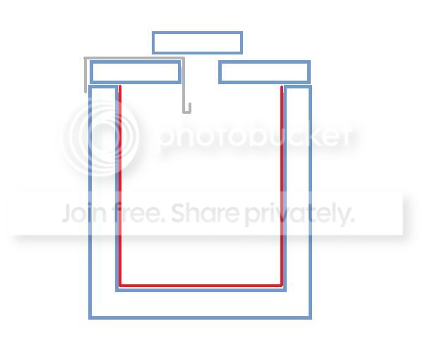

You can easily add PID control for less than $100. You can cut a 75mm hole in the center of the lid and make a fire brick cover/plug for it. Lower the blades into the chamber ,suspended on a 3mm stainless wire hook. It will work well.
The hooks are hard to describe in words, but here goes:
The wire has a small "J" on one end to hook the blade tang hole on. There is a 90 degree bend at a distance from the "J" that the blade will hang free in the oven...probably about 100-150mm .The wire goes out from that bend , across the top to the side of the kiln, and then bends down along the side for about 200-300mm. you can put a wooden handle on the wire, or just bend a loop in the end to grab it with. This will allow several wires to sit around the side of the hole with the plug in place. You can lift a wire and quench the dangling blade safely and easily....then move to the next blade.
Hey Stacy, cool idea. I may co-opt that one. That way, like you say, you could have a fair little batch of blades in there and quench all of them without wasting a lot of heat or time.
Yes exactly. Make the outside down part longer with a grip loop or handle to counterbalance the weight of the blade. A slightly tapered soft brick plug can actually plug the hole during soak. A cover brick like you drew can be used when you are quenching.
