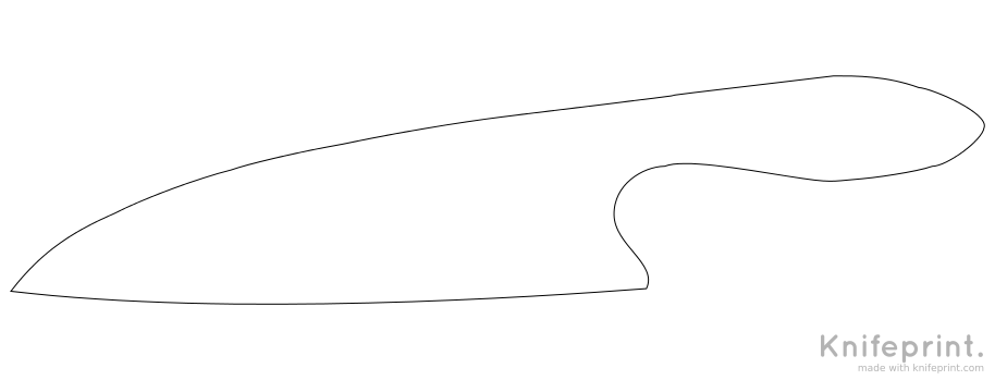

I am working my first kitchen knife design and am going for a fairly generalist blade. Here is the first draft of my design, any suggestions for how i could improve it.
Yes, but my being relatively inexperienced with a grinder will probably end up making it slightly curved whether i want to or not.
Add a slight curve to the blade edge.
Loose the pointed butt and make it round.
Don't add any drop to the handle. It should follow t he rise of the spine.
When completely done, add a small flat facet to the pointed heel.

Thanks for the tips here is a slightly modified version based on your advice.
First drawing for sure. You could add a little more belly towards the tip. My general rule of thumb is the first 1/4 of the cutting edge from the heel is flat, or relatively flat. So an 8” cutting edge would have somewhere near a 2” lining flat at the heel. The handle doesn’t look very comfortable to me but that’s more preference I think. The pic below you can see what I’m talking about. You want a little rocking action but you also don’t want to have to raise the handle 10” off the board to use the tip. Just play around with some designs. It doesn’t take much to change the way a knife responds when using it.

I loosely based the first knife off of the knife I use the most in the kitchen, giving it a bit more of a tip and slightly different handle orientation and shape.
No snark intended but you might look at classic patterns from Wusthof, Henckels or Sabatier to see what has worked for centuries.
Not sure if this was in reference to my last post, but no snark taken, and right back at ya! Because if you talk to chefs who use knives every day, they all want some curve that comes to a stop at the heel, but not a hard stop that a flat spot would give. I have yet to have one ask for a flat heel.

I realize that my description may have been (or may be) lacking. What I've been told (in summary) is that when chopping or mincing veggies with a pinch grip, keeping the tip on the board and just using the heel half of the blade, folks like to feel the heel hit the board and not fully rock (the "stop" I mentioned above), but when you look down the edge, you shouldn't see any flat spots (or, heaven forbid, any concavity that can happen with poor sharpening technique) on the blade.
