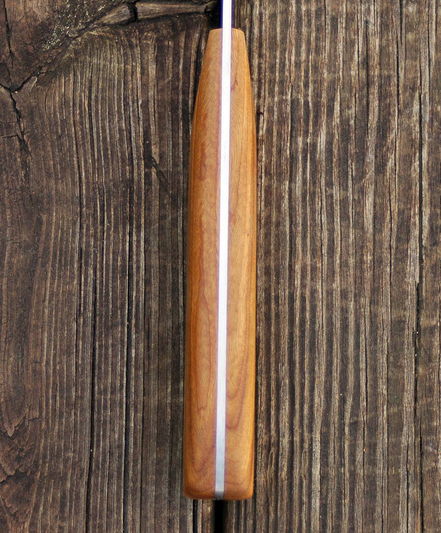

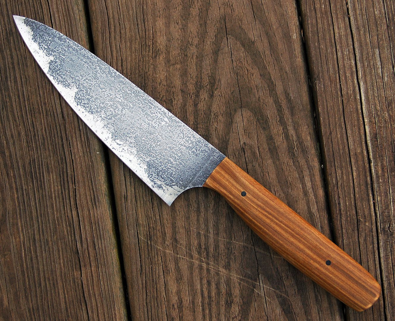

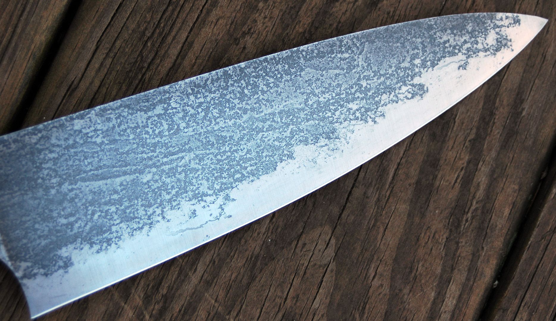

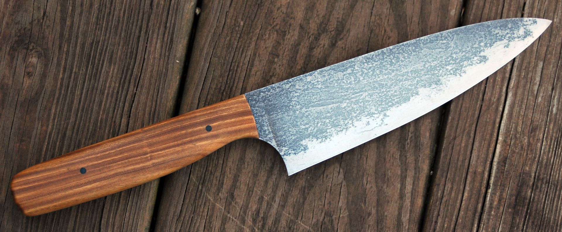

I finally got around to doing the handle on this thing. For my first one I think it turned out pretty sweet!
Aldos 1095 3/32" FFG
6 1/2" blade, 12" OAL
Argentine Lignum Vitae scales
165.00 shipped
Thanks guys! I got yours almost done too Mykel! That sucks btw.

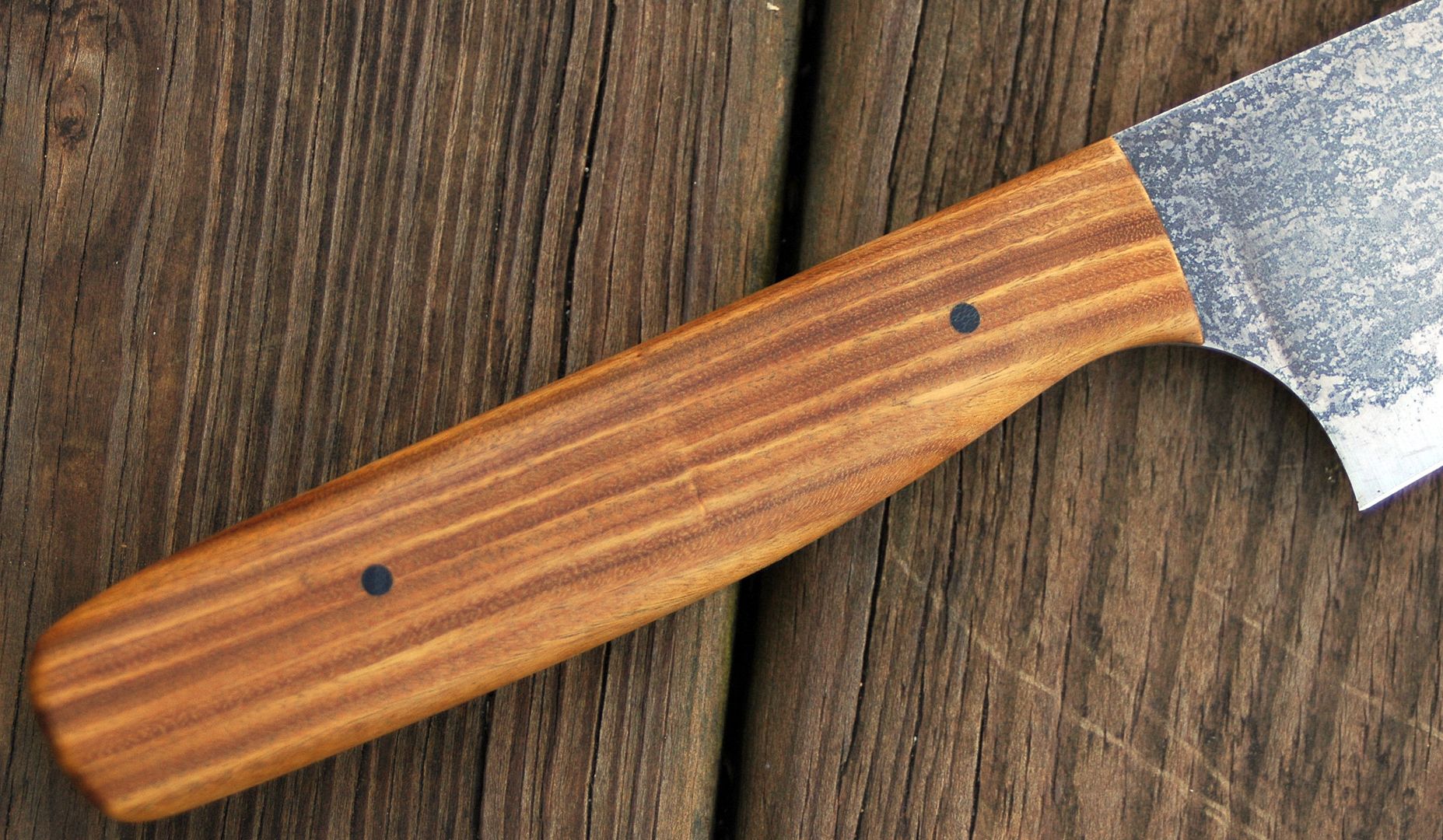

Very nice. What is the circumference of the handle at it's widest point and it's narrowest point? How wide is the blade near the ricasso? Has the wood been treated at all?
Hey man,
The handle is .77 thick at its widest and is .39 at the ricasso.
Its 1.09 wide at the widest and .85 at the choil
The blade is 1.88 wide at the ricasso
The handle has been treated with oil, buffed and waxed. Lignum is extremely dense so it didn't take much oil.
