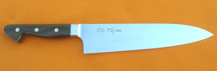

Listen to what Mr. Burke has to say, seriously. First thing you need to do is eliminate that downward curving handle, it just doesn't make sense. Traditional japanese knife work does not employ much rock chopping so you could flatten that profile a bit more and make that profile better. I personally am not a fan of any gyuto's below 210mm, but then again my kitchen is of "average" size so go with the length that you think will work best.

I think you're on the right track now, you just need to fine tune it a bit more. For example where the handle starts, you need to trim that area to increase knuckle clearance. Here's the profile of a Shigefusa gyuto, which happens to be one of my favorites. Notice how the handle doesn't curve down towards the edge, again there's no need for this.
