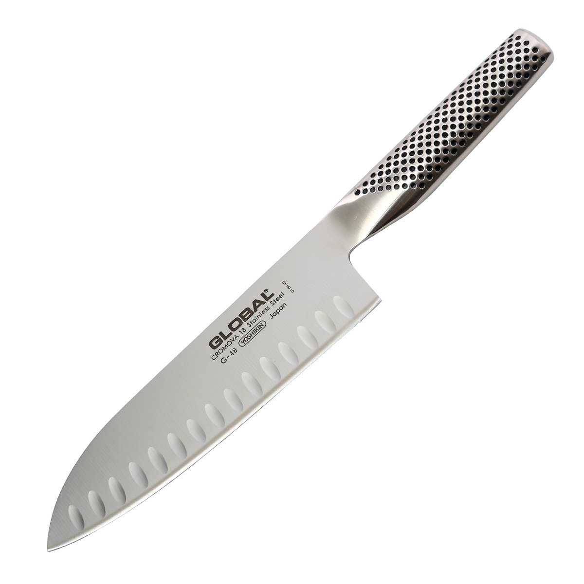

Kitchen knife with a full tang hollow handle?
I imagine they start with a piece of tube and forge it to shape over a mandrel. weld up one end and then weld the other to the blade.

The short answer is that without a factory, an individual can't really make a handle like that.
If you were dead set on doing it, the only way would be to start with a round bar of 440-C and drill/mill out the handle hollow. After that you would mill the blade from the rest of the bar. The fancy divots would also be milled in. All this would best be done with a 3-D milling machine. From there you would have to grind and finish the knife.
When all was done you would have many, many hours work and a fair bit of cost to make a $100 knife.
Those are just divots in the handle? Not holes thru to the inside to collect crud?

get some stainless pipe, forge it down to the handle dimension you wan
via stock removal make a blade from *stainless with a 1" stubb tang
Tig weld the forged pipe to the blade making a nice fillet weld that can be dressed off smooth afterwards
*stainless - you will NEED to do some research as to which stainless you can properly Tig weld, what filler rod you can use, how the HAF will work with the finished knife, etc.
the handles are cast in one piece the cleaned up they are then tig welded to a blade that has been ground and the blade is then harden in a argon atmosphere to avoid scaling
Cut out a flat piece of steel, blade shape as is and in the handle make a big flat drawn out trapezoid shape. Then heat and beat to roll that trapezoid into a handle. Like rolling up a piece of paper... Then tig the seams on the bottom and top with appropriate filler rod and weld in a filler at the back. Would be all one piece but hollow in the handle.

From what I have heard the Global knives are made in three pieces, the handle with two halves and the blade .The three then welded together .The problem with them is that unless the welds are perfect ,the three pieces will eventually come apart ! To make such a knife as a custom piece would be a big project ! Chris Reeve solved the problem by machining the whole knife out of a solid block of A2 and got the only good hollow handle knife !!
This is the process Global uses as they tell you anyway. Then each handle is filled with sand to make it a Neutral balance at the index finger position.
