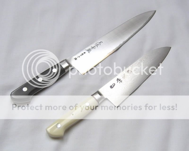

The most used knives on my kitchen are Spydercos. I was able to buy few nice utility knives, which are discontinued. Now available Yang (PE, VG10, 6 "). This is my wife's favorite knife, it is about $45, great deal for this nice pieces of culery with 6" VG10 blade and nice birchwood handle. Also you can get Yin, it is the same size, but SE and black ebony handle.
Want to get Hattory Gyuto...........
