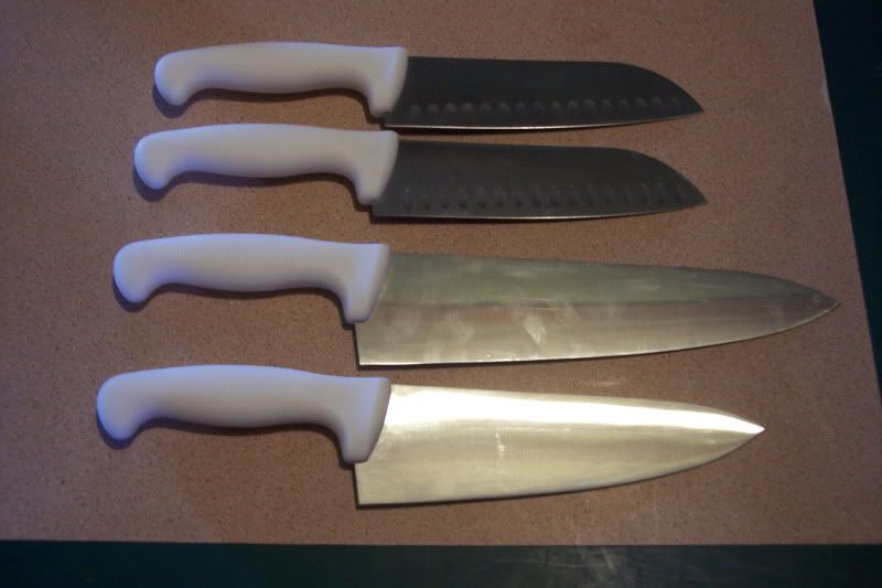

A Group shot:

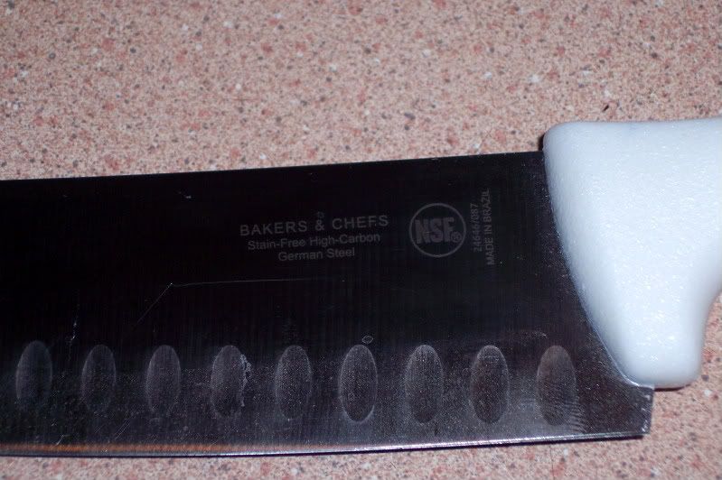

Closeup of the etch:
A brief search for a maker turns up Mundial as the likely culprit. At least they look like these:
Coming out of the package the two Santokus were hair shaving sharp. The 8" and 10" chefs were not. Though 8" was almost there. The blades measured .100 across the spine and taper nicely to their points.
The santokus are full flat ground with typical Grantons. The chefs both have a bit of convex grind at the edge. I'm not sure if I will keep that type of edge going.
The handles are all identical. The surface is slightly pebbled for a better grip when your fingers get slippery. They are over molded for a hidden tang. I have no idea how far back the tang extends into the handle. But they are tight and I don't intend to baton through any lumber. So they should be fine for normal kitchen work. The handles are plenty generous for even the largest hands. The downside to these grips is that they don't allow an easy pinch grip on the blade. It can be done, but it feels awkward to me. Though there are two generous divots at bolster that can be used for a pinch grip.
So, how do they work on the board? Amazingly well thank you. After almost 4 months of daily use in my kitchen, I have yet to sharpen the santukos. I just simply steel and go. I did have to touch up the chefs out of the package. But once sharpened they are holding up well also. I've sliced and diced through carrots, celery, onions, and various large hunks of beast and some not so large beasts. Of the 4 knives, I like and get the most use out of the santukos and the 8" chef. The 10" is a beast but I find it more than a bit too large for day to day kitchen work. Though it works great on cutting those steaks out of a big sirloin tip or breaking down those Boston butts into roasts and fresh pork steaks. Still, I don't use it all that much.

Too bad the dimples don't reach the edge where they'd do some good!
Thanks for the review, I might have to go have a look at my walmart and see what they have
Two things about the "dimples": they are there to allow air to get behind the food being sliced to reduce sticking to the blade, they're not supposed to be serrations. Also, an engineer (toooj) once told me that when those 'granton grooves' get too close to the edge, they tend to cause stress risers in the steel.

Oh NTS you thought I meant the grantons were supposed to be serrations? No my friend, I know the difference. Actually I don't really go for serrated blades myself, closest thing I have is one artfully scalloped bread knife...I do have a few blades with grantons though, but I like to call them dimples. That way most people know what I'm talking about when I point and say "hey look at those dimples"... "Grantons" usually just brings a confused look lol
I've read in a couple of books that grantons don't do what they're supposed to do, which is to reduce drag, unless they go to the edge. I notice on my tsuchime knives, and my knives with grantons that don't go all the way to the edge, that the food sticks just the same as on a plain blade. Maybe they slice with somewhat less effort though. This could be just my technique, I admit.
But with my santokus and my slicer which do have grantons that go all the way to the edge, the food tends to fall away a little better and friction is definitely reduced to some degree.
I've also noticed that the more expensive knives with grantons seem to have them all the way to the edge, while the cheaper ones don't.
