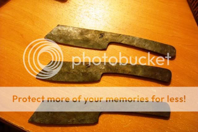

Working on a batch of herb choppers. 3 of em, handforged 1084, I should have them ground and HT'd tomorrow, and handled by next week.

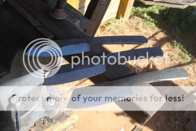

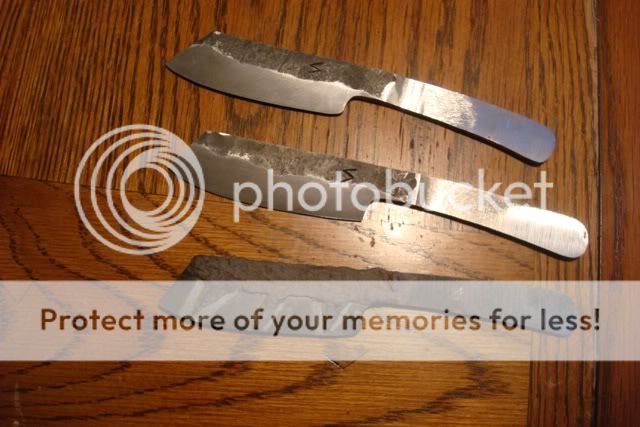

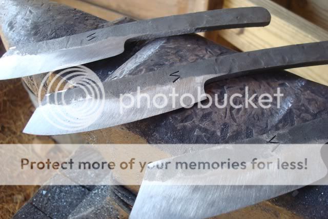

Bevels ground out
Bevels hand sanded to 120
Ready for HT (heading out to the shop to do that in a minute). Tangs ground down (the handles will extend farther than that, but I'll hand file and sand up to where I want them) and bevels sanded. The bottom one is mum's, as you can see, it's gettting some "special" treatment.

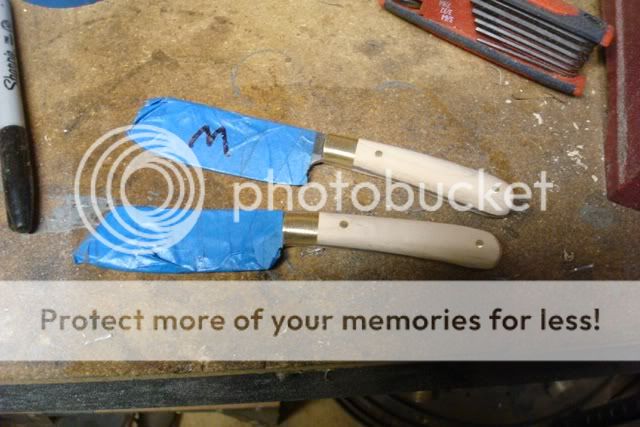

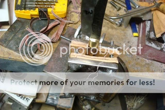

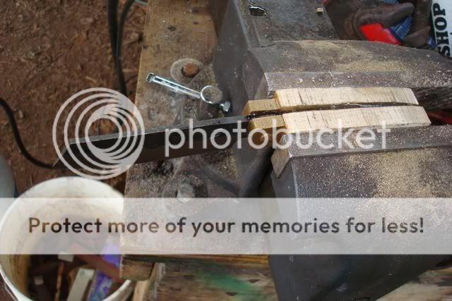

But, when I did get out to the shop, I got one the knives glued up. I'm going with brass bolsters and curly maple scales, believe it or not, this is the first time I've done bolsters on a full tang, so I'm going to shape out this handle some and see how I like it, then get the others glued depending on how this one looks.

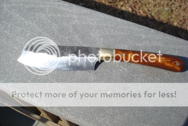

Got the first one shaped, sanded, and stained, and I like how the bolsters look (as did the mother), so mums, and the other knife will get brass bolsters.
This first one has few more touches it needs on the handle, then a good sharpening. Should be done tonight, the others will be glued today, and finished soon.

I have the other two's handle finish sanded and stained, now I'll be oiling them for about a week before I declare them done and post them for sale. In the next few days I'll be working on sharpening, and taking finished photos, as the handle oiling won't change the look of the handle.
The lower one is the first one done last week, the two uppers are the ones done today.

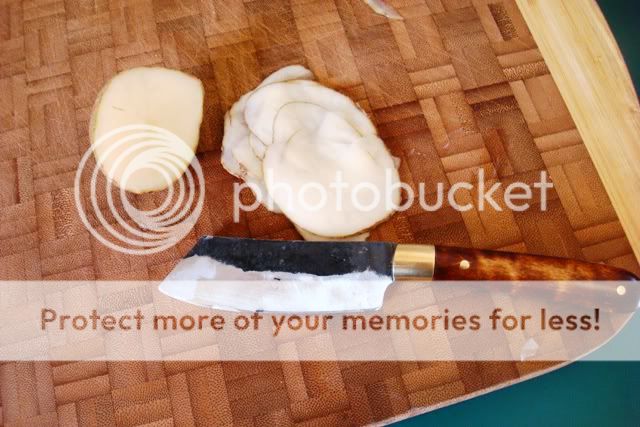

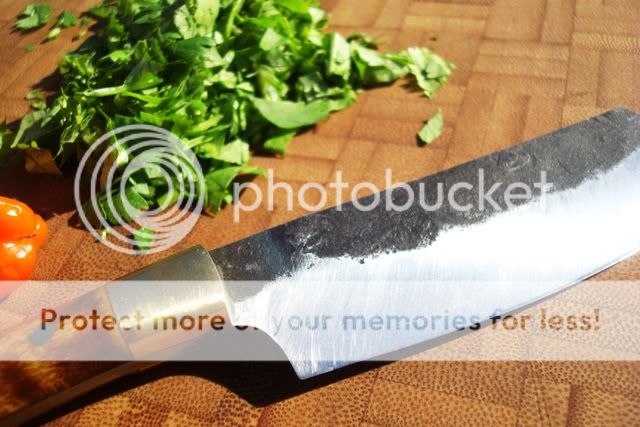

I got them all sharpened up two days ago, they're now sharp enough to shave the hair off a babys chin. And to cut see through slices of potato. I gave them all a test run, with potatoes, onions, and garlic. They slice and dice well.
Then I took them out to the shop and cleaned them up, some scratches on the front of the bolster (from sharpening I believe) touch up on the bevels, etc..

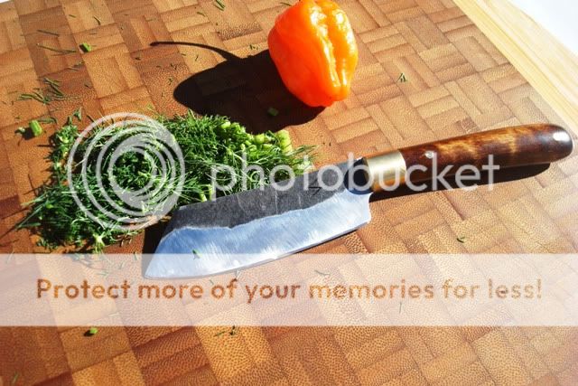

All done!

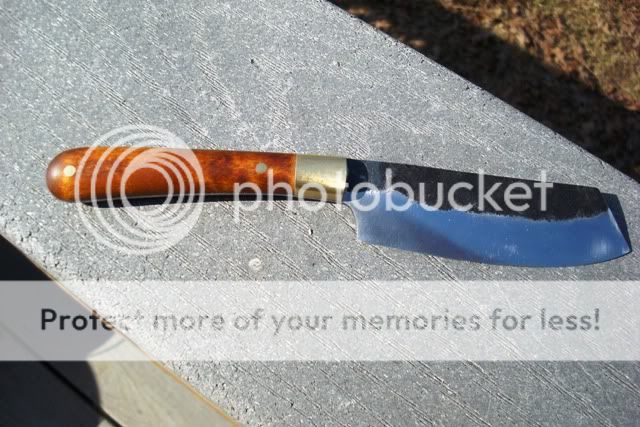

Mums in use

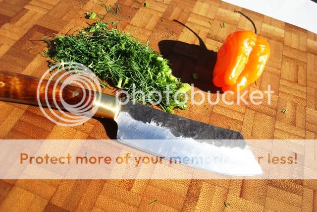

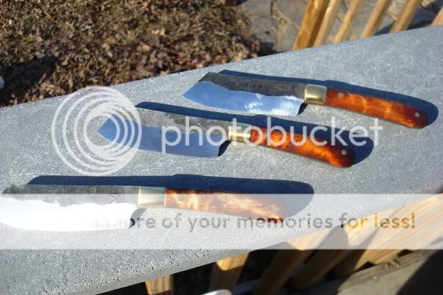

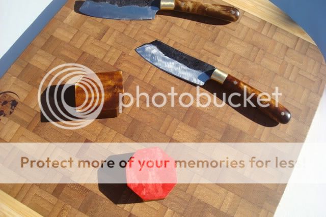

And some pretty pictures of the other two.

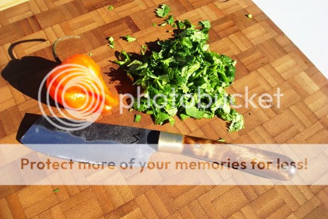

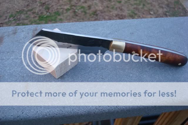

First - (and yes, the herbs were chopped with the pictured knife)
And second -

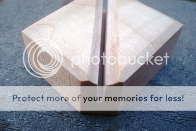

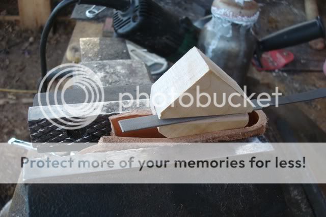

Then the accessories to be included with the knives when they're sold. A display block and a magnetic wall hanging block. Both made from curly maple to match the knives.
