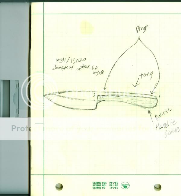

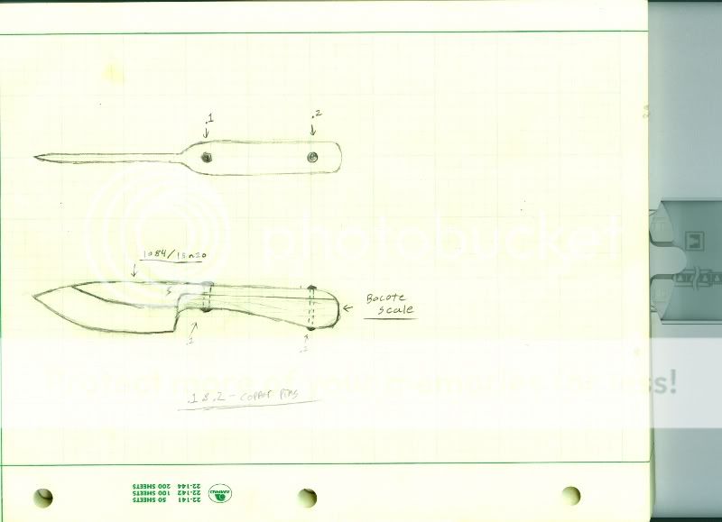

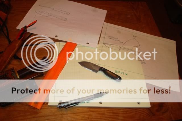

here is where I started, a rough sketch.
I did some thunkalating, drawing, measuring, and messing around.
You'll notice the knives laying around, because I wanted to make sure I got the tang width correct, I was comparing grip sizes, lengths, etc.
I ended up with a better drawing, notice the crumpled papers, I'm not the best drawer, and it does show.
The final sketch. I'm thinking 1084/15n20 for the blade, bocote for the scale, and copper for the pins.

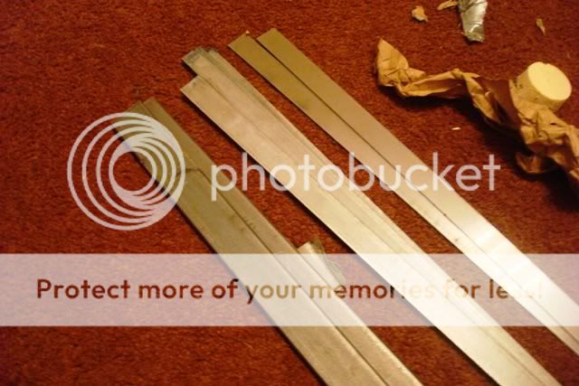

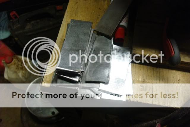

and here's the haul, 2 bars of 5160, 3 bars of 1084, and 2 bars of 15n20.

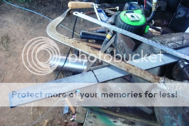

Marked, at first I was going with 5" for the length. And yeah, I'm cutting with a hacksaw, my anglegrinder cutting discs were all worn down to nubbings from my last project that required much cutting.
5 pieces of 1084 cut.
The pieces all cut and ready. I changed my mind about the length, and went with 2 1/2" for the pieces.

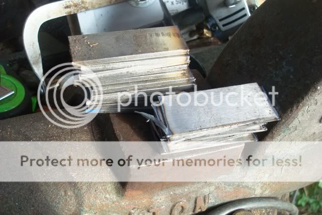

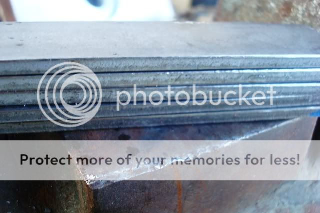

10 pieces of 1/8 x 1 x 2 1/2" 1084. and 10 pieces of 1 x 2 1/2" 15n20.
I went ahead and ground the surfaces nice and clean (shiny!).

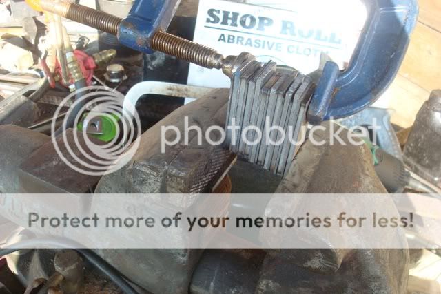

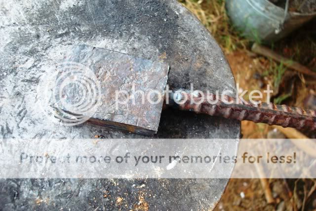

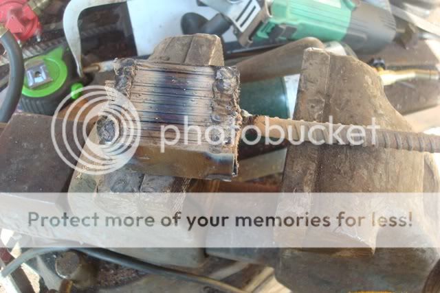

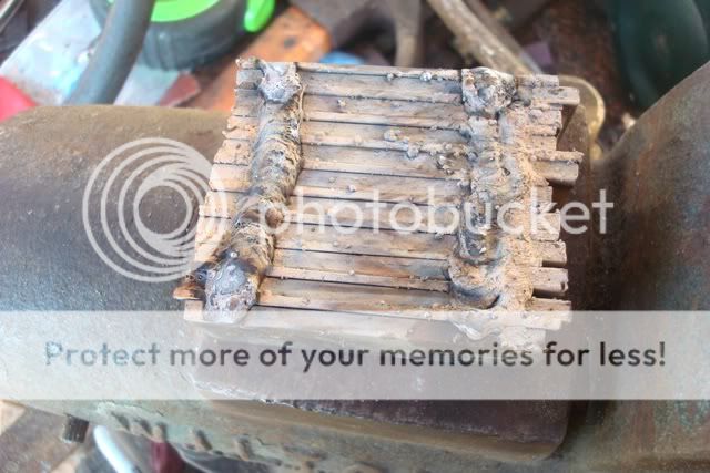

Next was making it stay so I could forge weld it together at a later point. To do that, I ran 2 mig beads across each side of the stack.
set up and ready to tack it together.
First two beads

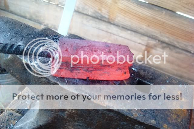

other two beads, and a rebar handle.
Doing the real welding now.
First, my secret method. The secret ingredient to good damascus (that I just made up) is an ice cold rootbeer during forging. One must also sprinkle some of the rootbeer on the fire as an offering to the welding god (is there a god of welding in any mythology? I can't think of one).
Well, the offering worked, these pics are post welding.

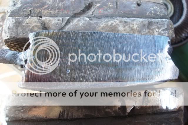

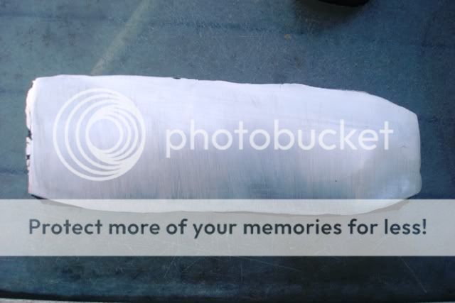

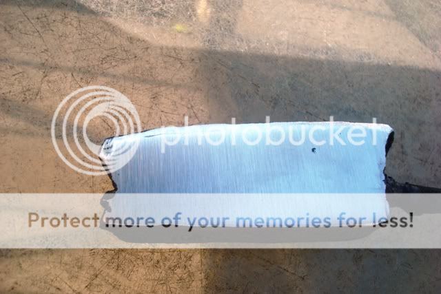

Then I forged one side of the layers flat, and ground it smooth. No obvious delams or inclusions.
Then I hit it with a worn 60 grit belt. That one spot isn't an inclusion, it's the remnants of a hammer mark I didn't want to grind out.

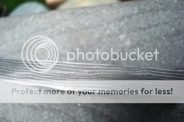

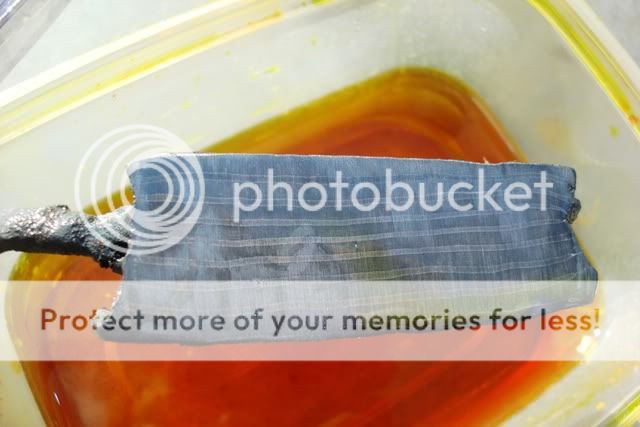

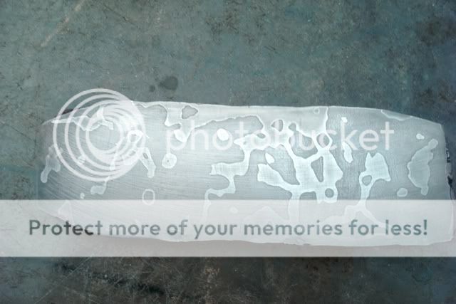

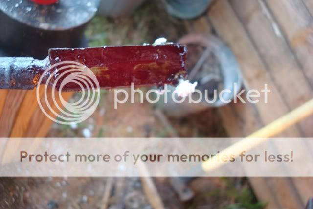

And soaked it in ferric for a minute, just to check my layers.
Layers look good, everything seems fine, so I moved on to breaking this billet down. Got my dad to hold it on the anvil, and I went at it with two handed with an 8 or 10 LB sledge. Brought it down to size in less than 10 minutes. I think it was three heats.

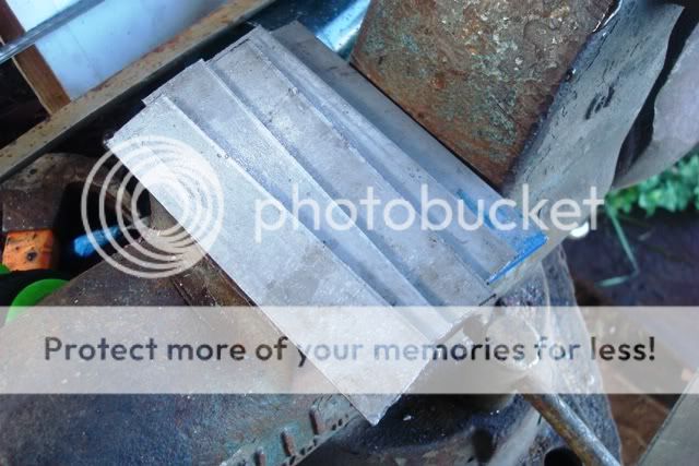

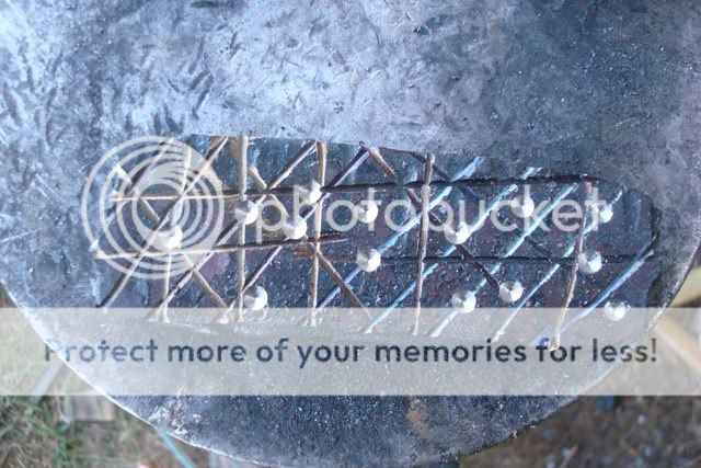

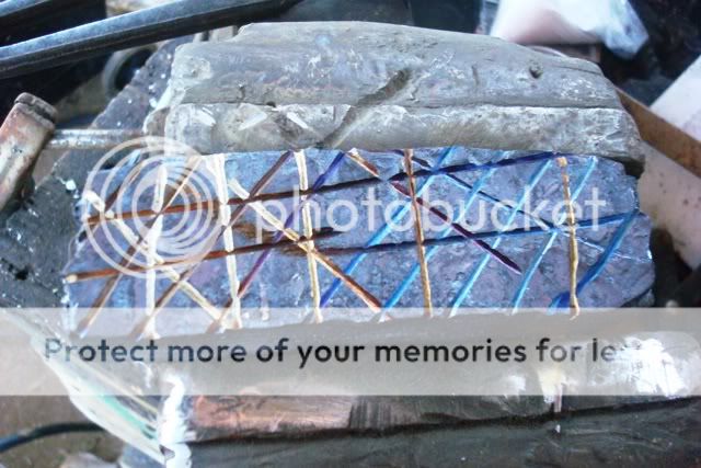

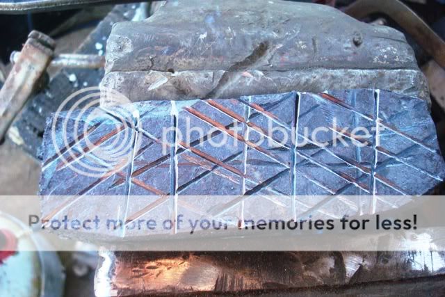

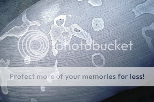

Then I decided to go ahead and disrupt the pattern. first I cut in grooves with the angle grinder.
then drilled in some divots.

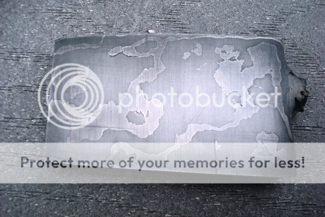

Then I forged it flat, and ground one side down to 400.
Then soaked it in ferric for 10 minutes. just a light etch to see what it looks like.

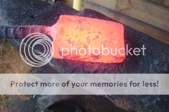

The billet, cut in half, restacked, and tig fused on the corners. Ready for forge welding.
hot, and fluxed.
Post welding.

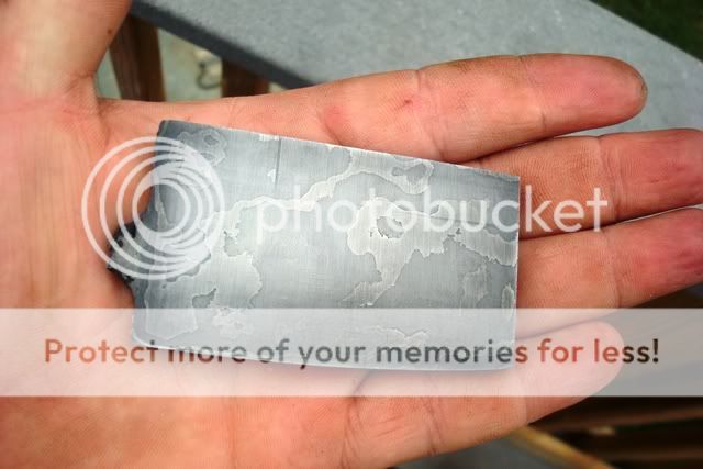

Beaten out some, ground flush, and rough ground to 120grit. Then put in for a short etch.
Edge view, hard to see, but you can make out the layers. There are a total of 32 layers in the billet now.
Billet in hand for size reference.

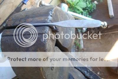

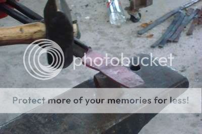

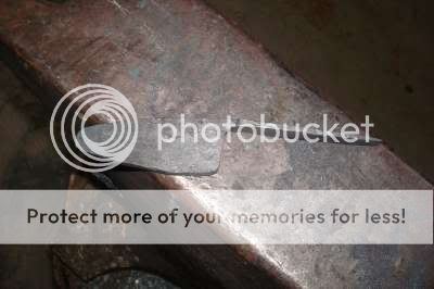

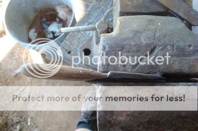

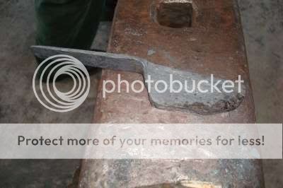

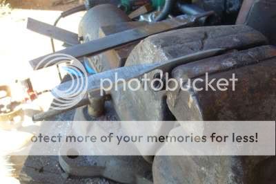

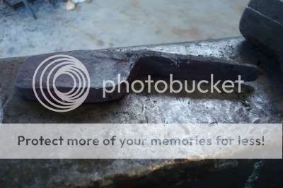

I started by forging down the tang, this is as far as I got it then.

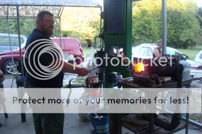

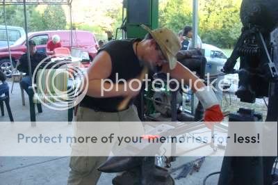

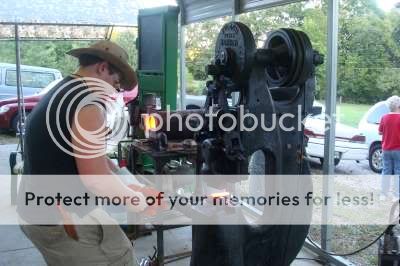

Then, I got a chance to work on it at Bowies Hammer-In yesterday (AND I GOT TO USE A PRESS AND POWER HAMMER!!!)

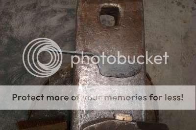

So I finished forgin out the tang first.
Keepin it hot, Bowies big ole propane forge is one hot thang.

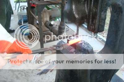

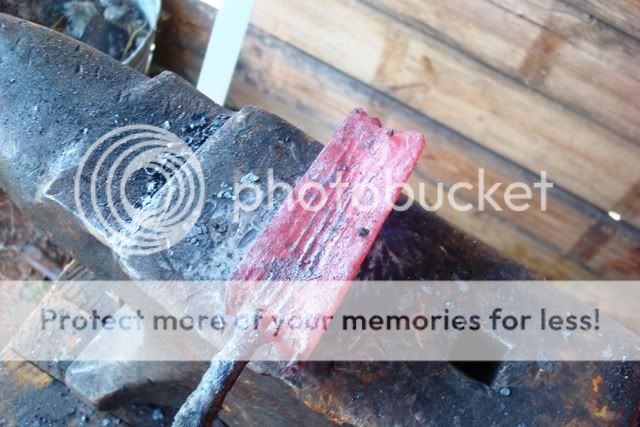

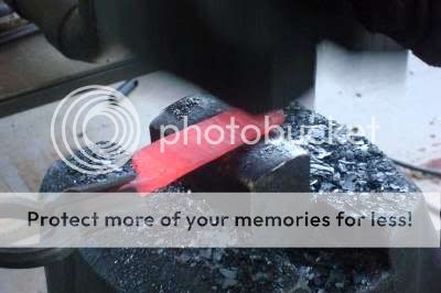

Then I started working on drawing out the blade. First I used the peen of the hammer to but in grooves.

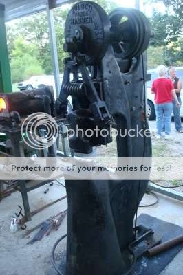

Then I took it over to the (25 TON!) press.
It's going.
Then Chris came over and started cooking some turkey sauseges, while telling me that I was a chicken not to use the power hammer.
Yeah, that hammer.

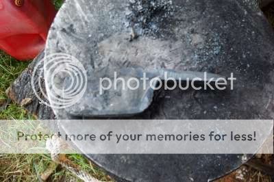

So, I started using it, man that thing is nice.

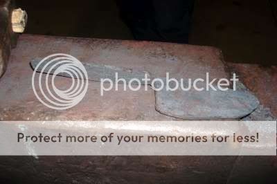

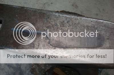

It got longer.

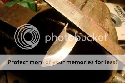

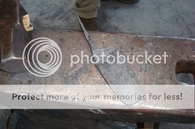

Cutting
Cut smaller, and profil began.

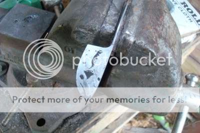

Then I used the grinder really quick to square up that finger area.
Then finished up the profile, straightened it all out, and turned the forge over to Bowie.

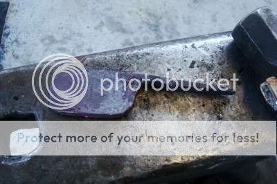

Okay, here it is so far.

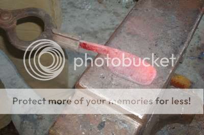

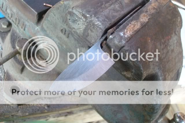

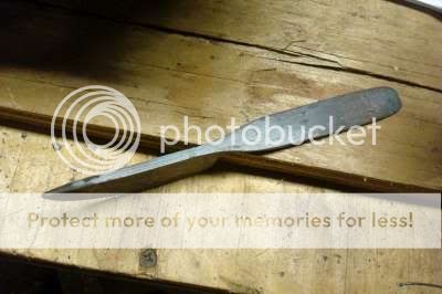

When I got home from bowies, I went ahead and forged some more, thinning the blade a bit and bringing down the bevels more.

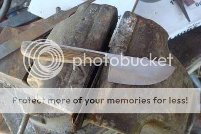

This is it finish forged

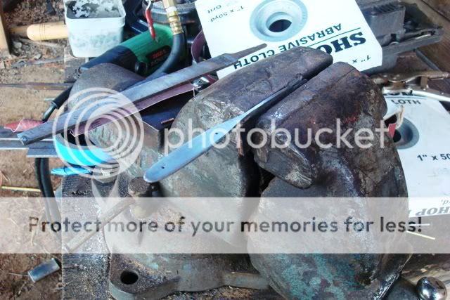

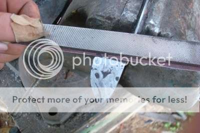

Some grinding, filing and sanding.

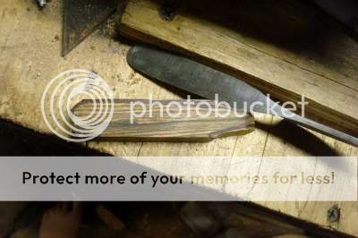

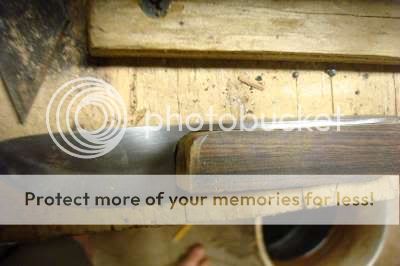

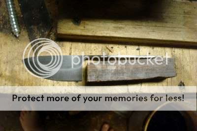

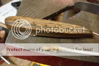

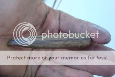

When that was finished I cut a bocote block for the handle, and started working it.
Block cut
Radius begun on the ginder
Worked closer with files and sandpaper
Radius finished; I marked the tang shape on the block, and cut the corners and such on my new old bandsaw (post about that coming soon)

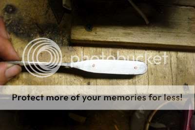

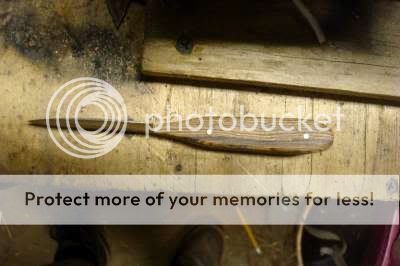

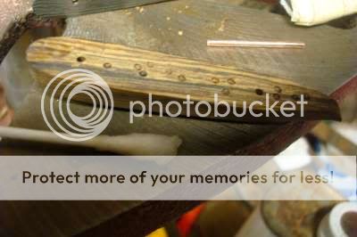

Then I drilled holes, and temporarily pinned it so I could shape it. Sorry, I forgot to take many pics, so the next one I have is of the handle almost all the way shaped. Skipped the whole drilling and pinning thing.
Sanding the shaped handle.
Then I drove out the pins, and removed the handle. Here's just the handle scale (or is it a block?)

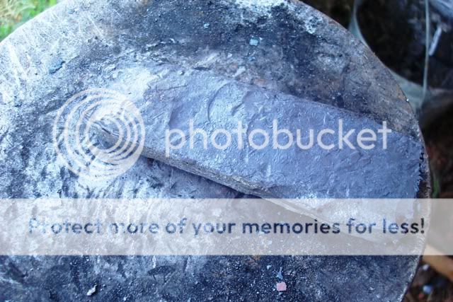

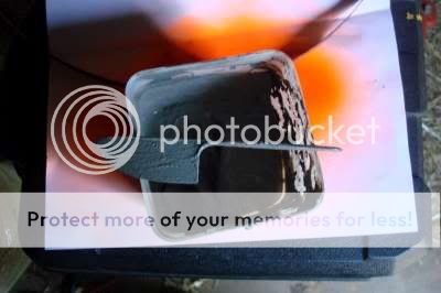

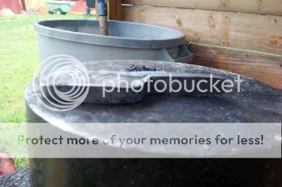

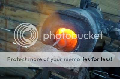

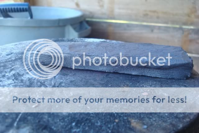

The blade coated with slip to minimize scale when HTing

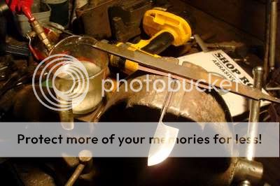

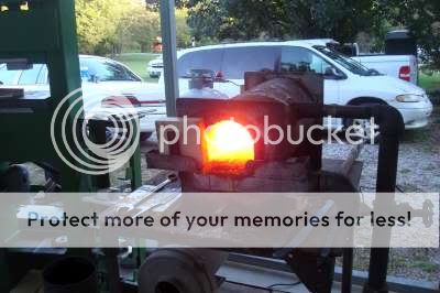

In the forge, I've got it in a muffle, running the forge fuel rich, and the blade coated with slip. I don't want to have to grind away to get past scale, my tang is thin right now, and can only get thinner.
Tempering now, next step is to handsand and etch the blade, then glue and pin the handle, then oil the handle.

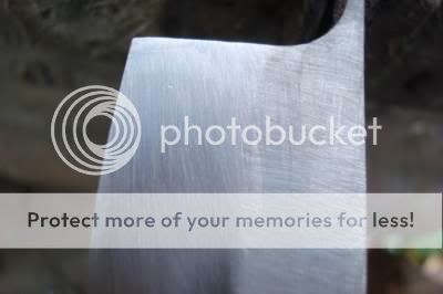

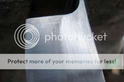

Okay, been getting some sanding in here and there.
First I got the knife down to 220 grit, I did that sunday night (that explains odd lighting)
Once I started on 220 grit, I started using a lube, usually I use oil, but this time I decided to try water with borax dissolved in.
And more sanding...
You'll notice I sand the flats in a different direction than the bevel, that helps me keep things smooth.
Still sanding...
now you can see the sanding is in different directions, I switch directions after every grit, that way I can see once the last grit is gone.

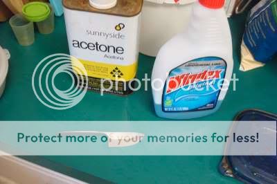

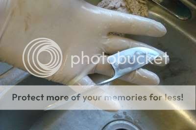

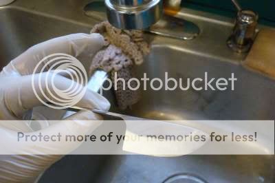

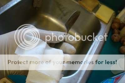

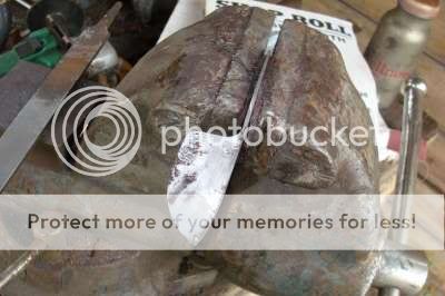

Now I'm ready to etch it, but first I'll clean off any oils or fingerprints. I use windex and then acetone.
I use latex gloves also, that way I don't put more prints on it. Spray it down with windex, and wash er' good.
Then wipe it down with an acetone on a papertowel (or rag).
Clean!

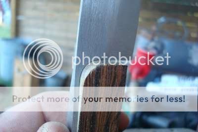

It's etched and ready for a handle, so I gave it just that.

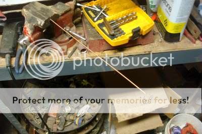

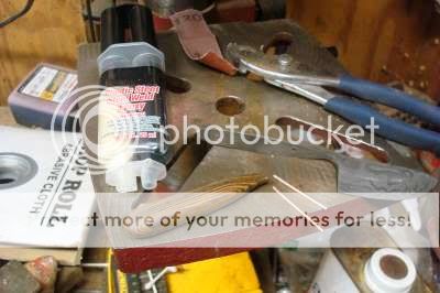

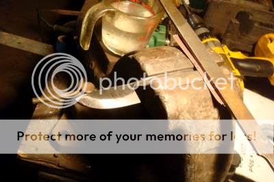

First I needed pins, I wanted copper, so I got some copper electrical wire, chucked it in a drill, tightened in a vise, and gave a good tight twist.
Now I've got the prepared pins, bocote, and the etched knife.

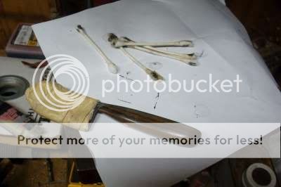

Whenever your working with bocote, keep the following in mind... Bocote is oily, so wipe it down with acetone before glueing it or finishing it, always always always! I made the mistake once of trying to tru oil it without the wipedown. Stayed gummy for a full day, and finally had to sand it back.
The bocote and the acetone soaked q-tip after wiping it down. You can see all the oils that came out of it.
Okay, sorry I skipped so much here, but my hands were sticky with epoxy and I couldn't pull out my camera.
Here is the knife, epoxyed handle, and peined copper pins.
And, to end it, a teaser. You'll get some pics of the whole thing soon....

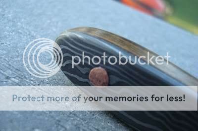

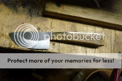

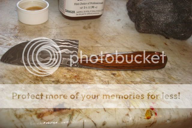

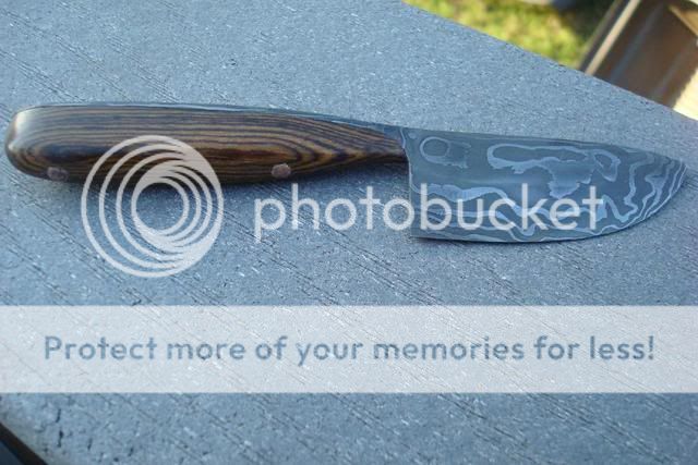

Here ya go, I got a whole pic for ya. I still need to finish the handle (tru-oil) and sharpen the blade. As well, I'm considering hitting the blade with a buffer some to see if that helps bring out the pattern. The other side doesn't show it as good as this. We'll see...

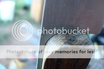

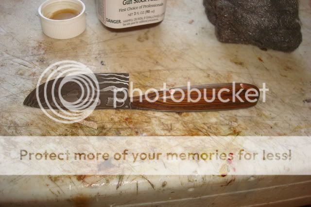

I've done some fine sanding with a hard sanding block, and used tru oil on the handle. I did of course, wipe down the handle with acetone before oiling.
Unoiled (and slightly blurry)
Oiled (cool how that oil brings it into focus isn't it)
I'll rub down the handle with pastewax, and take good photos of it as sson as possible, Then, it'll be off to the new owner.
That is the first time I've seen a tang and handle set-up like that. I like it! Great job on the knife too.
-Adam
Way cool! How's that handle feel in hand? Looks like the hand might want to creep forward into the blade? Looks like you got it pretty close to your initial idea/drawing. What are the final dimensions? Well done!
