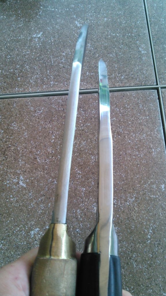

I recently got a Kumar BDC and a KLVUK. I didn't measure the thickness, and the knife is currently getting a BLO bath, but I did break out the scale. The BDC is 12" 16oz, and the KLVUK is 15", 17oz. Here's a pic comparing the spines; the BDC is the thicker one.
One of the few overhead views of a Villager and greatly appreciated....plenteous stout and i might suggest you mix a little turpentine in with BLO for better penetration...the Finns formerly used a beeswax/BLO/turpentine mix for stocks at least up through WWII and it works well for such....i hesitate to advise actual soaks as many folk might notice various oils wipe off glue overruns on blade ricasso and not something i wish going on inside handle, if'n yah know whut i mean, Vern?
