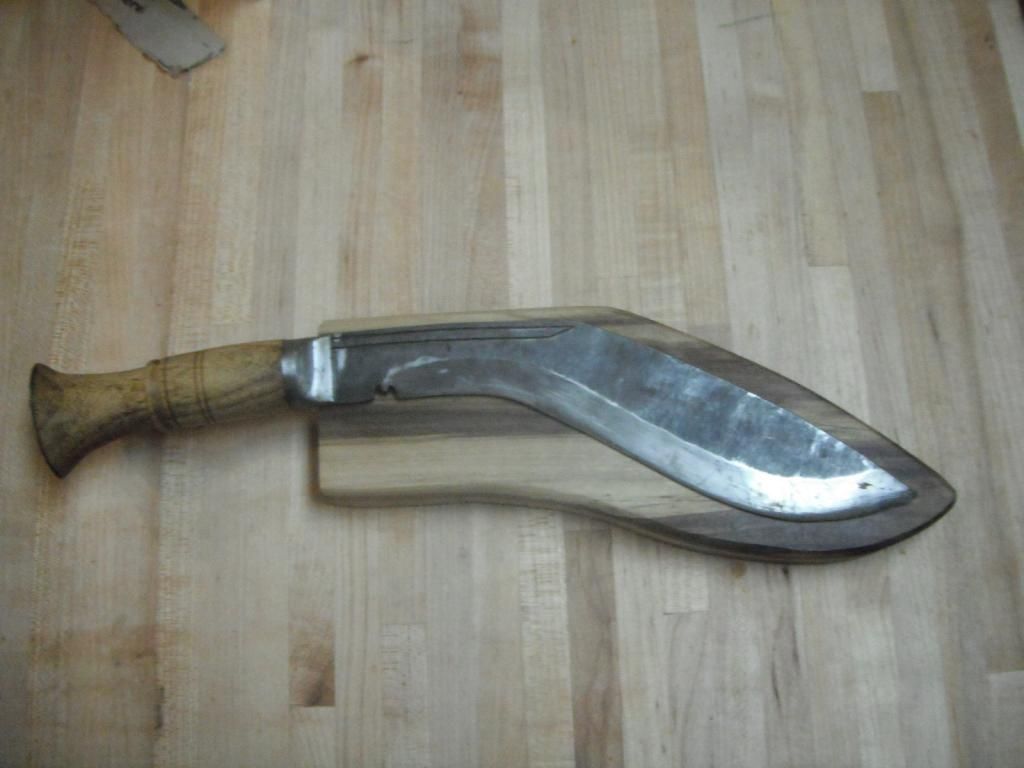

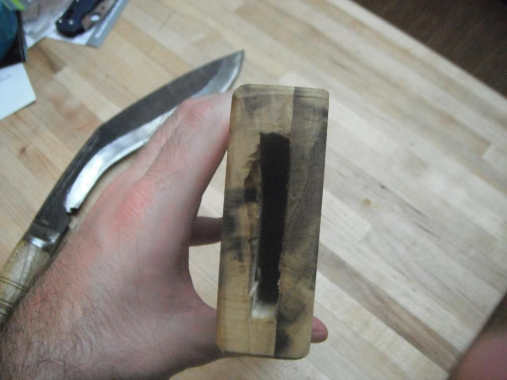

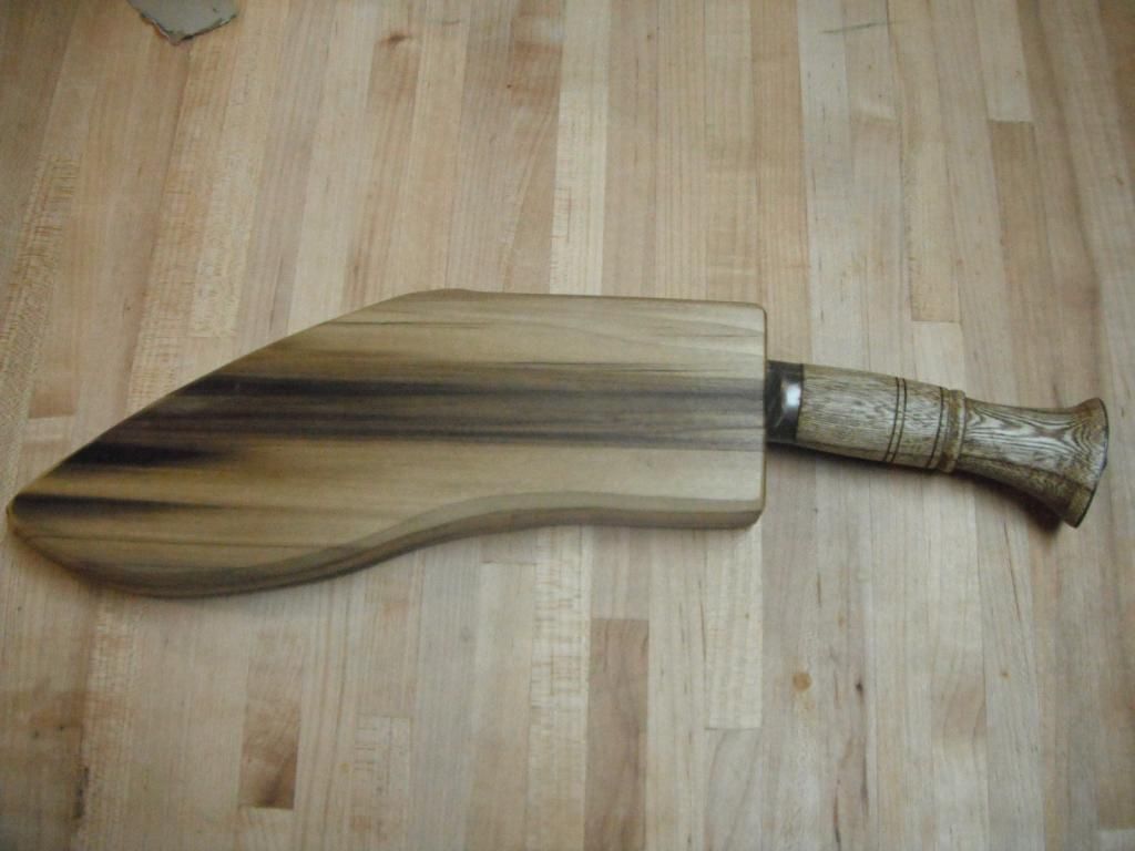

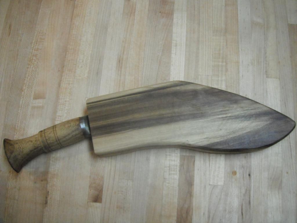

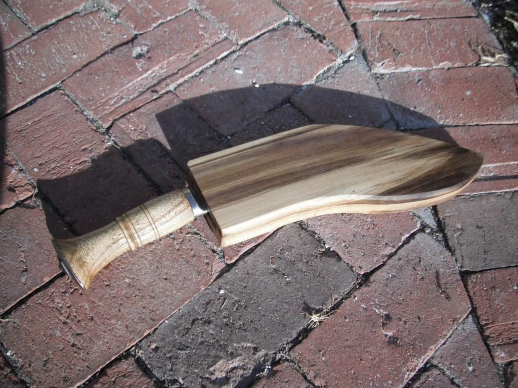

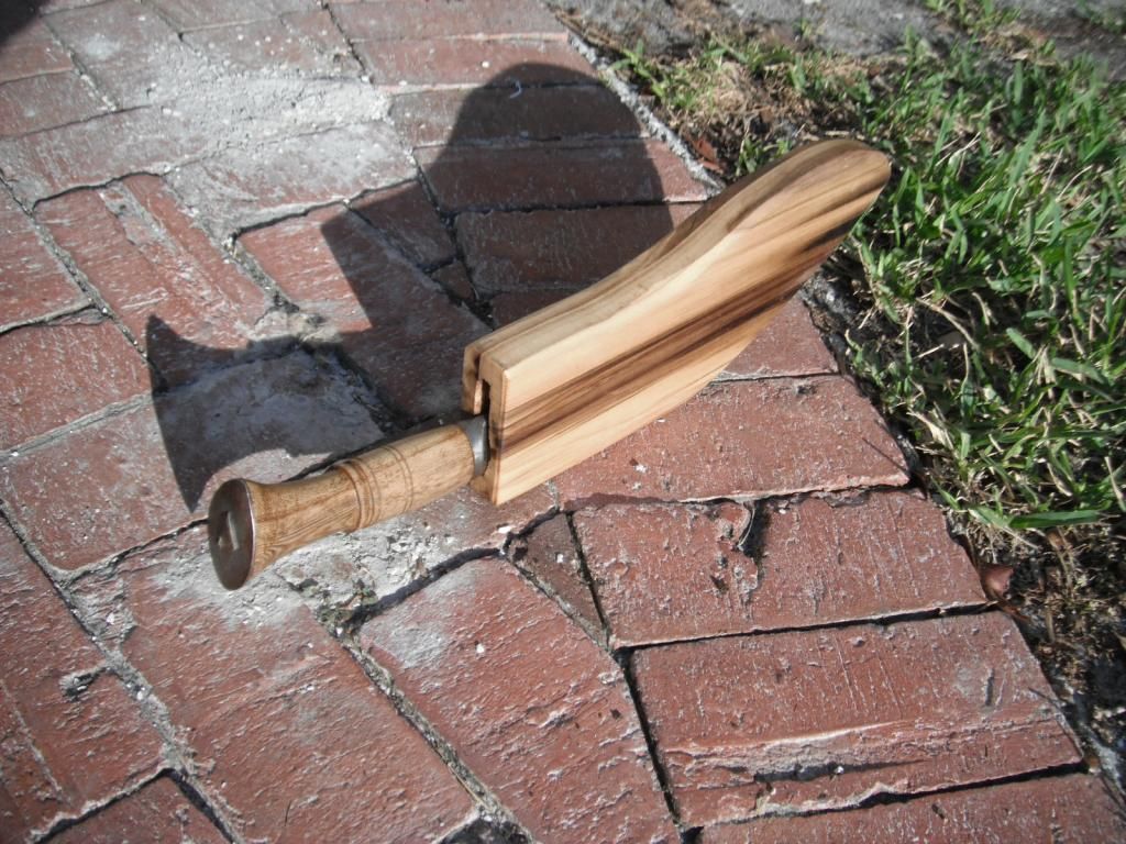

I have been working on a wood scabbard for my KLVUK. I used a board from the discount bin at the lumber store, which I think is poplar. I routed out a channel for the knife, and then glued the two halves together, trimmed the fat side down, and shaped on a belt & disc sander. I regret not taking any photos of the process, but here are a few of it semi-finished. Next step is to tack on a couple of leather carry straps.

I figured out where to mark the blade channel and some other hints from watching this video of some kamis in nepal: http://youtu.be/qol5Ey3sImQ?t=9m41s
Wow that's pretty. Nice looking piece of wood. I used an old piece of mahogany I had laying around. It works but not near as pretty as yours.
Dang dude, thats a fine job there. That wood looks great, nice grain to it. We have some serious skills here at HI. Great job man, very inspiring.

If you trace out the knife, then make sure the whole recess for the blade is wide enough for the belly you can trim the sheath to about 1/4" oversize after routing, especially if you're going to cover it with leather.
I like the router scabbards because there's wood between the edge and the leather-makes the "hold the sheath only by the back when drawing" business less necessary.
Philllll that is Awesome!!! forget about cutting it down to make it smaller. If you used plain mineral oil to seal it, you could use it as a cutting board as well as a sheath. Looks great.
