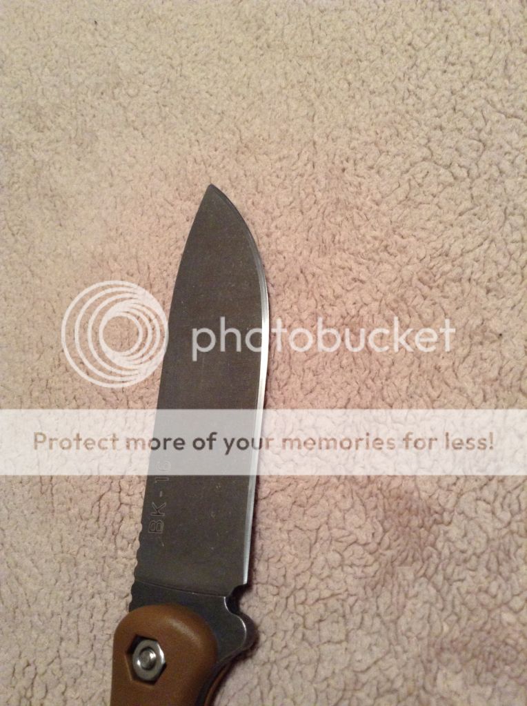

Thanks for the feedback guys i will take your advice and experiment a bit. I have a habit of micro beveling already developed so I will stick with that for now. I did get a chance to work on my bk16 with the kme. Set a 17 deg (34 inclusive) back bevel and a 22 deg(44 inclusive)micro bevel. It is sharp as Shiite! When I was screwing around whittling a hair from my wife's brush I looked away briefly and nicked my finger! I am super impressed with the kme so far. Plan on working on the bk14 tomorrow if I have time! Here is a crappy pic of the bk16 after the work on the kme:
