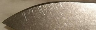

I've been having an issue lately when sharpening some of my knives. These are all just user knives, nothing special but I'd like to figure out what's causing it.
I'm getting very fine scratches along my sharpening pattern, sometimes up to .25" up the blade from the edge.
Any idea what causes that?
I figured it was the sharpening dust (blade material or diamond mater from the stones) causing the scratches but I don't see how or why they are causing the scratches that far up the blade away from the edge.

If you zoom in, you can see some of the scratches I'm talking about.
Hopefully they are more visible here. They are the vertical lines circled. Very fine scratches north of the edge. They were not there prior to me sharpening. I have sharpened other knives with no issues so it has to be related to something I did here. I did re-profile more here than I normally do.
Here they are. I had to get the lighting just right and camera at the right angle.
What stone and how old was the stone?
Most new stones will do this until broke in, I've seen it the worse with the 50 grit. Don't let anything build up on the blade, clean up the metal and diamonds as often as possible to avoid dragging along the blade. Careful using the blades you really care about in the beginning. That's my experience so far. Once they break in, you don't see it as much but I still try to avoid to much build up. But once they break in, they're not as aggressive. I've seen in the beginning, they cut really fast but you have the potential for those scratch's. But over time they're more mellow and take more time to re-profile. I'm only at a little over three months, so it's pretty fresh for myself, the learning and breaking in experience.

It was mainly with the 50 grit and I was taking quite a bit of material off. I wasn't keeping it clean or even attempting to. I figured it was due to all the dust on the blade while sharpening.
I'll have to try to be a bit more careful when taking a bunch of material off.
Thanks!
Great stone, cuts fast but leaves diamonds in the beginning. Then it's slower but doesn't leave the diamonds as often. One of the few pitfalls of the KME with the blade sideways, it's easier to build up "swarf" which you don't want on diamonds but do want on chosera stones. I personally like the horizontal blade, you can see the progress.
Not really familiar with the KME and it's specific workings but is it possible you're letting the end of the stones go past the bevel? In other words, you're pushing or pulling the stone to far and the end edge is scratching the blade above the bevel. I had an old GATCO sharpener years ago and I would let the end of the stone run off the bevel. Scratched the hell out of a couple knives.

That's very possible. Combine that with all the diamond dust sitting on the blade and that would probably do it.

I had this exact issue with my KME when I first got it. I was running the edge of the stone past the bevel and scratching the blade. i'd be willing to bet that's what you're doing. I honestly didn't even feel it. Buy the guide rod stop and set it up so you can't do it anymore and all your headaches will be solved!
I'll keep an eye out for my blades also, make sure I don't see them. I still use the 50 quite a bit and especially with new knives. The 50 grit I really pay attention to build up on the blade. I do have the guide rod stop but never got the hang of using it. Maybe I'll give it a try again. Always trying to improve.

Make sure your clamp is on the flat portion of the blade. If the blade has no flat one side is going to be a different angle than the other and this may cause one side to get scratches over the other. My solution for this was to get an edge pro lol but others have no issues with it.
Also wear the stones in with cheaper knives before using them on the expensive knives. Maybe 8 knives or something. Don't use excessive force, let the diamond do the cutting not the force. You'll wear them out fast as I did this on one of my kme stones when I first got it.

Are the stones new? The scratches are likely from using newer diamond stones that have not been broken in. As you use the new diamond stones little diamond particles break off which are ultra hard and will scratch the blade if you aren’t aware to either blow them away or vaccum them up.
I recommend you put some water mixed with dish soap on your diamond stones. Not only will it make the action smoother when sharpening but it will capture the diamond dust particles and prevent them from scratching up the blade.
