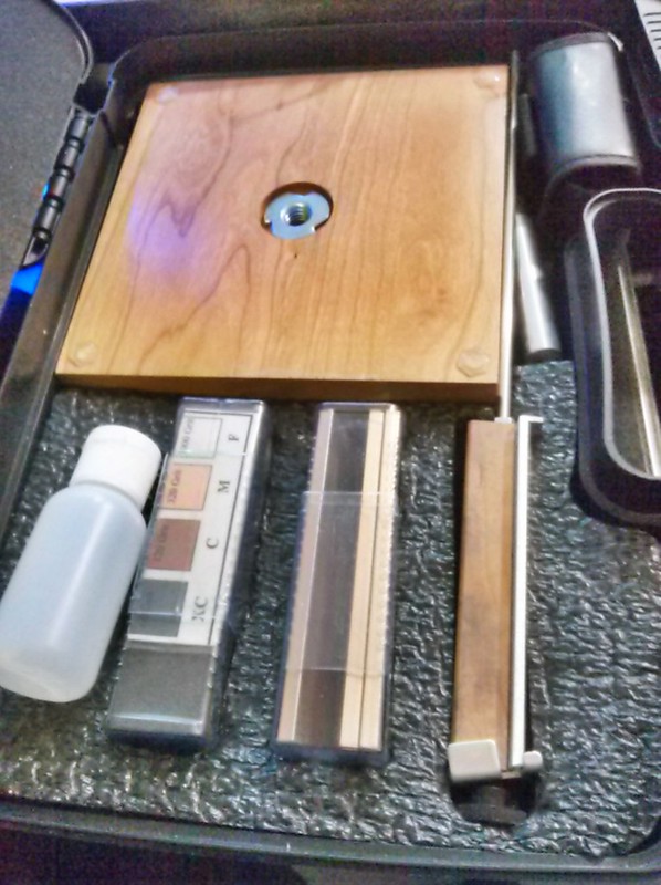

You do not need to disassemble the guide rod from the stone holder, to place the unit in the new factory case. It just fits!
The base also fits in the new box!

Keep better control of your stones and diamond sharpeners, and protect your investment, with a perfectly sized clear box to keep them in.........
I can't for the life of me find a source for those little telescopic plastic tubes (without buying several hundred...), they look perfect. Does anyone have any ideas?
