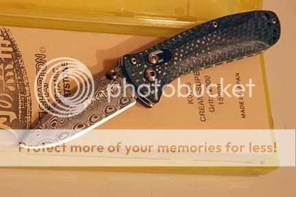

Combination of all three for me. Freehand though...here's the results on my EDC blade:
Once I start my stroke on the flat part of the edge (no belly), my angle pretty much "locks in." To go into the curve from there, I push forward on the tip area with my index finger and then kind of lift my elbow upward/outward to "lift the handle" in order to follow the curve.
My method isn't perfect, and I'm constantly trying to improve it. It's probably the hardest part of sharpening a knife.

Nice looking edge on the folder !
