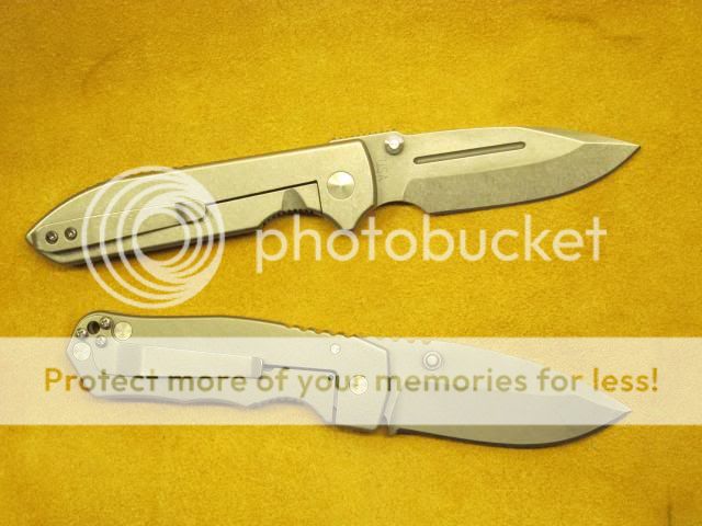

I couldn't wait to get the TAD Dauntless. What a great knife! Here it is (at the top) with a Grayman DUA.
Unfortunately, the TAD's choil is large, in order to fit the index finger. I unwrapped the knife and took it to the garage to test its edge on a cardboard box. I "stabbed" the box and then attempted to drag the blade downward in a cutting motion. I was surprised that the blade was completely stuck. I had plunged the blade in all the way to the grip. The choil is NOT sharp, so that it could not easily be withdrawn from the box.
I sold that knife rather quickly after that mishap.
