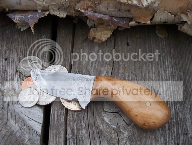

Your question crossed my mind also. What my pea sized brain came up with is that MAYBE if I want to shorten the handle I can compensate in some other area. Specifically make it wider, more bulbous and round so that you are grabbing something like a golf ball. See the photo below.
I know you can't see how wide the handle is. It's are about as wide as a normal knife, but when it is on such a short handle it looks sorta funny. But you can compensate only so far. You can't get as firm of grasp as you can with a longer handle. Surface area and friction are less with a smaller handle.
Good luck. I hope we can see what you come up with.

i've made a couple mini-skinner type knives like that too. i do like them alright, but i think some others like them more.
